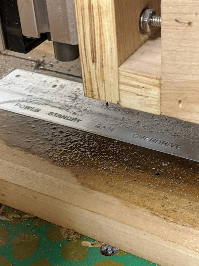

I v-carved it on my DIY CNC router and filled the letters. Here's an example...
Same with the back....
