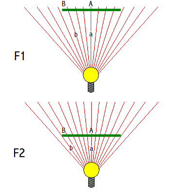

Lets go to the diagram.
Givens:
- green things are collimating fresnel lenses
- fresnel lenses are 12” across (ok, so they are not to scale – sue me…)
- fresnel in F1 is 12” from the light source
- fresnel in F2 is 6” from the light source
Based upon these numbers, a little trig reveals that:
- Angle of ray F1b relative to fresnel F1 is 64 degrees
- Angle of ray F2b relative to fresnel F2 is 45 degrees
- And, obviously enough, rays F1a and F2a are at right angles to their respective lenses
So now lets determine the ratio of light that drops of from then center to the edge of the lens in both F1 and F2:
For F1 - (sin 90) / (sin 64) = 1.11
For F2 - (sin 90) / (sin 45) = 1.41
As expected lens F2 is 1.4 times brighter in the center than at the edge whereas F1 is only 1.1 times brighter in the center than at the edge. Remember, all this is due to the fact that when the lens is closer to the light source the rays strike the outer edges at greater angles of declination.
Givens:
From these givens we can determine F1B and F2B distance from the light source. Since I don’t feel like typing out the trig equations here are some numbers you are just going to have to trust:
- distance from light source to F1B is 8.5”
- distance from light source to F2B is 13”
So what does this mean? Well nothing until we plug them into our aforementioned little light intensity question. Since we are looking for a ratio here I am just simply going to assign k the arbitrary value of 1 (the number makes no difference here, believe me….):
For lens F1 - (1/122) / (1/132) = 1.17
For lens F2 - (1/62) / (1/8.52) = 2.01
Well…. what we see from these numbers is just what was expected. When the lens is 12” from the light source the center (F1A) receives 1.17 times more light than the edge (F1B). However, here is the real kicker - when the lens is 6” from the light source the center (F2A) receives more than twice as much light than the edge (F2B). Talk about un-even lighting! So what is the equation for determining this “difference ratio”? It’s late and I need to finish up so maybe if I have time later I’ll calculate it.
All right, I need to hit the sack so I’ll conclude by saying that when we combine these two factors we find that (in our above given examples) the final difference ratio between the two is quite large. Lets calculate the combined effect:
F1 – 1.17 * 1.11 = 1.30
F2 – 2.01* 1.41 = 2.83
When combined we see that F1 is 1.3 times brighter in the center than on its edge where as F2 is a WHOPPING 2.8 times brighter in its center than on its edge….
In conclusion (finally), moving the collimating lens further from the light source causes the amount of light entering it to fall off as the square of distance BUT we can also expect the “evenness” of light distribution into collimating fresnel (and ultimately the LCD) to INCREASE in a manner approximating a squared relationship relative to distance (I could calculate the exact equation but I am just too tired right now).
So what’s the lesson? There must be a happy medium somewhere…
