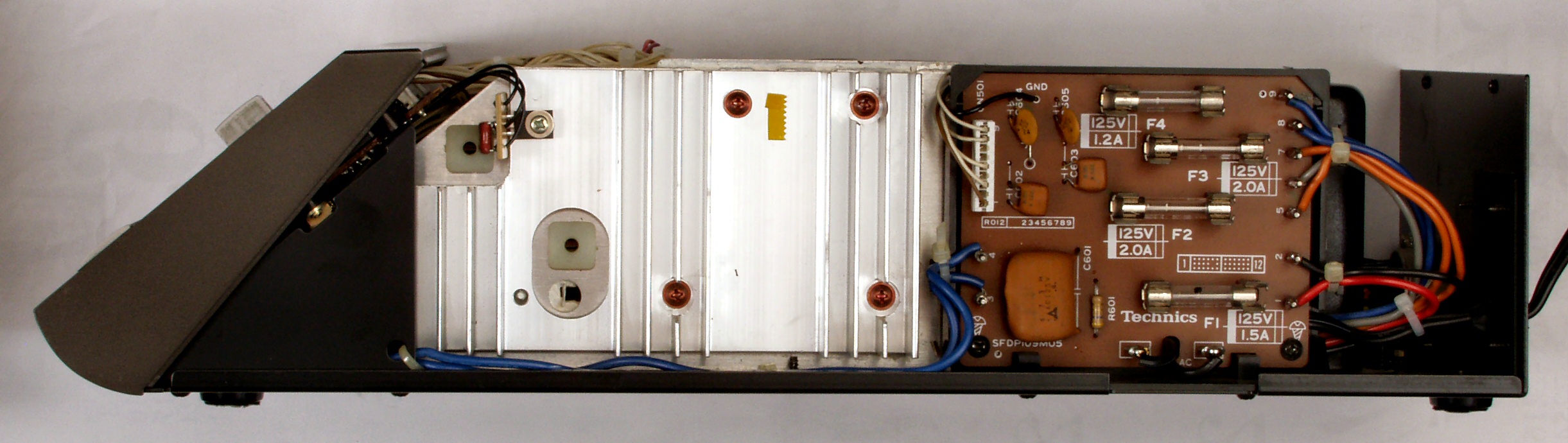

I was going through the posts on sp-10.jp and found some text that said later production units came with Q260 attached to the heatsink, and also mentioned oscillation problems when doing so which I assume is the problem I ran in to.
This pic shows a small PCB on the transistor, with a film cap across what looks to be the collector and base. What value would be appropriate for this?
They also mentioned that they began replacing all mylar caps as the originals were noisy. I wonder if there's any merit to this?
Well, it's a simple emitter follower voltage step down, so 100n should be fine. If I had designed it would be from base to emitter, but either way is OK.

They may have done - I can't find a picture where I can see the traces. I'll try again when I change VR101.

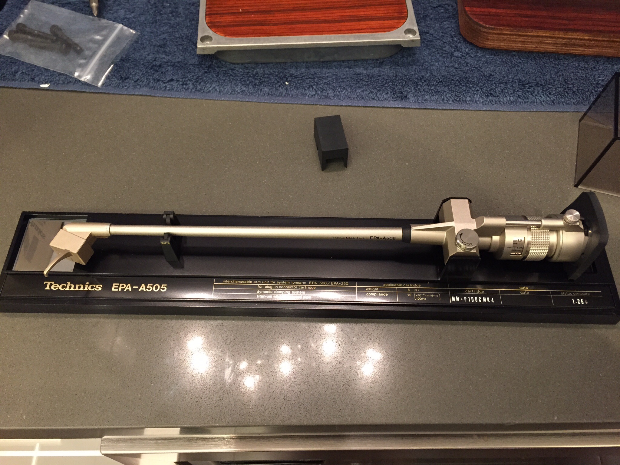

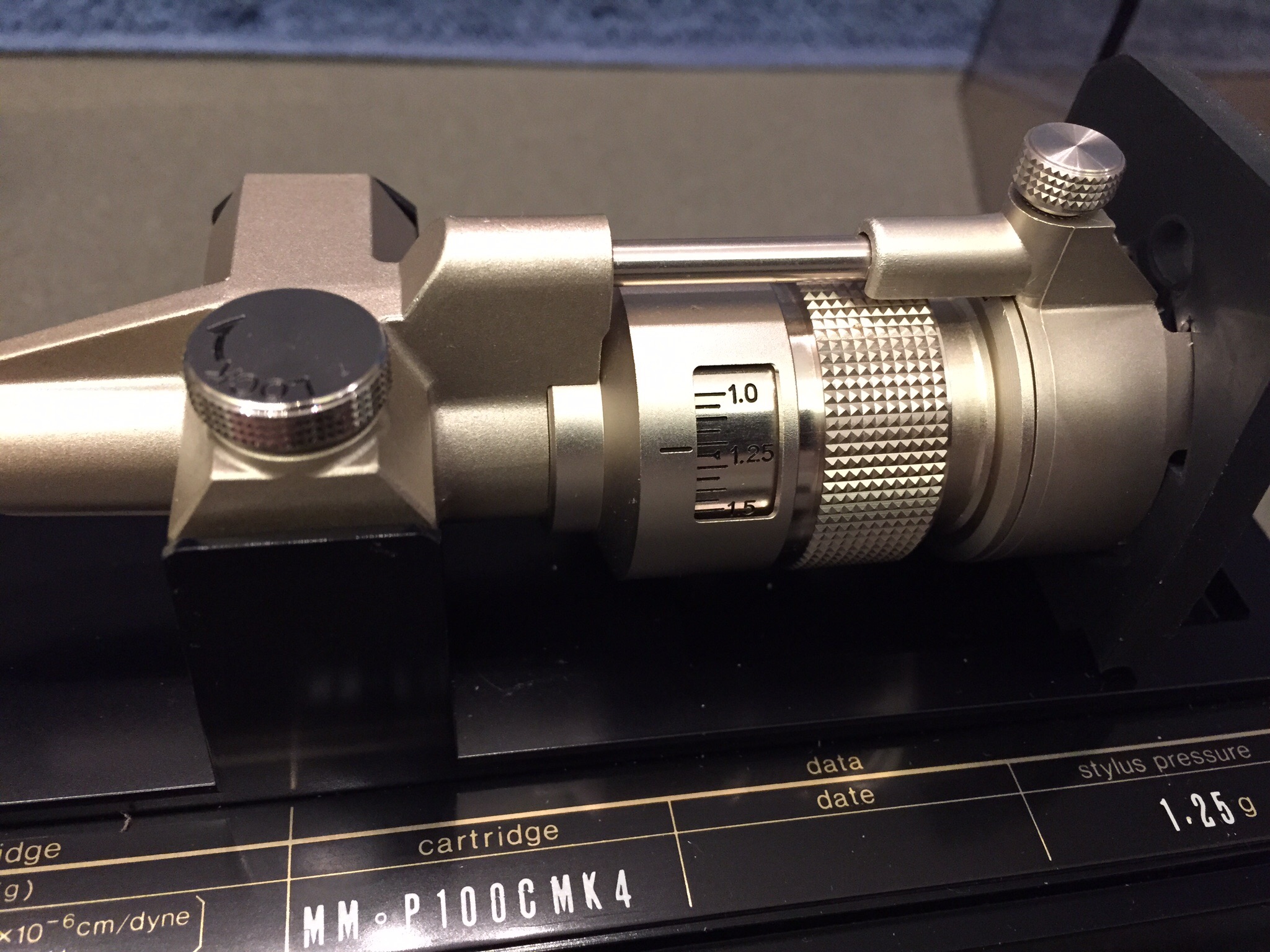

That's the EPA-A505. Not much info out there on it, but my understanding is that it was Japan only. The plastic case has all the info for the P100CMK4 pre-populated, so my guess is it was bundled.
Came across it one late night a few weeks ago on agon of all places. Never thought I'd find one. I think most folks believe it doesn't really exist.

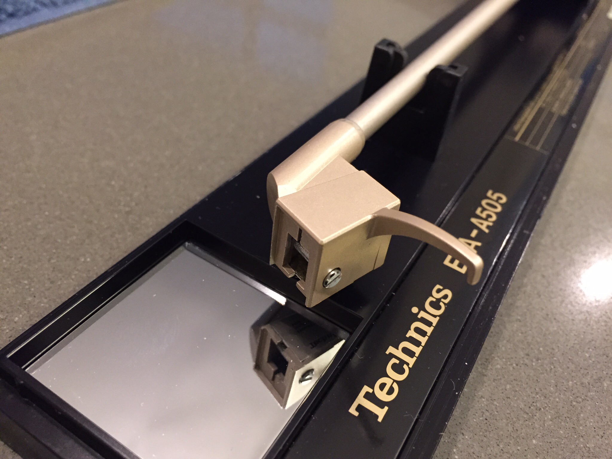

The counterweight, etc., looks like an EPA-100. The arm tube like a normal EPA-500, and headshell like nothing I've seen. How is the cartridge attached, or is that part of the assembly? It looks like a screw from the headshell into the cartridge's side.
I know it is sorta OT, but how about some close-up pictures?
It's not off-topic at all. I would love to see some photos.
That said, that particular armwand (EPA-A505) is P-mount.

Most interesting. I've never seen any info about this wand. Though P-mount does put a damper on some of the fun.
The absolute state of the art, highest quality and most amazing materials Technics cartridges were made in P-mount. These had the lowest effective tip mass of any cartridge made, ever.
Think about it - a tapered tube, made of boron. With a Shibata at the tip.
lowest effective what? and which models? Those of us deprogrammed from 1980s flat earthism in UK want to know!
