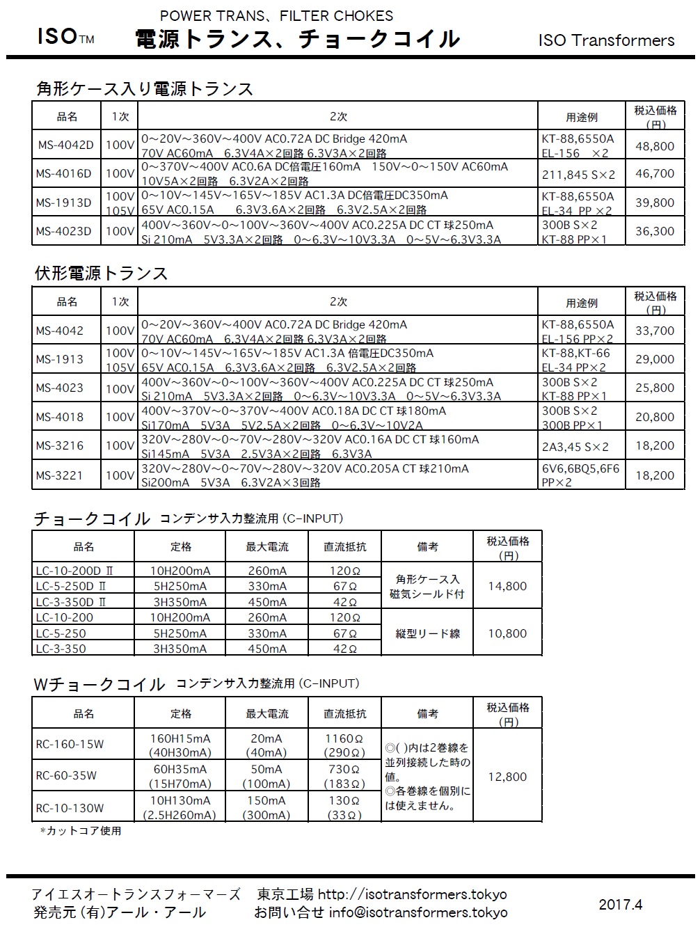

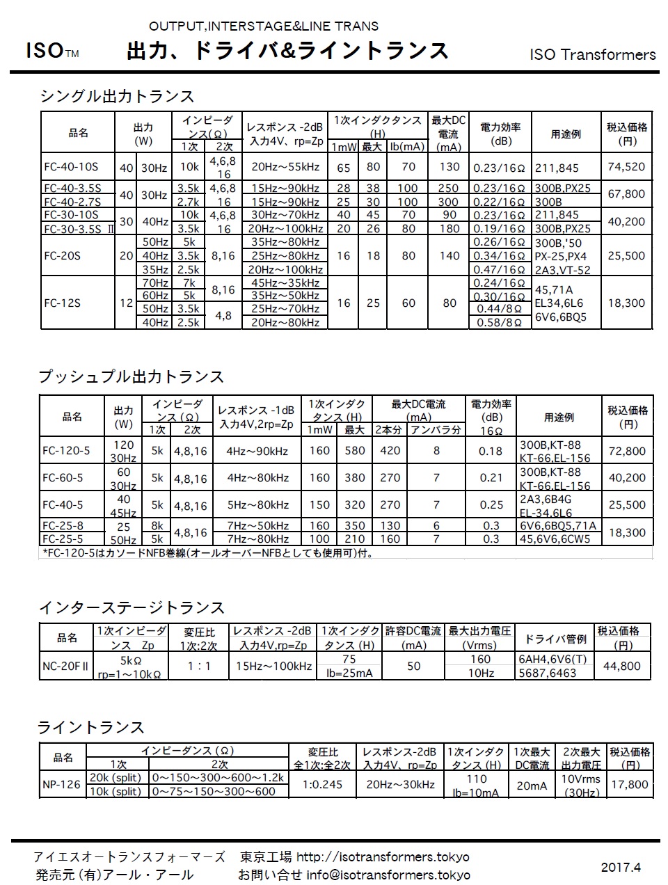

Here is the latest update of the products

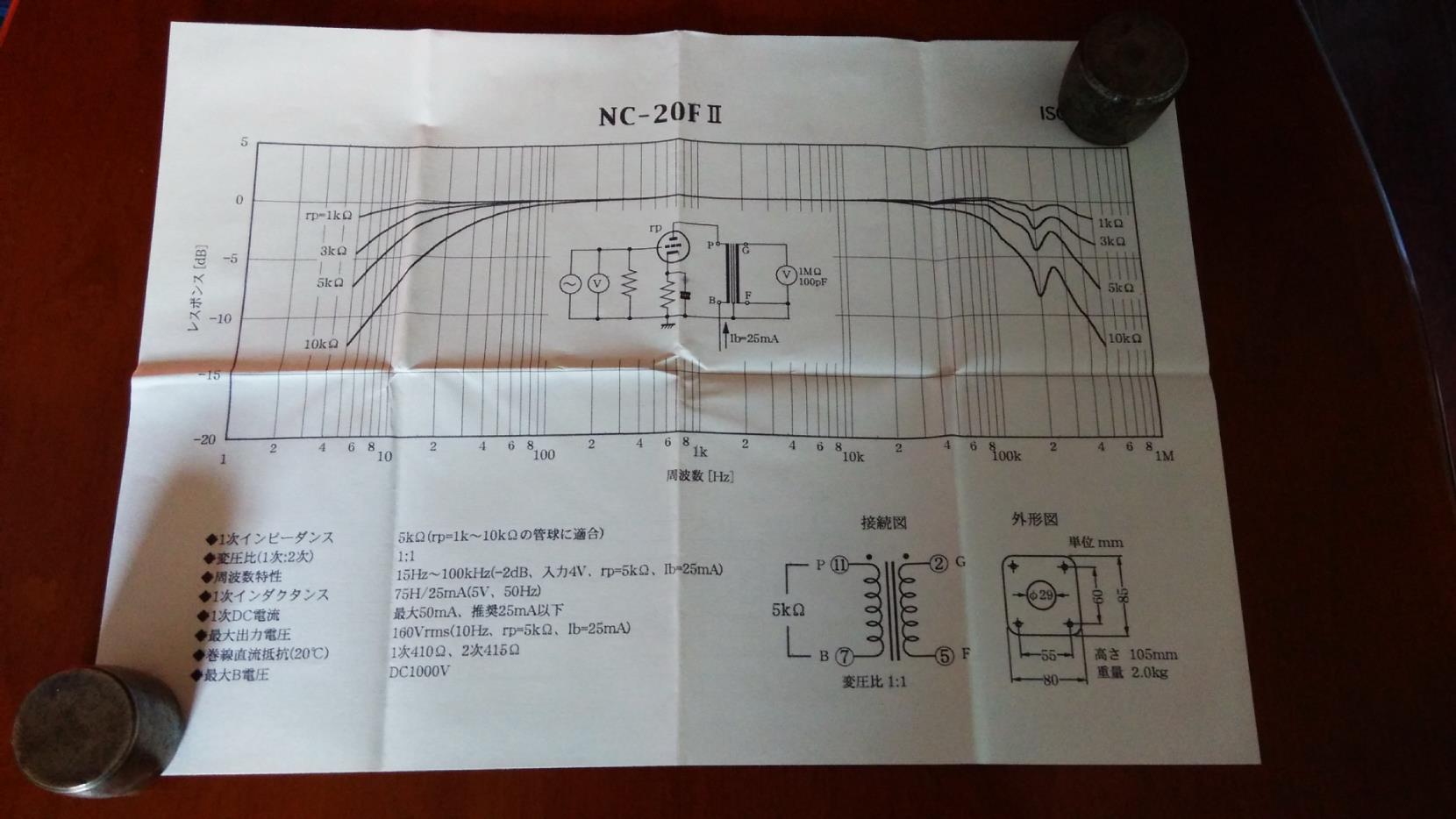

You can see the specs and the price.I think the most important improve is the interstage trans NC-20F II.You can see the freq response is 15-100K and the max current is 50ma,the old model is 15-80K with 30ma max current.New FC-40-2.7S with 15-90K freq response and the old model is 15-80K.

The price of my order is almost $1700 for a pair of output trans,$1000 for interstage and $500 for choke.The price include the shipping and custom fee.

As a matter of fact I will be getting my new Tango Interstages NC20F II within the hour (I think the very first in the Netherlands 😀) handcarried by the shopkeeper my friend and audiobuddy.
I have built a clone Ungaku with standard try out interstages (did not make my mind up yet)...so no real magic yet.
I hope I will be in for a surprise.
I'm using the old ISO company (I wish they changed the name for the third company, it would make it easier to distinguish) NC20, if these new transformers are similar you will love them
