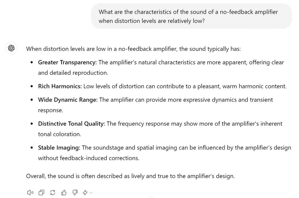

So why did I ultimately choose to challenge myself with the “hell-level” difficulty of a no-feedback amplifier? There’s a small story here. I had a friend who was an audiophile. He once told me that he had listened to amplifiers without global feedback and found the sound more natural, lively, and impactful. He asked if I could build a fully no-feedback amplifier for him to try. At the time, I just smiled and didn’t give it much thought. But his words planted a seed in my mind, which eventually led me to make this decision and explore the mystery myself.
In fact, I wasn’t sure what a no-feedback amplifier would sound like either, or if it would really be as natural and lively as ChatGPT suggested. But debates in technology often have their complexities. Feedback indeed brings many benefits but can also introduce issues like transient intermodulation distortion and dynamic errors caused by feedback delay. Could these distortions negatively affect subjective listening? Perhaps building a no-feedback amplifier with excellent parameters is the best way to answer these questions.
This is the story and motivation behind my DIY no-feedback amplifier, as well as my views on audio technology and subjective evaluation. In the upcoming posts, I’ll share why I chose Class D as the main architecture, and the challenges and results I encountered during simulation, production, and debugging. This DIY journey took four years, and some details may have faded from memory, but I’ll try to consider readers of all backgrounds, using analogies and simplified technical details to help everyone understand. I hope my sharing will bring you some inspiration.

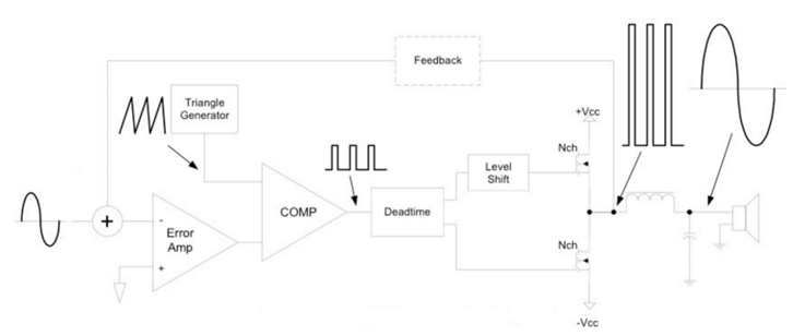

At that time, there were also many high-performance Class D amplifiers on the market. These products significantly reduced distortion by incorporating audio feedback techniques specifically designed for Class D amplifiers. It must be acknowledged that feedback is indeed an effective means of reducing static distortion. Figure 2 shows a basic schematic of a Class D amplifier with audio feedback.

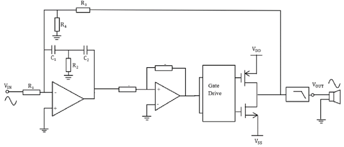

Figure 2, An Example of Analog Class D Amplifier with audio negative feedback
(from ‘Comprehensive Study of Class D Amplifier Technology’ by Todd P.Marco)

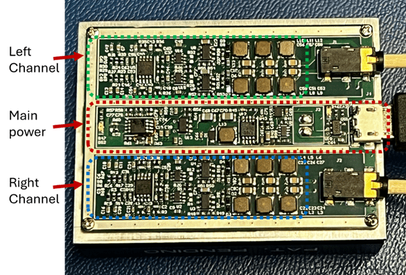

Next comes the overall design scheme for the Class D amplifier. For clarity, I will list the carefully considered overall scheme and choices in the table below, with explanations for the different technical choices to be provided during subsequent simulation and debugging. In fact, these schemes were not determined from the beginning but were gradually refined through simulation, construction, and debugging.
I chose to design a headphone amplifier due to its relatively low output power, allowing for the use of smaller power MOSFETs. Typically, small power MOSFETs have lower gate capacitance and can operate at higher frequencies. This increase in frequency not only significantly reduces the amplifier's distortion but also simplifies the design of the output filter. Additionally, a higher cutoff frequency means that variations in the filter's Q factor have a minimal impact on the amplifier’s frequency response when connecting headphones with different impedances.

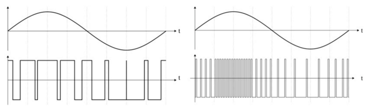

Certainly, Class D amplifiers come in many variations. The two main types are fixed-frequency (PWM modulation, shown in Figure 3(a)) and self-oscillating Class D (PDM modulation, shown in Figure 3(b)) amplifiers. Additionally, there are two main designs for the output stage: half-bridge (shown in Figure 4(a)) and full-bridge (shown in Figure 4(b)). Within the full-bridge design, there are further distinctions, such as AD modulation and BD modulation.
(a) (b)
Figure 3, PWM waveform (a) and PDM waveform (b) of class D amplifier
Next, I will share some key ideas of circuit design ideas and overall simulation results, as well as discuss specific measures for reducing distortion. Stay tuned.

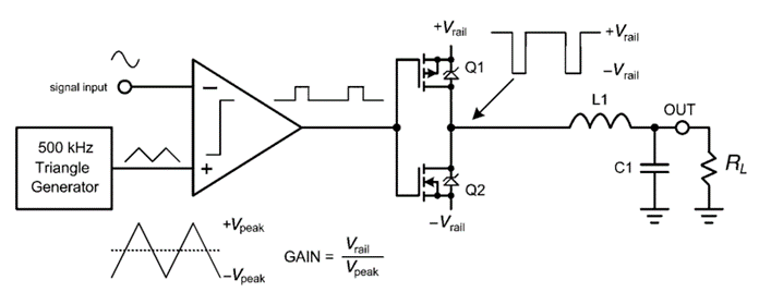

You could probably simplify life just a little by starting with just a single switch. A half-bridge optimizes power (etc.) and a full-bridge optimizes things even more, but they both present unique challenges like deadtime to prevent shoot-through, to name one. Don't get bogged down.
If you were me (and for whatever reason I was set on class-D), I would start with the basics: a nice triangle wave, a nice constant current source and LPF to charge linearly. In addition, I would try to find ways to test the "lower" limits. Can I use a 40kHz oscillator? What do I need to improve to make it sound good? First make a PC speaker sound like a Soundblaster, then ramp up the frequency.
Thank you for the great suggestion, much appreciated!

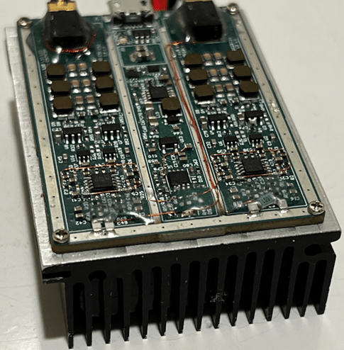

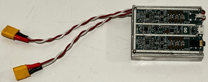

The entire DIY project has been completed after about a four-year journey. Now, I’m in the process of revisiting everything, documenting it, and sharing the experience.
Of course, I will continue to refine and improve the design as I receive more valuable suggestions or ideas.

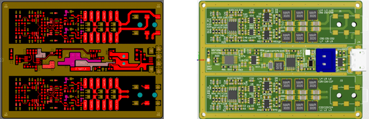

After finalizing the overall design, simulations are used to select specific components and determine resistor and capacitor values, followed by circuit board manufacturing for validation and iteration to achieve the initial design goals.

The second important aspect is the selection of the output stage, where the industry has reached a consensus: when cost requirements are not stringent, a full-bridge configuration is typically used. The advantages of the full-bridge mode include the ability to partially cancel even-order harmonics and suppress the back current of the output filter inductor, effectively reducing the power supply fluctuations in the output stage. This is particularly beneficial for Class D amplifiers with poor power supply rejection ratio (PSRR).
The output filter is also critical, especially for Class D amplifiers using PDM modulation. Since this design uses a modulation frequency above 2 MHz, there is more flexibility in choosing the low-pass filter’s cutoff frequency. This brings significant benefits: first, a higher cutoff frequency can be chosen, so the frequency response changes with different loads won't significantly impact the amplifier’s effective bandwidth. Second, since smaller inductors are used, they provide better linearity at the same size, reducing the distortion impact on the amplifier. During simulation, it was also observed that a multi-order output filter could reduce in-band noise, although there is no theoretical explanation for this yet. I welcome any interested parties to discuss this further.

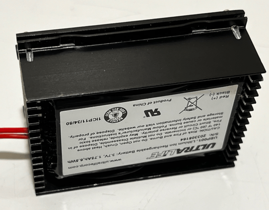

The power supply solution is equally important. This design uses a single 3000mAh lithium battery, so a step-up boost converter is required. A major issue is that the amplifier operates at over 2 MHz, which is much higher than the frequency of commonly available boost converters. During a single PWM cycle, the supply voltage may drop due to the amplifier’s high current draw, which even the best boost chips struggle to handle in such cases.
After multiple experiments, both the pre-amp and output stages ended up using a two-stage single power supply solution. The pre-amp power (for the integrator and comparator) uses a combination of a boost circuit and a Class A power supply. The Class A supply uses a high-precision reference regulator with voltage accuracy of 0.1% and power supply noise as low as a few microvolts. Additionally, the midpoint reference voltage uses the same precision reference chip, not only improving voltage accuracy but also ensuring the integrator circuit operates symmetrically, optimizing open-loop performance.
Originally, I planned to use the same design for the output stage power supply, but due to the need to drive headphones with varying impedance and sensitivity, the Class A power supply’s efficiency was too low, which affected battery life. In the end, I chose a step-up circuit combined with a high-precision, high-current LDO and large capacitors for the output stage.
Interestingly, switching from a Class A supply to an LDO + large capacitors for the output stage resulted in virtually no subjective change in sound quality. However, changing the pre-amp from an LDO to a Class A power supply led to a significant improvement in sound. The high frequencies became more transparent, the low frequencies were stronger and more extended, and the soundstage was more stable. This change was quite noticeable, without the need for careful listening. Could this be due to the higher precision in both supply and bias voltages? I would love to hear thoughts from those interested in discussing this. The first version of the pre-amp, which was discarded, used a voltage divider for the bias reference, as shown in Figure 4, with resistor accuracy of 0.1%.
Figure 4, Circuit for Generating the Bias Voltage in the Integrator
There are many other crucial details in the amplifier design and debugging process that cannot be overlooked, and I will discuss them further in appropriate contexts.

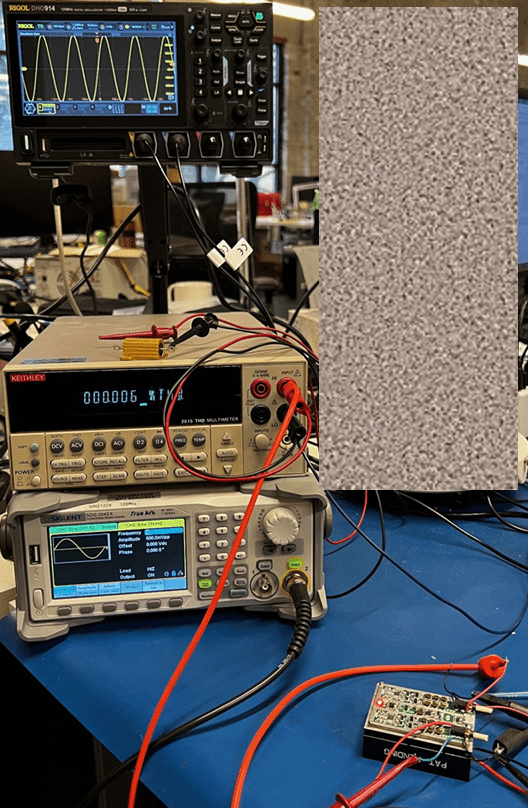

Figure 5 shows the Spice simulation results for the background noise. Within an effective bandwidth of 35 kHz, the highest background noise is as low as -170 dBV, with the low-frequency section reaching nearly -180 dBV.
Figure 5,Zero Input Circuit Configuration (Background Noise) Simulation Results
Figure 6 shows the simulation results with a 1kHz input signal. No harmonic distortion related to the 1kHz frequency was observed. However, compared to the zero-input results in Figure 5, the background noise increased by about 10dB, reaching approximately -170dBV. This frequency-independent distortion is a typical occurrence in such circuits.
Figure 6, Single Sine Wave Input Circuit Configuration Simulation Results
Figure 7 presents the amplifier simulation results based on the previous discussions. The modulation frequency is around 2.3 MHz, with an input signal peak-to-peak value of about 196 mV and an output peak-to-peak value of around 4000 mV, resulting in an overall gain of approximately 26 dB. The input signal consists of three frequencies: 500 Hz, 5 kHz, and 20 kHz. The amplifier's background noise level is about -167 dBV, which is 3 dB higher than the -170 dBV observed in the 1 kHz sine wave test shown in Figure 6, likely due to frequency-independent distortion causing this noise floor increase.
During the simulation, it was observed that different multi-stage integrator network configurations affect the spectral characteristics of frequency-independent distortion. By adjusting the integrator network, it is possible to reduce low-frequency distortion at the cost of increasing high-frequency distortion. In this design, I chose to balance the frequency-independent distortion across the spectrum, leading to a flat noise floor.
In reality, there are other approaches. One could adjust the integrator network to minimize the total or weighted power of frequency-independent noise within the effective bandwidth, without prioritizing flatness. My choice for a flat noise floor was based on the fact that amplifiers typically exhibit more distortion in high frequencies compared to low frequencies, whether it is frequency-dependent or independent. A DIY amplifier with a flat noise floor might offer a different subjective listening experience.
Given the multi-frequency input, the amplifier's total distortion is primarily composed of harmonic and intermodulation distortion. The simulation results show that the highest harmonic distortion reaches about -156 dBV, with the minimum signal-to-harmonic ratio being 152 dB. These results demonstrate excellent noise suppression and distortion control, achieving the expected high-performance standards, at least based on the simulation outcomes.
Figure 7,Multi-Sine Wave Input Circuit Configuration Simulation Results
The following lists the different distortion frequencies and their amplitudes generated from the simulation, for reference by those interested:
For those who might not be familiar with these simulation figures and find them hard to interpret, it's worth noting that if you were to input a true 24-bit audio source into the amplifier, the output would be virtually undistorted. The harmonic distortion is more than 7 dB lower than the 24-bit quantization noise, making it effectively distortion-free.

Figure 3, Multistage Half-Bridge Sigma-Delta Modulator with Schmitt Trigger Mechanism

I have two questions about your figure 3, one technical and one semantic question.
The semantic question is whether it is usual to call this a sigma-delta modulator. I have only seen that term used for clocked circuits, while this is a completely continuous-time, self-oscillating circuit. Then again, I am more familiar with ADCs and DACs than with class-D amplifiers.
The technical question is how this fits in your no-feedback concept. You explained that you want to make an amplifier with no feedback at all and that that does not apply to supporting circuits such as power supplies, but in this figure, there is shunt feedback over the entire amplifier (output filter excluded). Will you later replace this with an open-loop equivalent?
Thank you for your questions.
Regarding the first point, I believe it is acceptable to call it a sigma-delta modulator.
As for the second point, the feedback resistor R3 is applied to the output pulse signal only, which is part of the self-oscillating circuit. However, for the audio signal path, the loop remains open.

Now, let’s take a look at the photos of the first version of the amplifier. Figure 1 shows the PCB layout design and a 3D rendering. This is a four-layer PCB design with a fully implemented ground plane. Not only does this improve electrical performance, but it also significantly enhances signal integrity and stability, ensuring the circuit operates reliably.
Figure 2 shows a physical photo of the first version of the amplifier, with the entire circuit board mounted on a heatsink, even though additional cooling is not necessary based on actual usage. To make full use of space, the interior of the heatsink has been hollowed out to accommodate a 1700mAh lithium battery, as shown in Figure 3.
Figure 2, Assembled and Tuned Circuit Board
Figure 3,Battery Placement
Figure 4 showcases the circuit board after several months of iterative tuning and modifications. The image clearly reveals numerous signs of adjustments and changes, reflecting the intensive debugging process that has truly tested my patience and attention to detail. My method involved using two identical circuit boards, labeled A and B. I first concentrated on improving and optimizing board A, then compared its performance with board B. If board A demonstrated superior results in both objective test data and subjective listening experiences, I would proceed to enhance board B accordingly. This cycle of comparison and improvement continued until board B’s performance ultimately surpassed that of board A. I repeated this process multiple times, halting only when further modifications yielded no significant gains.
I would like to express my heartfelt gratitude to several friends who patiently participated in the listening tests throughout the debugging process and offered invaluable subjective feedback. Their support has been instrumental in enabling me to integrate objective test data with subjective listening experiences, allowing for continual refinement and adjustment of the circuit design to reach a higher standard.
Figure 4, Modified Circuit Board

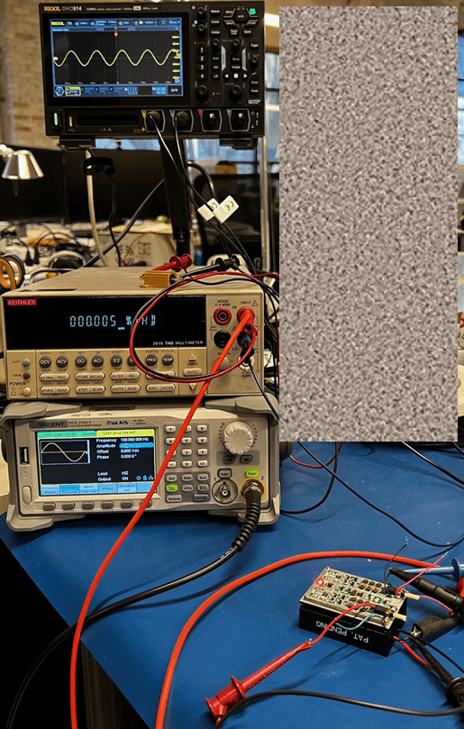

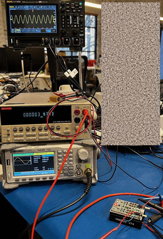

Now, let’s share some results from the Total Harmonic Distortion (THD) tests. I used the SIGLENT SDG2042X as the signal generator and the KEITHLEY 2015 THD MULTIMETER for measuring THD. Unfortunately, the THD of the sine wave directly output by the SDG2042X varies between approximately 0.001% and 0.006%, depending on the output amplitude and frequency, while the maximum measurement accuracy of the 2015 THD MULTIMETER is only 0.001%.
Figures 6, 7, and 8 display the THD test results at frequencies of 100Hz, 1kHz, and 10kHz, respectively, with corresponding THD values of 0.005%, 0.006%, and 0.003%. Due to the limitations of the testing equipment, we cannot precisely measure the actual distortion level of the amplifier. However, based on these results and the characteristics of the measuring equipment, it can be reasonably inferred that the amplifier’s actual distortion level should be lower than the measured values. This indicates that the amplifier performs quite well in terms of distortion across different frequencies, although there is still room for improvement.
Figure 6, THD test of 100Hz
Figure 7, THD test of 1kHz
Figure 8, THD test of 10kHz
Figure 1, First Version Circuit Board Design Overview
