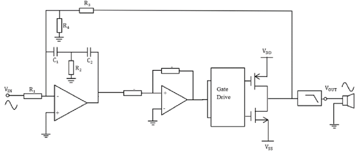

So, does "no global feedback" mean no feedback to the input is taken from after the output filter?
Just look at the circuit diagram.
The feedback goes to the audio summing point at the opamp inverting input and R1.
So it must be audio feedback.

But I see the point of the capacitive feedback, and that's surely necessary (and likewise the hysteresis in the next stage) for this circuit to be self-oscillating.
I think the only "no feedback" circuit in this thread is the one with the input signal and triangle wave going into the comparator.
The OP mentions Mr. Pass' designs - a Class A power MOSFET without a drain resistor would have no feedback, but I seem to recall that they (generally or always) do have such resistors.
The sigma-delta Class D amplifier operates in a self-oscillating mode, where the feedback loop (R3) is set up to induce oscillation, essentially functioning as positive feedback. The integrator introduces a 90-degree phase shift, and together with the Schmitt comparator and subsequent MOSFET drivers, it accumulates around 360 degrees of phase shift, forming a positive feedback loop to generate oscillation. However, typical audio feedback refers to negative feedback for the audio signal, where a 180-degree phase shift (with some phase margin) is required. Can R3 in this feedback loop serve both as positive feedback for the pulse signal and negative feedback for the audio signal? Clearly, it cannot.

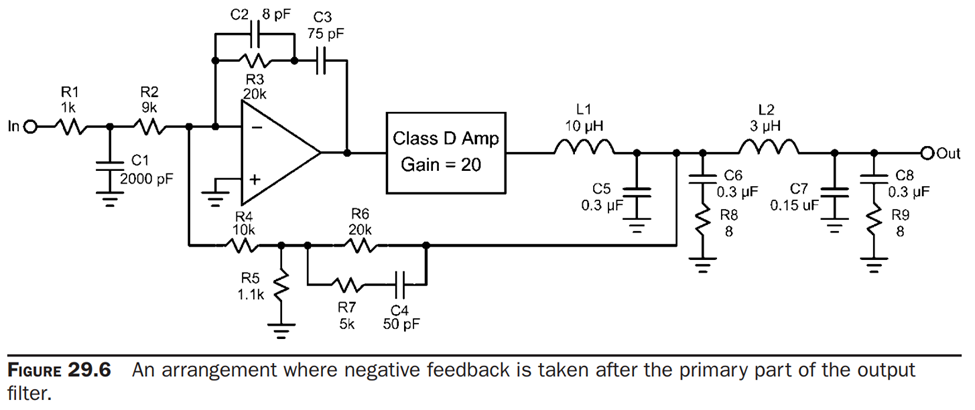

Figure 4, from ‘Designing Audio Power Amplifiers’ By Bob Cordell
Like traditional ADCs, to reconstruct the amplified input audio signal, an additional functional module, namely a DAC (Digital-to-Analog Converter), is required to convert the digital signal back into an analog signal.
Interestingly, the reconstruction process of a 1-bit bitstream signal is relatively straightforward, achieved through a simple low-pass filter (LPF). Typically, a second-order LC low-pass filter suffices for this purpose.
One aspect that can be somewhat confusing is the feedback loop in a Sigma-Delta amplifier. Is it the same as the negative feedback loop found in traditional audio amplifiers?
Firstly, it is indeed a feedback loop, and its primary purpose is to maintain the oscillation of the Sigma-Delta amplifier. This feedback works in conjunction with the feedforward circuit to provide a 360-degree phase delay for the oscillation frequency signal. The input to this loop is the modulated bitstream, and the output can either be the bitstream itself or the bitstream that has been low-pass filtered (adjusting the delay to produce different self-oscillation frequencies).
The most critical point is that this feedback differs from traditional global negative feedback in that it represents a finite time response, occurring only within a single PWM cycle. Below is a simple analysis of this distinction (to simplify the analysis, we will neglect propagation delays and other factors that do not affect the fundamental operating principles).

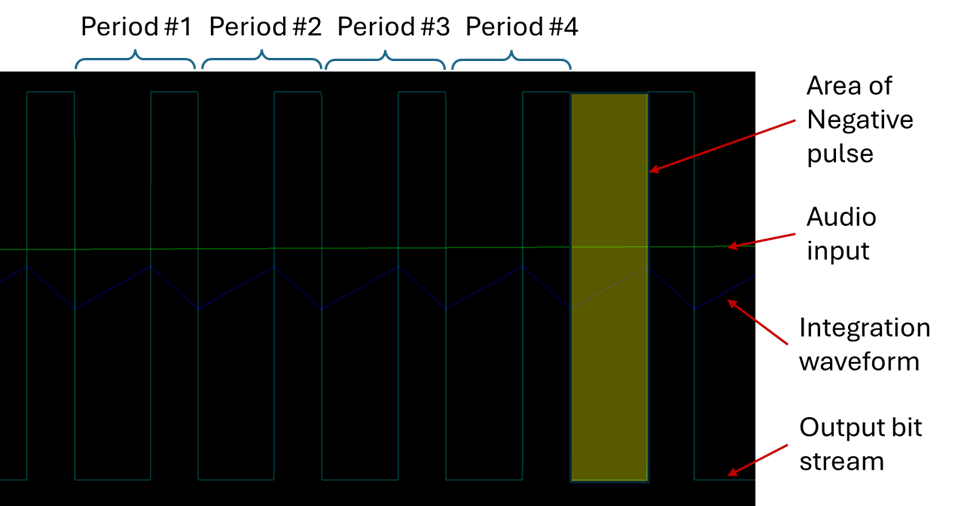

Firstly, in this example, the basic principle of modulation is that the area of the negative pulse waveform is proportional to the amplitude of the input audio signal. It can be observed that the area is equal to the width of the negative pulse multiplied by the amplitude of the pulse signal.
When the audio input signal is summed with the feedback digital signal and directly acts on the integrator circuit, the magnitude of the superimposed signal directly reflects on the slope of the integral output waveform. The larger the input signal, the lower the slope of the integrator during the negative pulse, thus resulting in a wider width for the negative pulse. When the area of the negative pulse equals the input signal multiplied by a fixed gain (a * Vin), the output pulse signal flips. This process repeats in the next sampling cycle.
During this process, if the supply voltage changes, for instance, increases, then according to the principle of the area equaling a * Vin, the time width of the negative pulse signal will shorten; conversely, it will lengthen if the voltage decreases. This explains why the Sigma-Delta amplifier exhibits a high Power Supply Rejection Ratio (PSRR).
At the same time, based on the principle of area equaling a * Vin, the Sigma-Delta amplifier also serves compensatory functions, such as addressing asymmetries in the rising and falling edges and the distortion caused by gradual rising and falling edges.
It is easy to observe that the digital signal feedback to the input acts only during the current sampling cycle. Due to the 1-bit nature of the digital signal (the signal flip serves as a reset process for the previous signal, without any memory), the signal in the next cycle is unrelated to that of the previous cycle. This means that this feedback does not have an infinite response, which is one of the key differences compared to traditional audio negative feedback.

The digital-to-analog conversion process is generally conducted using an LC filter. Although both the inductor and capacitor are passive components, they also exhibit nonlinear effects, which can produce nonlinear distortion. To minimize the nonlinear distortion generated by the LC filter, traditional audio signal negative feedback can be very effective. For better results, it is advisable to increase the gain of the feedforward amplifier during the overall design. Figure 6 shows an added feedback circuit in a Class D amplifier that is identical to traditional audio negative feedback.
Figure 6, from ‘Designing Audio Power Amplifiers’ By Bob Cordell
From the perspective of Sigma-Delta analog-to-digital conversion, regardless of how it is implemented within a sampling period, the 1-bit digital bitstream theoretically represents the audio input signal without distortion. This means that not only is the amplitude-frequency characteristic completely flat, but the phase-frequency characteristic is also entirely linear. Therefore, in the absence of the negative feedback shown in Figure 6, the Sigma-Delta Class D amplifier can be considered a system without audio negative feedback, as a significant feature of traditional audio negative feedback is its non-linear phase-frequency characteristic.
Finally, I believe that the Class D amplifier has a notable advantage over traditional amplifiers: from the fundamental working principle, the distortion of a Class D amplifier is frequency-independent. My tests indicate that if the distortion at 1 kHz is 0.1%, then the distortion at 20 kHz is approximately the same as at 1 kHz. In contrast, traditional amplifiers are generally affected by the parasitic parameters of components and circuit boards, leading to distortion that is frequency-dependent, with higher distortion at high frequencies compared to low frequencies.
