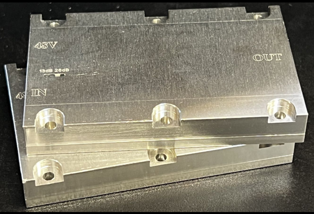

the shipping unit is shown as picture below:
the size is about 84mm(L) x 54mm(W) x 12mm(H), it can provide 100W (RMS) over 8Ohm load and 200W over 4Ohm. The maximum current is designed as 15A. And there is some other unique design of the circuitry to ensure the high sound quality, which including:

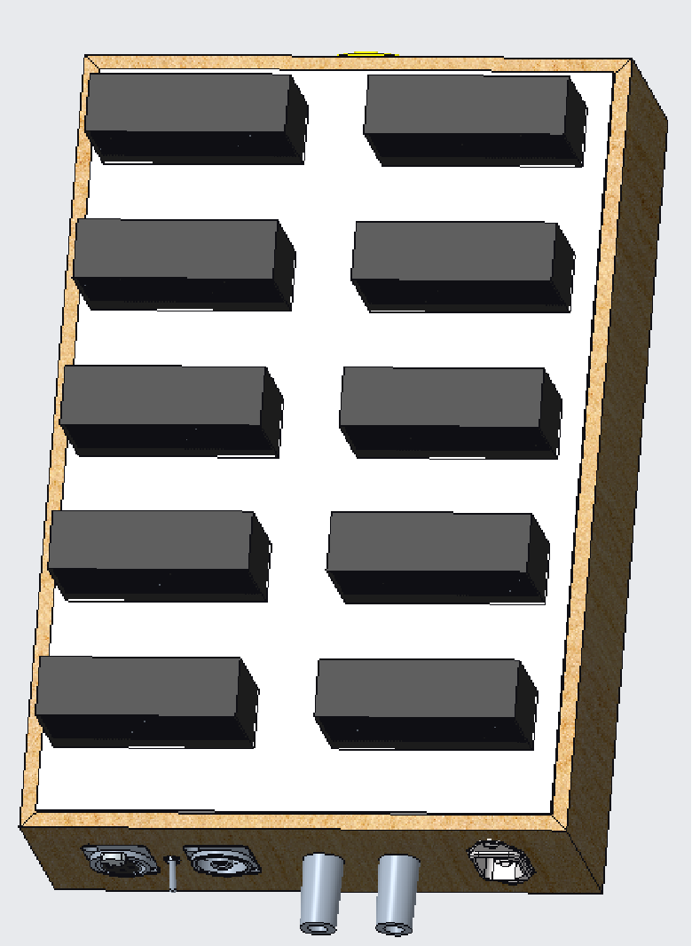

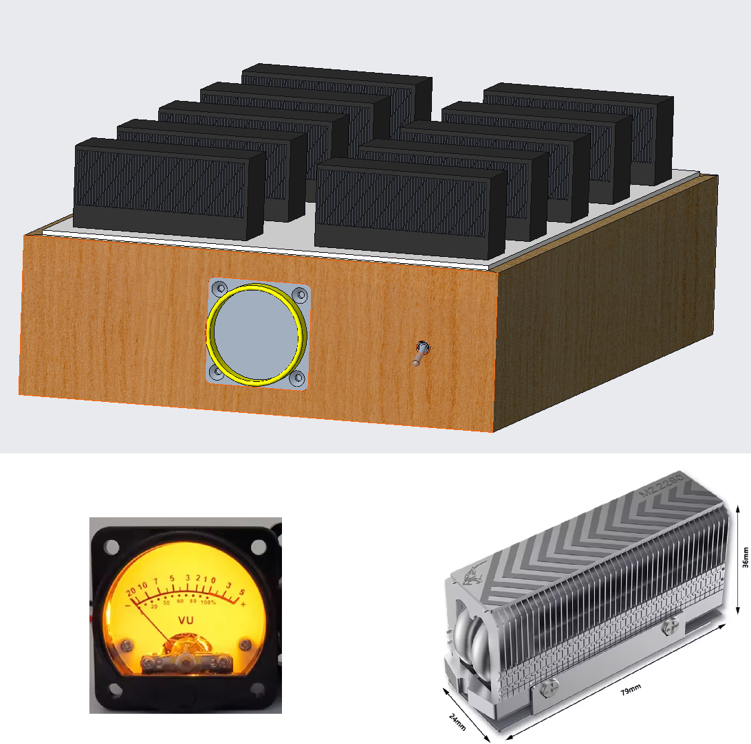

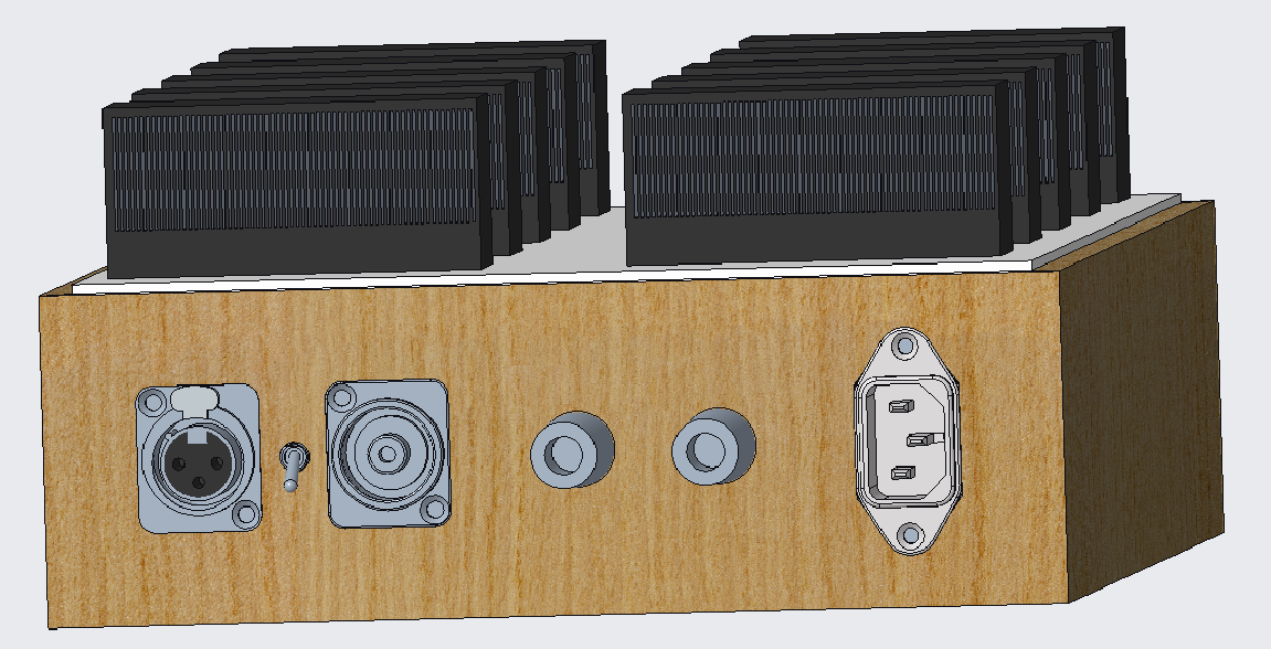

Designed a case for a Monoblock AMP, no rendering. appreciate your comments and suggestions.
front view
back view
top view
inside
front view
back view
top view
inside
