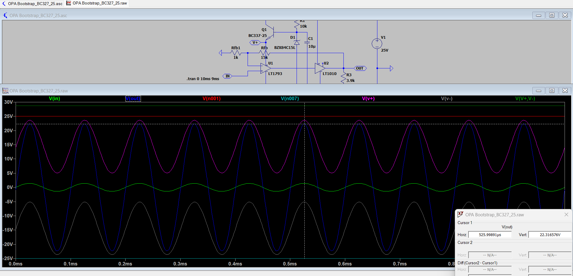

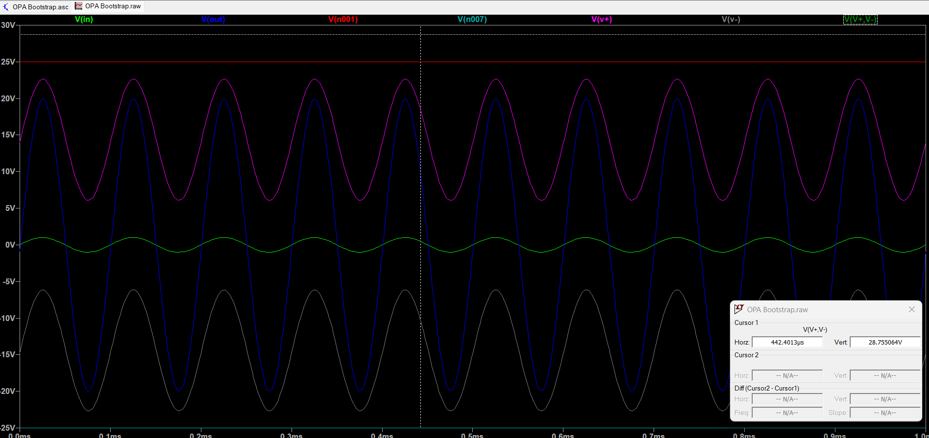

This is only to illustrate how it works.
The LT1010 represents a unity gain buffer, which of course can be the M2OPS.
Note that Vin must always stay well between V+ and V-.
Only think about actual application when you have it working on breadboard.
In the test case, you need to remove the LT1010, as it will not survive 25V rails.

Just a quick layout, not proven; so build at own risk.
You should check against the Spice circuit using your Gerber reader.
Then suggest you use 1mm thick PCB.
It can go directly on top of a DIP8 pin header, which you should solder first of all.
The SOIC single opamp should go on last.
And it should fit directly onto the opamp location on the Power Whammy PCB.
You need to route the OPS output and Gnd to this adaptor board.
Resistors and Zener are 1206 / MELF footprint.
Caps are 1210. Opamp SOIC8, without saying.
