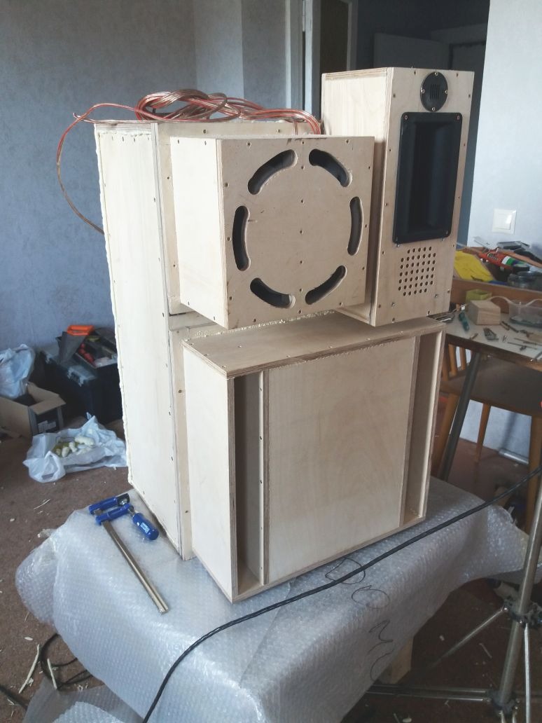

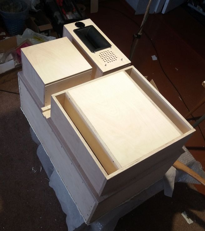

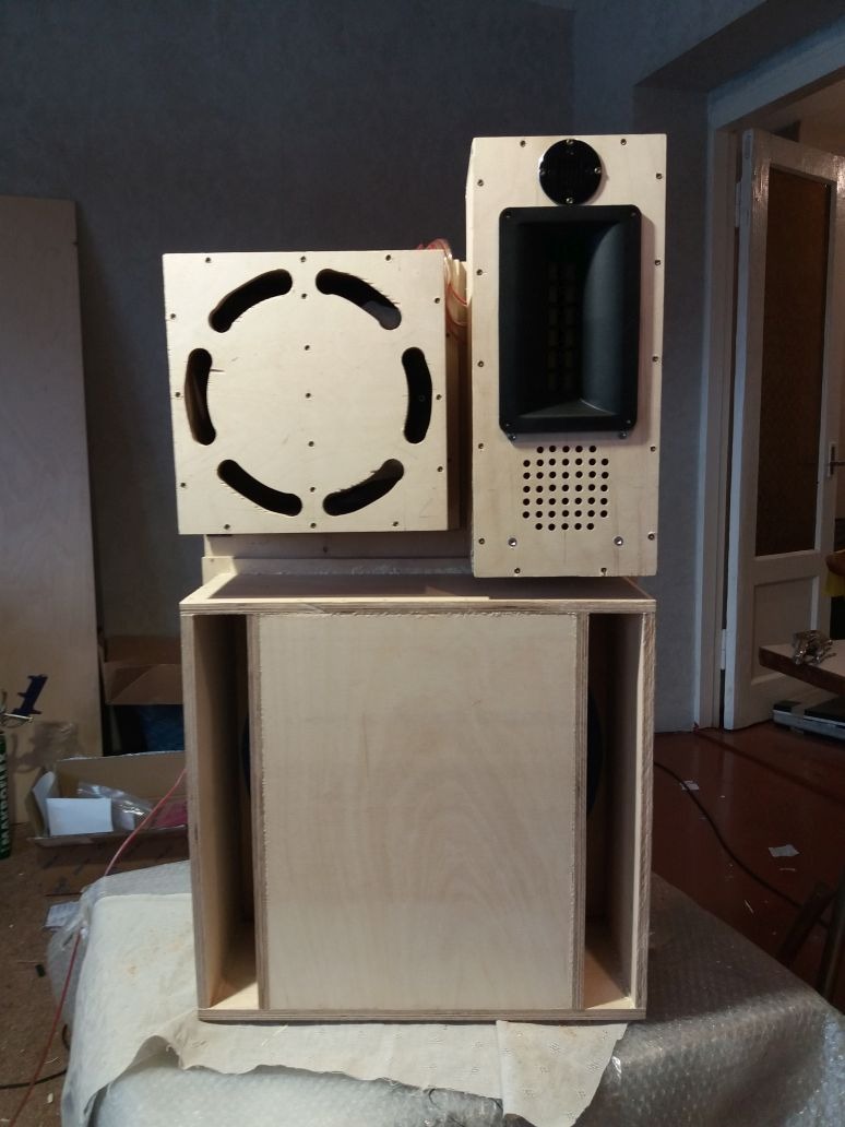

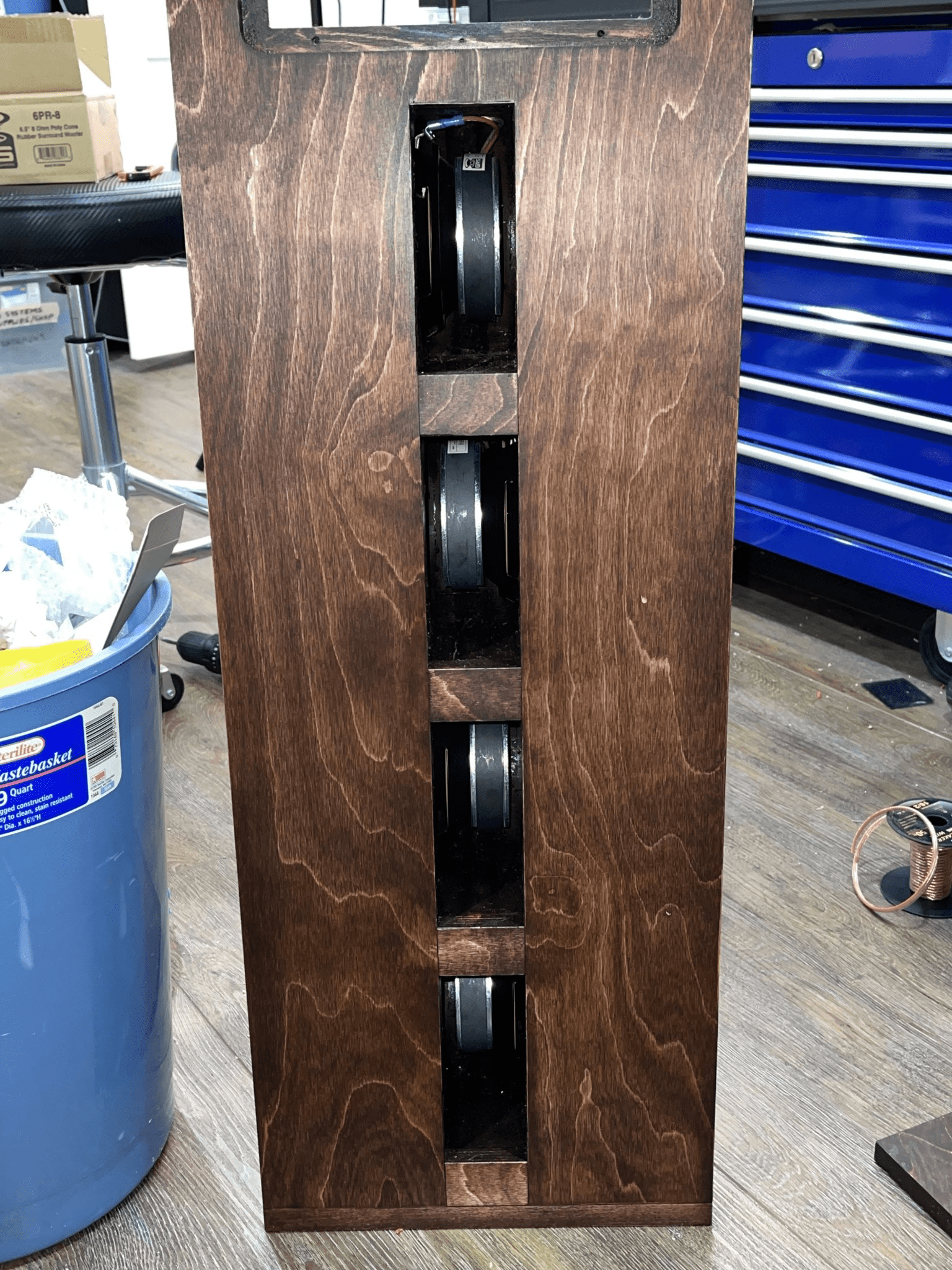

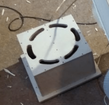

You have a good point about using bandpass slot loading to reduce distortion and manipulate the acoustic response prior to electronics. Especially on the woofer array. One way that I reduced the frontal area is to turn the woofers 90deg in SLOB arrangement. It doesn’t need to be an open baffle (OB) and can be used in vented or sealed alignments as well. This allows the drivers to push the air out of a slot and opposed motion cancels inertial force and reverses suspension induced non linear distortion of one driver is flipped around. With 8x 6.5in woofers I was able to achieve equivalent cone area of dual 12in drivers in a moderately sized baffle at exactly 12in wide. The 178mm deep slot chamber formed a natural bandpass at 470Hz which I used with the electrical passive crossover to create a steep 4th order slope for the pride of a second order filter (components wise). For an active system it doesn’t matter as much.
Here is a front view of the speaker I have that uses opposed slot loading on 8x woofers turned 90deg to reduce the frontal area:

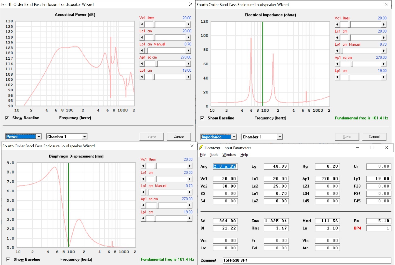

The opposed slot loading gives a low harmonic distortion in the woofer region as can be seen here about -55dB at 100Hz for 2Vrms:

The advantage and the beauty of the bandpass is an increased sensitivity which reduces necessary electric power, which reduces distortions. And the banpass as acoustic filter is filtering out nonlinear distortion (harmonics) as well. The result are improved acoustic properties of the loudspeaker as a transducer. The proper crossover filter for it does not changes anything in it`s properties.

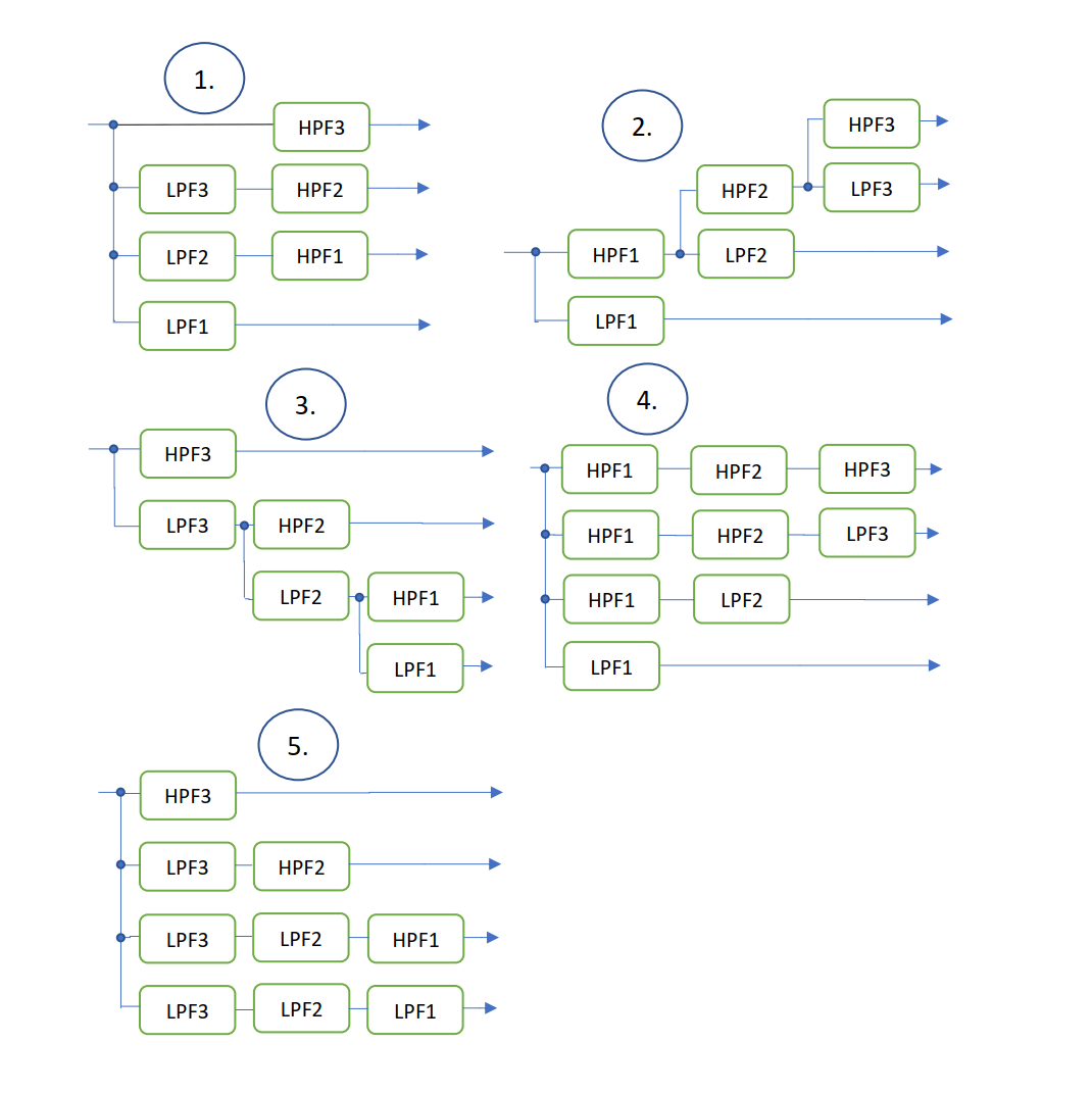

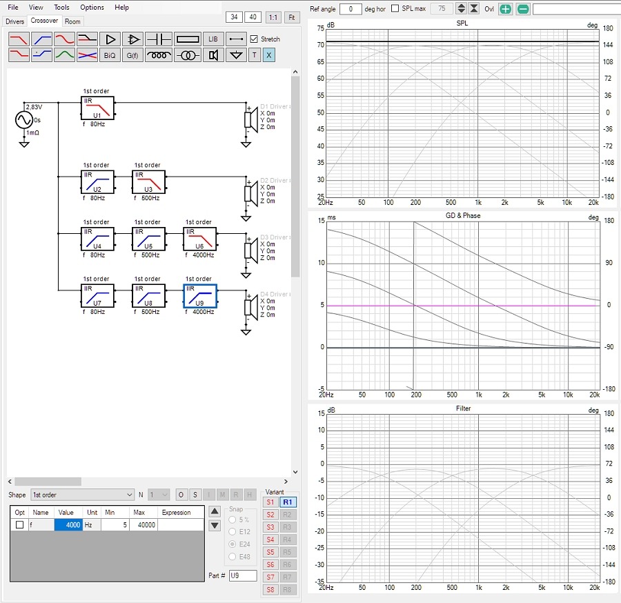

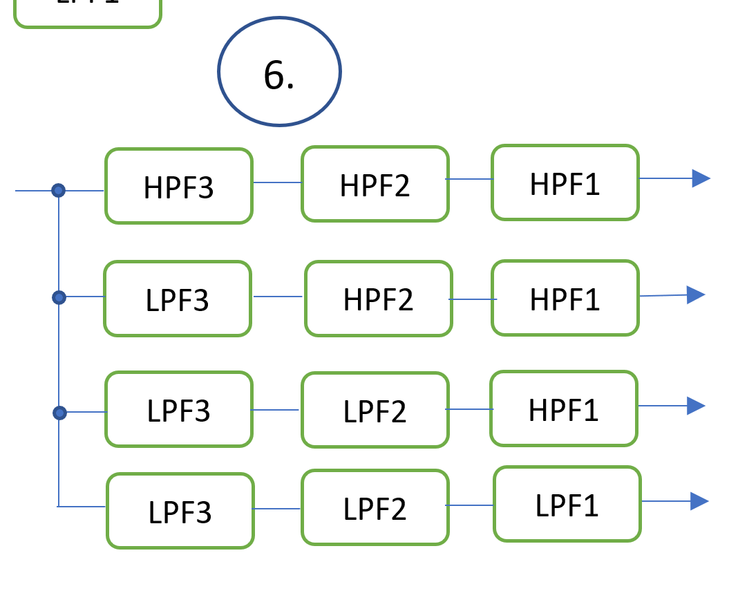

Which is (or should be) the correct structure for the crossover? Here is 4 way example.

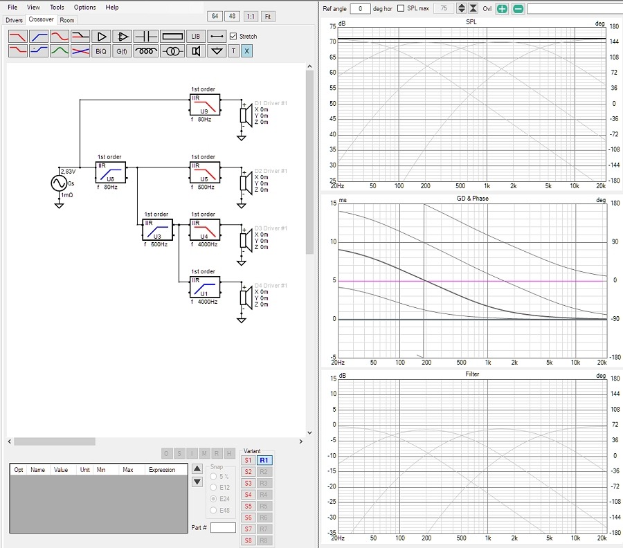

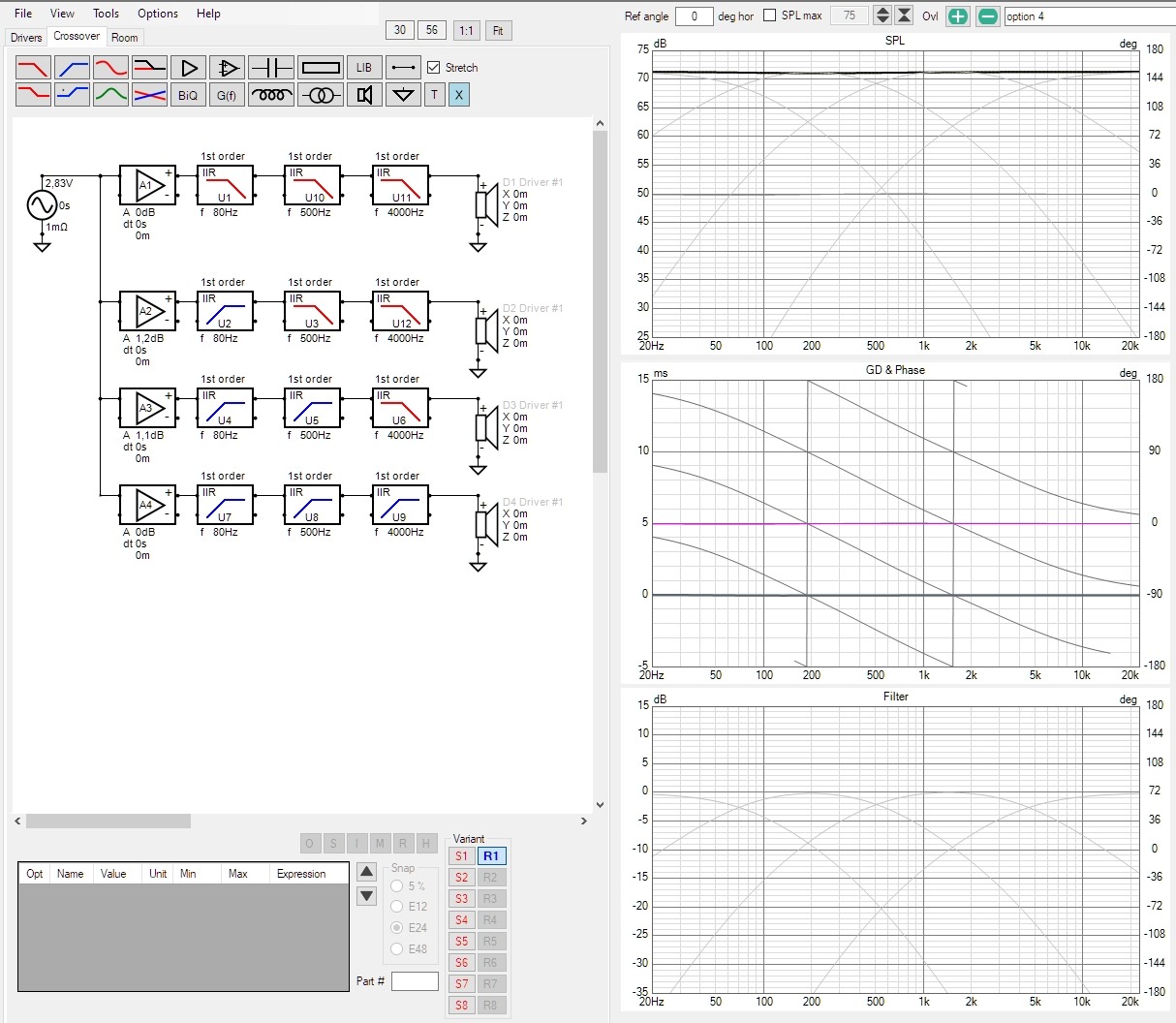

My guess would be 2, similar to this old Linkwitz inspired thread. Wouldn't 4 be quite close (or exactly the same) in comparison?
Option 2:
Option 4:
Exactly the same filter function as a result.
Option 2:
Option 4:
Looking at your filter schematic, I'd say you included a combination of 2 and 3 or 4 and 5. I can see the "bends" at each crossover, be it a lowpass or highpass. Just like they did in the thread I linked too
So combine 4+5 and we're good to go.

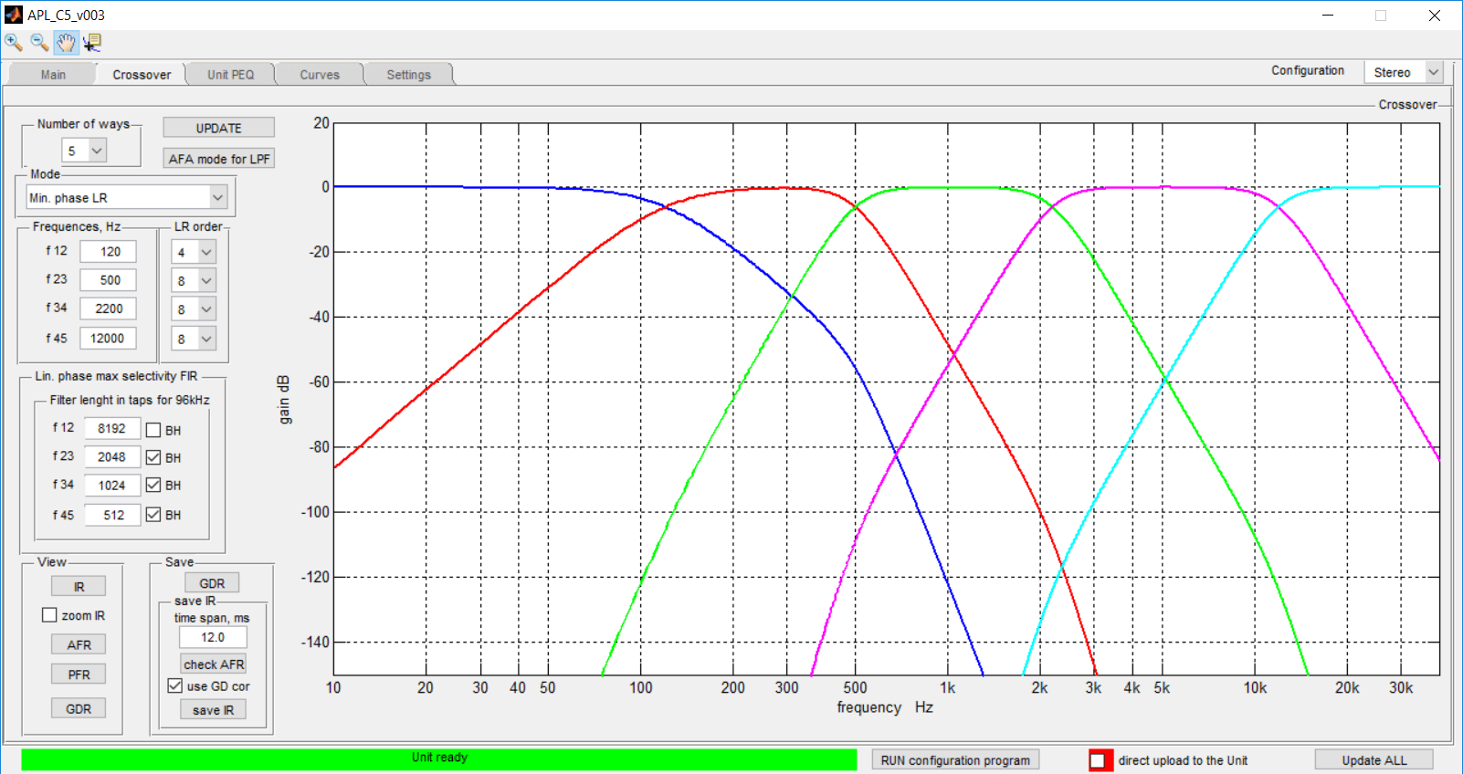

Yes, the essence is in the sentence of @Robbintip : "ALL filters have to be applied in some way to ALL units."
The ideal crossover is being created such way with same phase responses in all ways and no need for any tweaking.
And the "ALL filters have to be applied in some way to ALL units" is hidden under "AFA mode for LPF" button on crossover`s control window above.
Which means 4 and 5 must be combined in the 6 : )

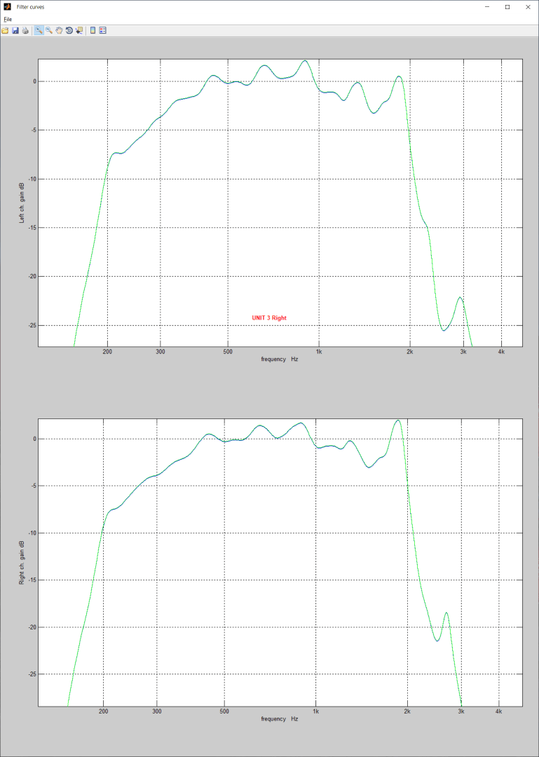

Why it is interesting? We have pretty much powerful FIR machines nowadays and it is easy to combine "All filters in all ways" and we can take into account a fact that particular driver is not flat but has its own characteristics / curve, Especially as in this bandpass project.
The Finite Impulse Response filter can contain Infinite number of curves combined in it.

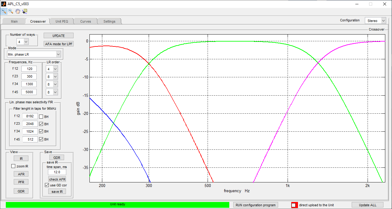

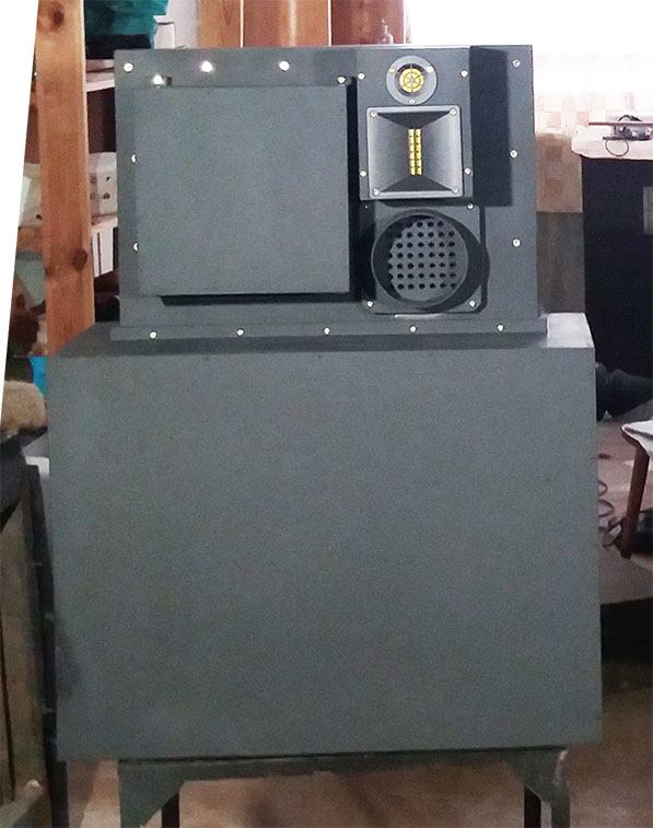

@Guerilla Yes, exactly as you mentioned. But we need to use an extra electrical crossover to reduce the out of band electrical power. And such two crossovers must be matched. We should chose an electrical crossover that is slightly steeper then acoustic one and set it as target. The electrical crossover should be found after that as a difference between acoustic crossover and the target.

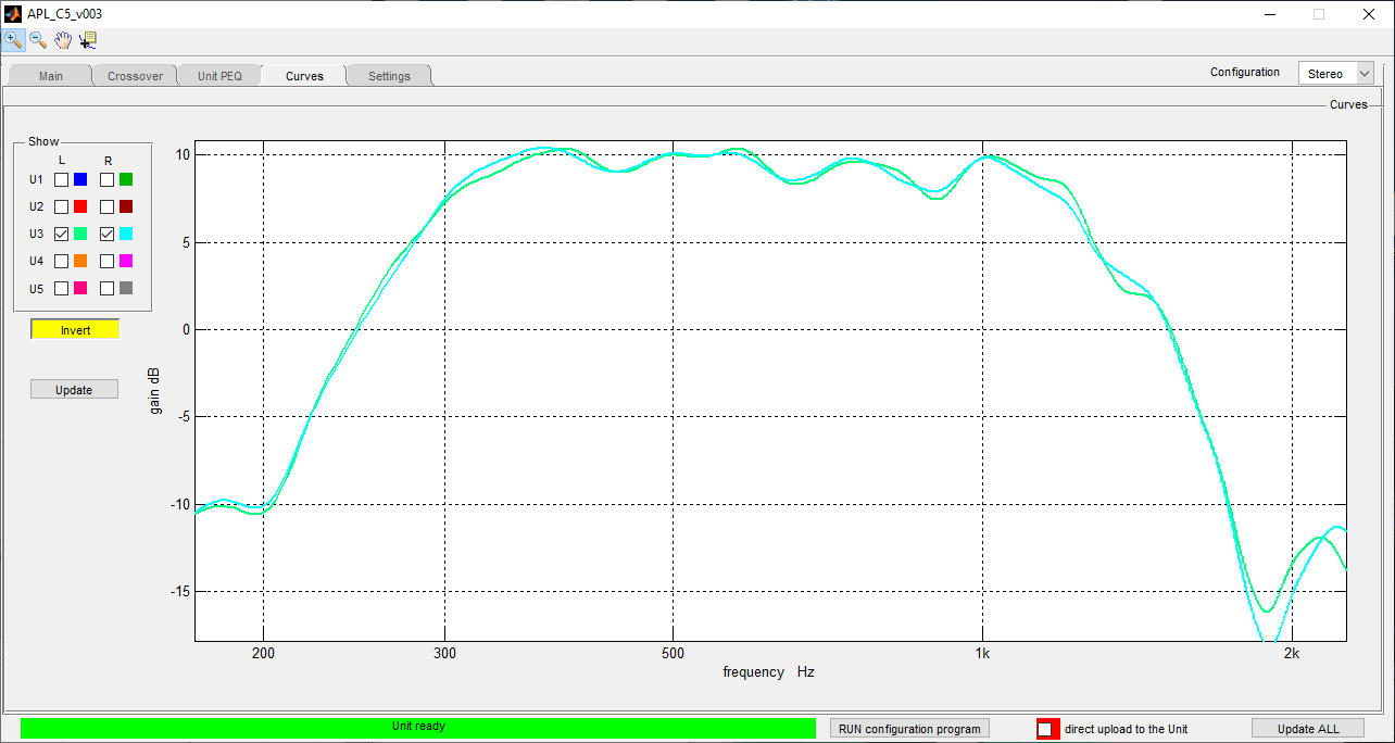

@danibosn Thanks, good question. I had experience with nice MEH example from Danley.

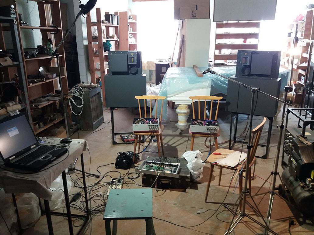

Here are measured curves of the 3d way of they system (two speakers, L R, hope you are finding them beautiful and too much similar for ordinary world : ) ):
Then 8th order crossover`s target was chosen:
And such filters were necessary to meet the targets:
