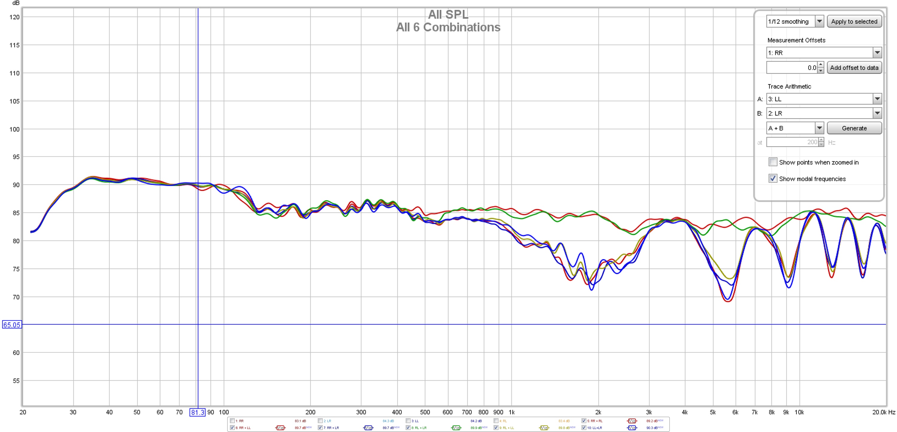

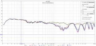

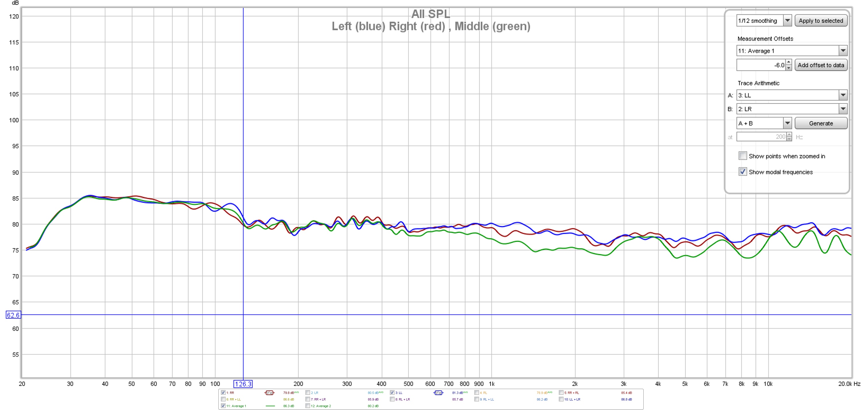

Something has been bothering me the more I think about the phenomena your addressing. When I think about what we are actually hearing, it isnt represented fully by both channels driven at one ear location. I think a better representation is as follows.
(RR) Measurement 1) right channel at right ear
(RL) Measurement 2) right channel at left ear (with a .275ms delay offset)
(LL) Measurement 3) left channel at left ear
(LR) Measurement 4) left channel at right ear (with a .275ms delay offset)

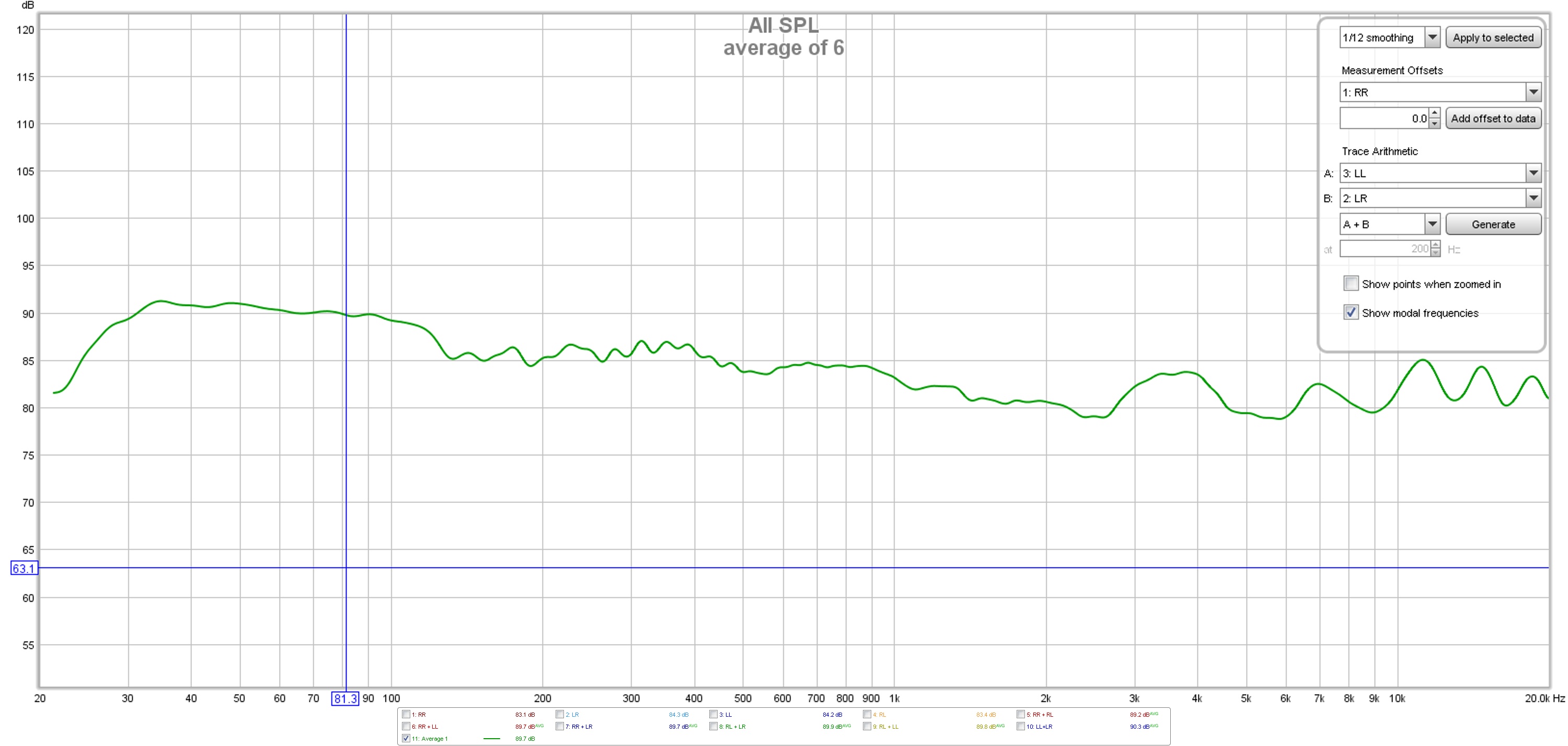

So, would it follow that the totality of what we are hearing could be represented as:
1) + 2) = RR+RL
1) + 3) = RR+LL
1) + 4) = RR+LR
2) + 4) = RL+LR
2) + 3) = RL+LL
3) + 4) = LL+LR
I think so.

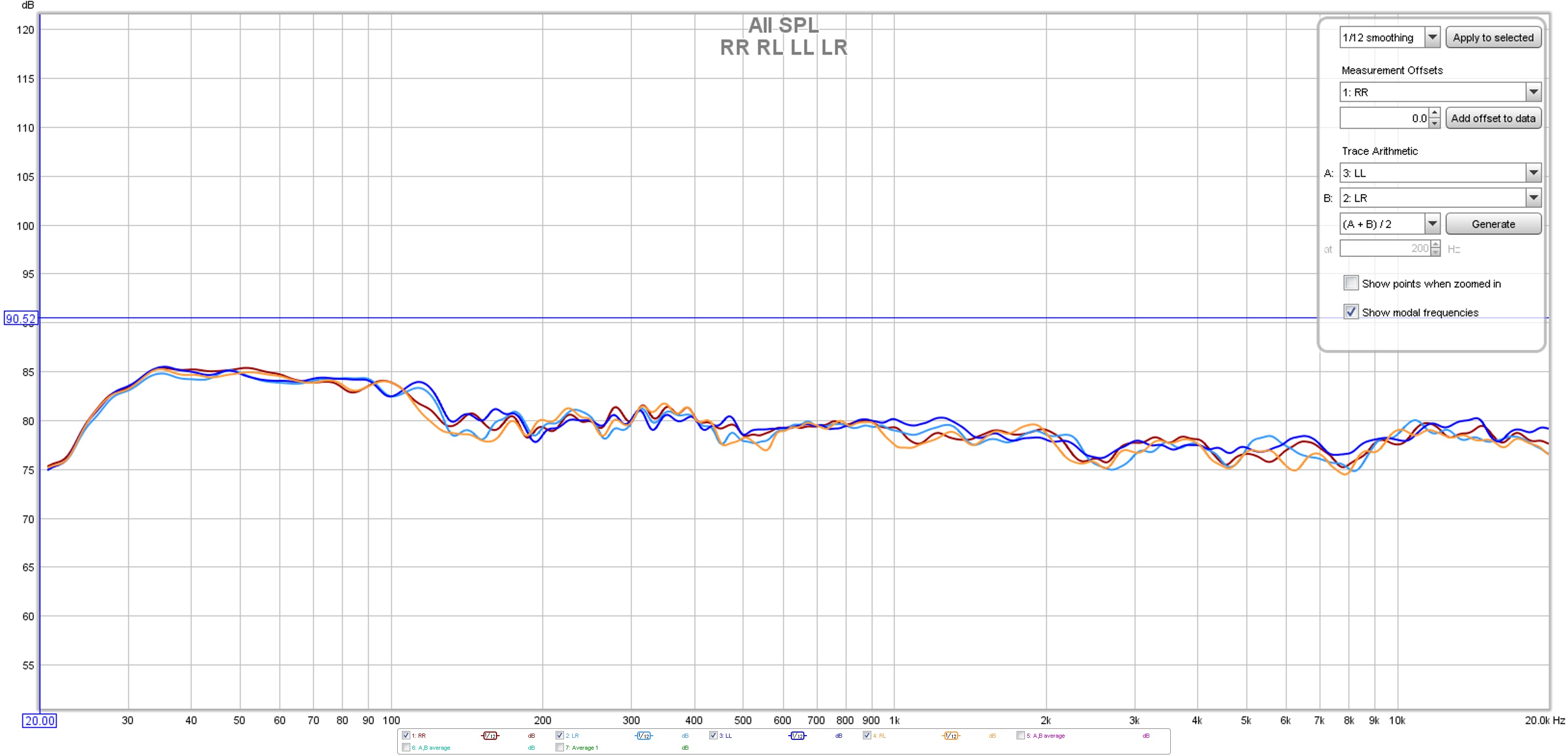

First RR, LL, LR, RL (1st pic)

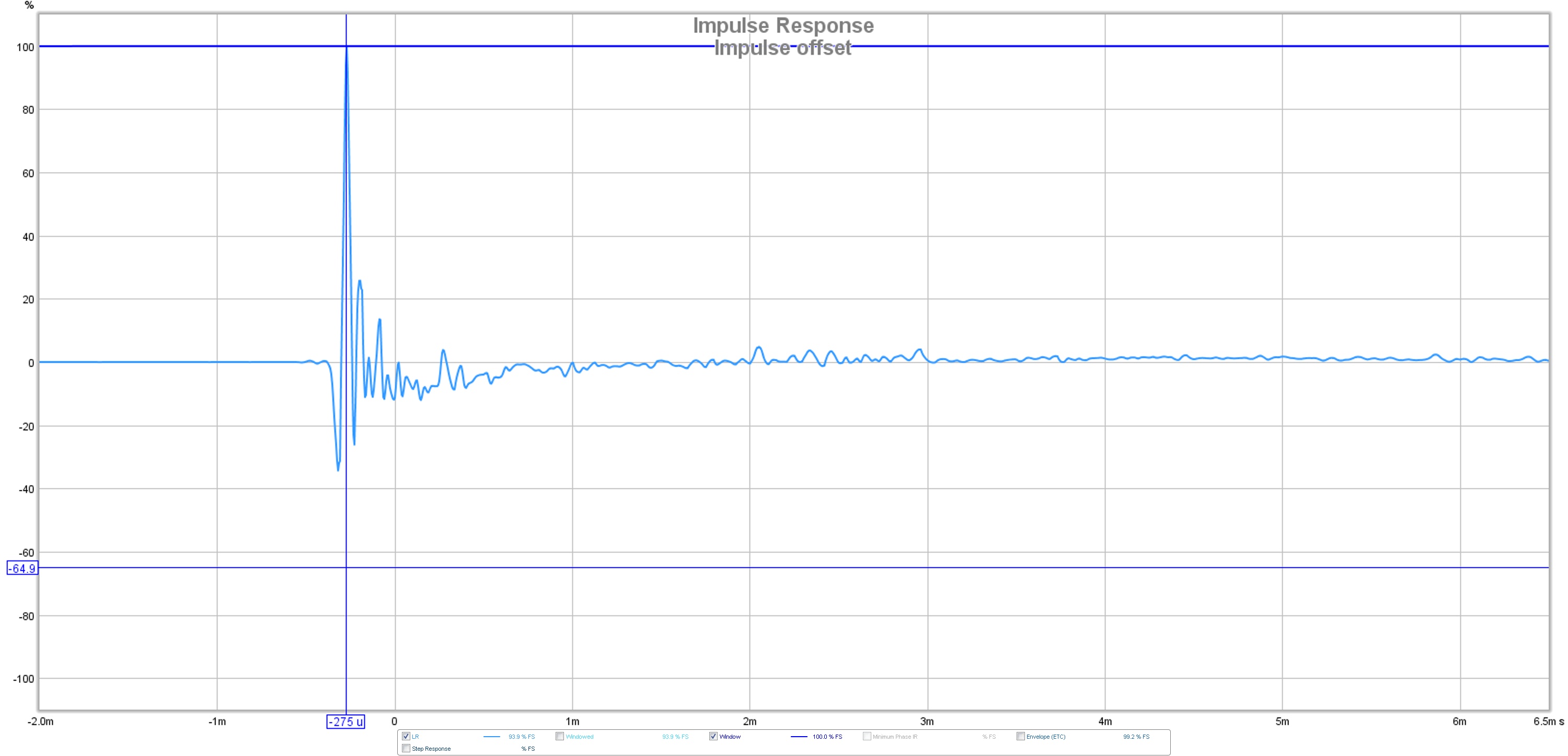

I went into the impulse of LR and RL and entered a negative offset of 275u (3rd pic) , then did all the math operations A+B to create the 6 new graphs (2nd pic). Then averaged those 6 (4th pic)
1) + 2) = RR+RL
1) + 3) = RR+LL
1) + 4) = RR+LR
2) + 4) = RL+LR
2) + 3) = RL+LL
3) + 4) = LL+LR
I think so.

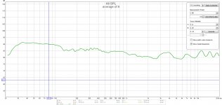

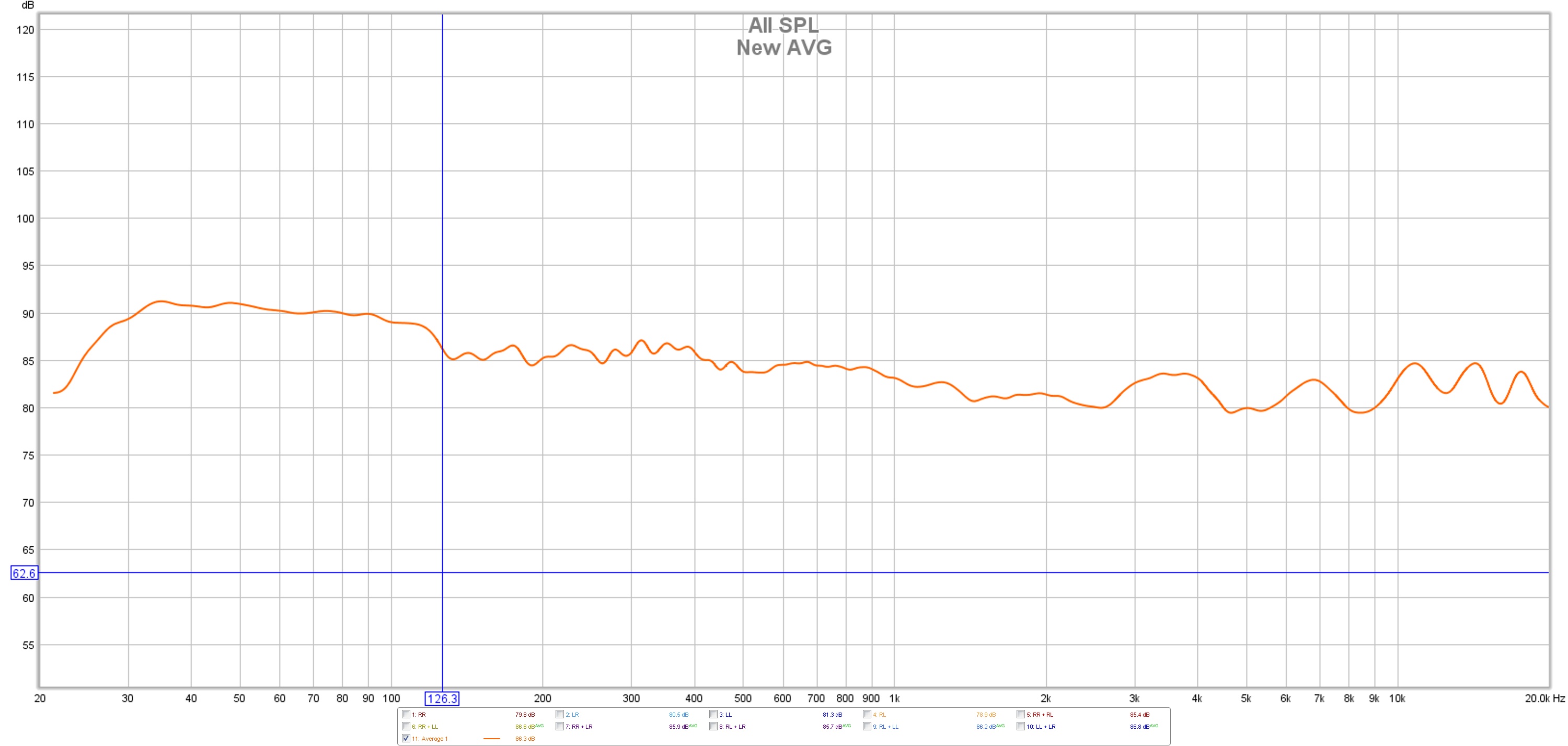

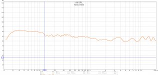

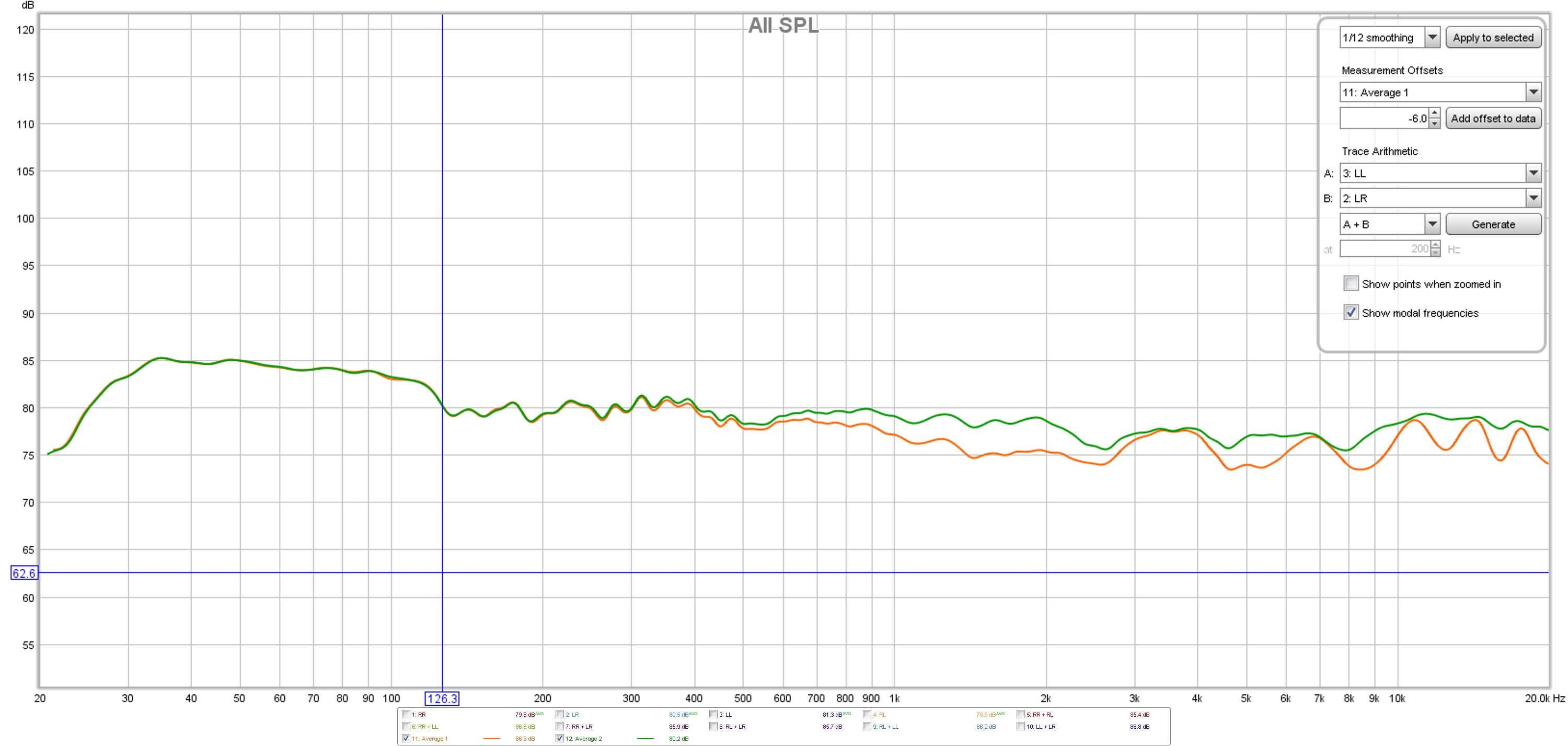

So the difference (on my system) becomes this (see pic)
(orange = averaging in the comb effect)
(green = just averaging the 4 basic measurements RR, LL, LR, RL without the head offset of 275u)
So in conclusion. The head offset problem does darken the middle of the soundstage, but not as drastically as the theoretical models or a stereo sweep at one ear location would indicate.

One thing I did miss in your add/subtract picture. To me it seems that the combined left+right phantom should be higher in level (below 1 kHz) than the sides. At least when the cross talk kicks in after ~270 ms. That's what I'm getting anyway. Which is also the base for that "S" curve story I linked.
That would make the bumps at 3.5 and 7 KHz just above average and the dips at 2 and 5.5 KHz fall below the average left and right SPL level.

P.S.

To give you an idea on the pulse shape:
![x-talkpulse.jpg](https://www.rsr-concepts.com/diyma/x-talkpulse.jpg)
And filtered IR showing how far down the signal is relative to the main pulse:
![x-talkfIR.jpg](https://www.rsr-concepts.com/diyma/x-talkfIR.jpg)
Phase is almost flat for this pulse as it's almost a symmetrical signal. No more than 4 degree phase swing...
