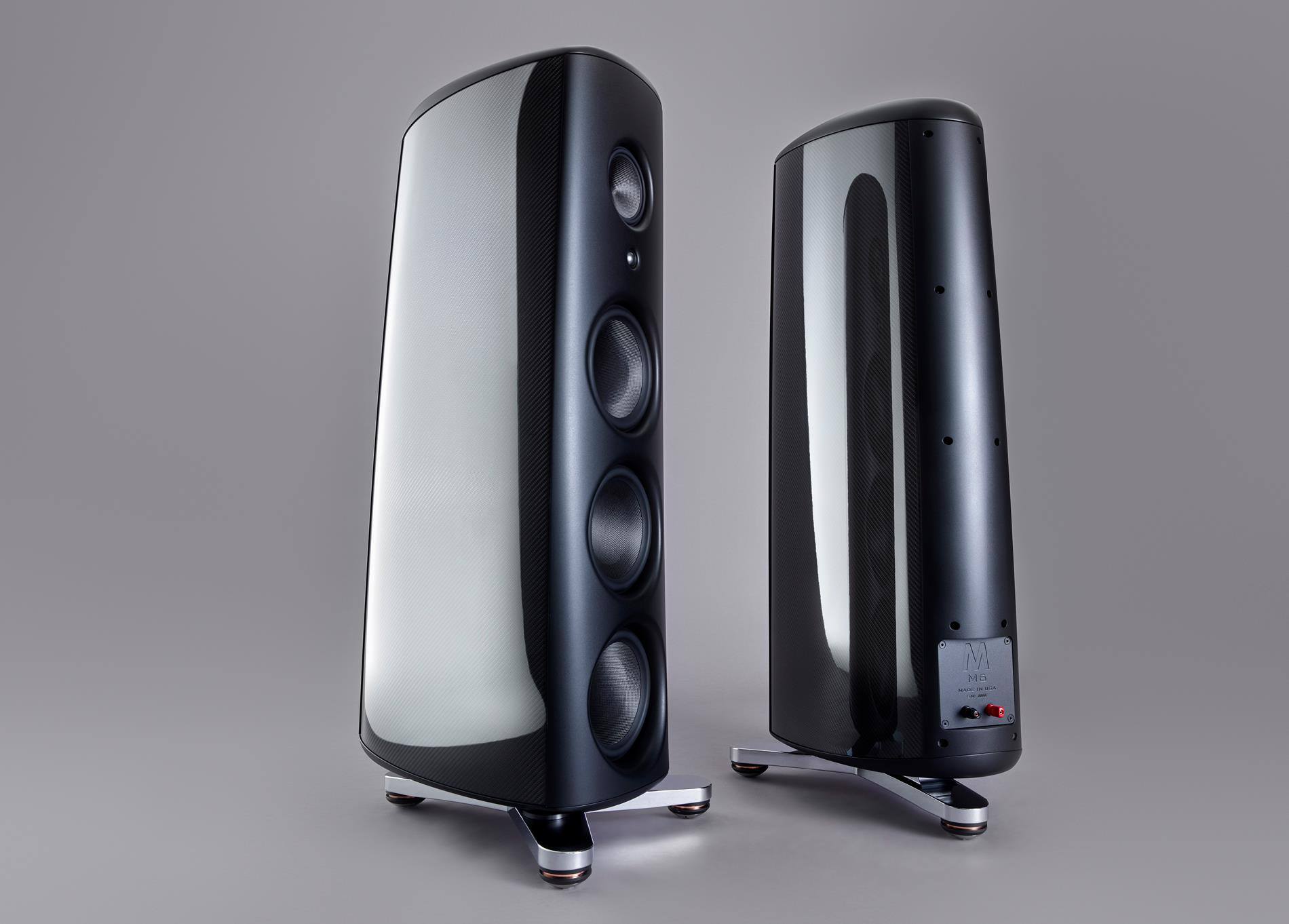

It looks like after years of 'more or less' rectangular shaped boxes, Magico has finally returned to smooth flowing shapes. First with their M-Project and later on the M3 and the new M6:

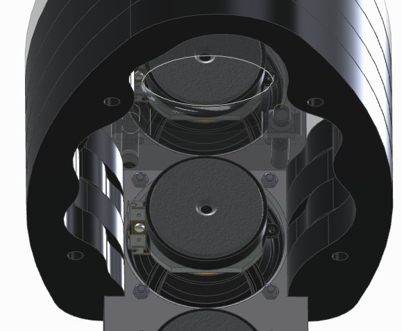

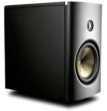

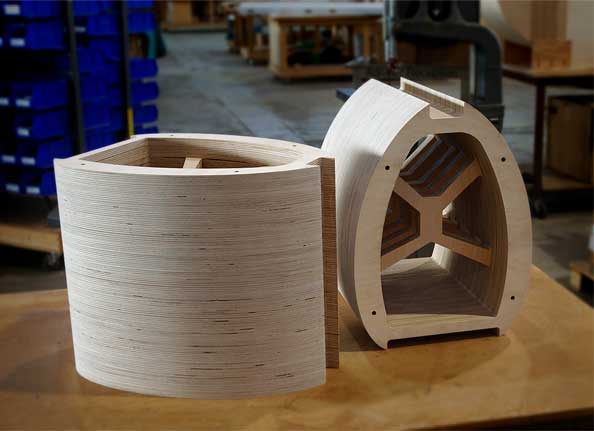

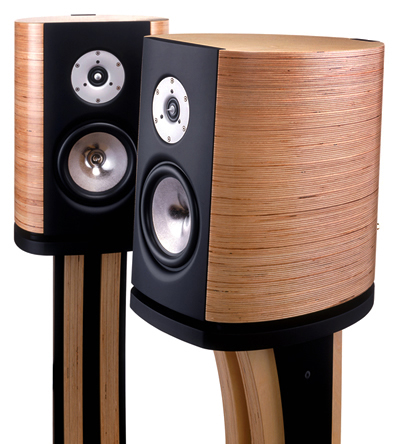

I only found out about Magico and their Magico Mini's long after I had planned my own design. In a search for using Aluminum baffles (after seeing koldby's sexy Aluminum columns, my true inspiration for that choice) showed me that their Mini design and my proposed arrays did have a lot in common. The stacked Birch ply, Alu as baffle and the overall shape.
attachment.php
attachment.php
They moved on from the Mini to the more square shaped enclosures. That really surprised me. To me, the Mini enclosure shape made way more sense...

Their cheaper (relatively speaking) "S" line featured more smooth, round shapes in newer generations. They finally seem to return to minimum diffraction designs again in the top of the line products. I wonder if they still employ their elliptical crossovers.
Just an observation, having never seen or heard a Magico speaker in real life I wouldn't know how they sound, I did like the look of that Mini though 🙂.
I like the new feet on that M6 too 🙂. Even that 'feels' a bit familiar.

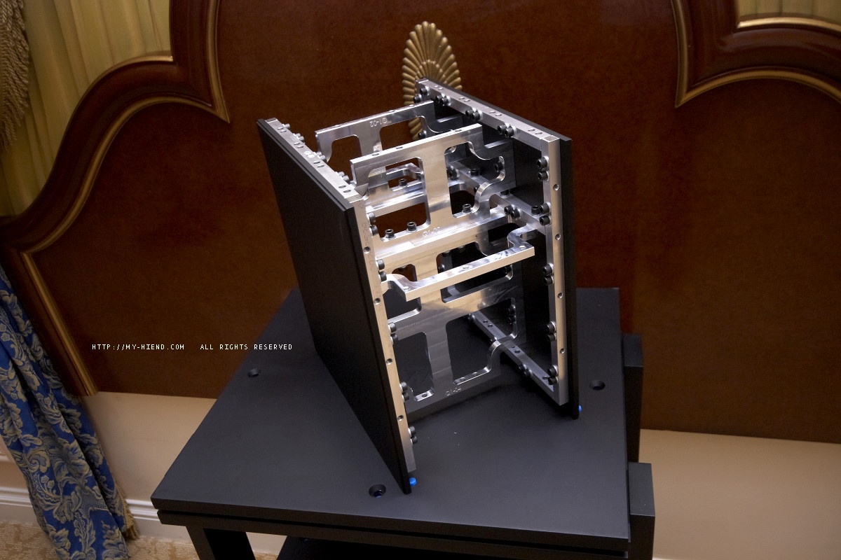

To an all metal construction (using Aluminum and Copper):
I do get that straight lines is the cheaper way (as everything is milled out of solid Alu) and they only kept a bulging baffle, milled out of a solid piece of aluminum (just like the Mini)...
The new M6 has carbon fiber sides which are easier to sculpt to round shapes..
Magico | M6
They've never been a company destined to save a few bucks in materials. Even the M6, with it's 'light' carbon fiber construction still weighs 177 kg each 😱.

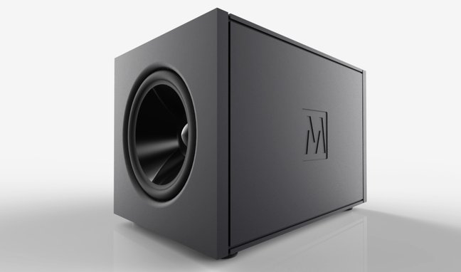

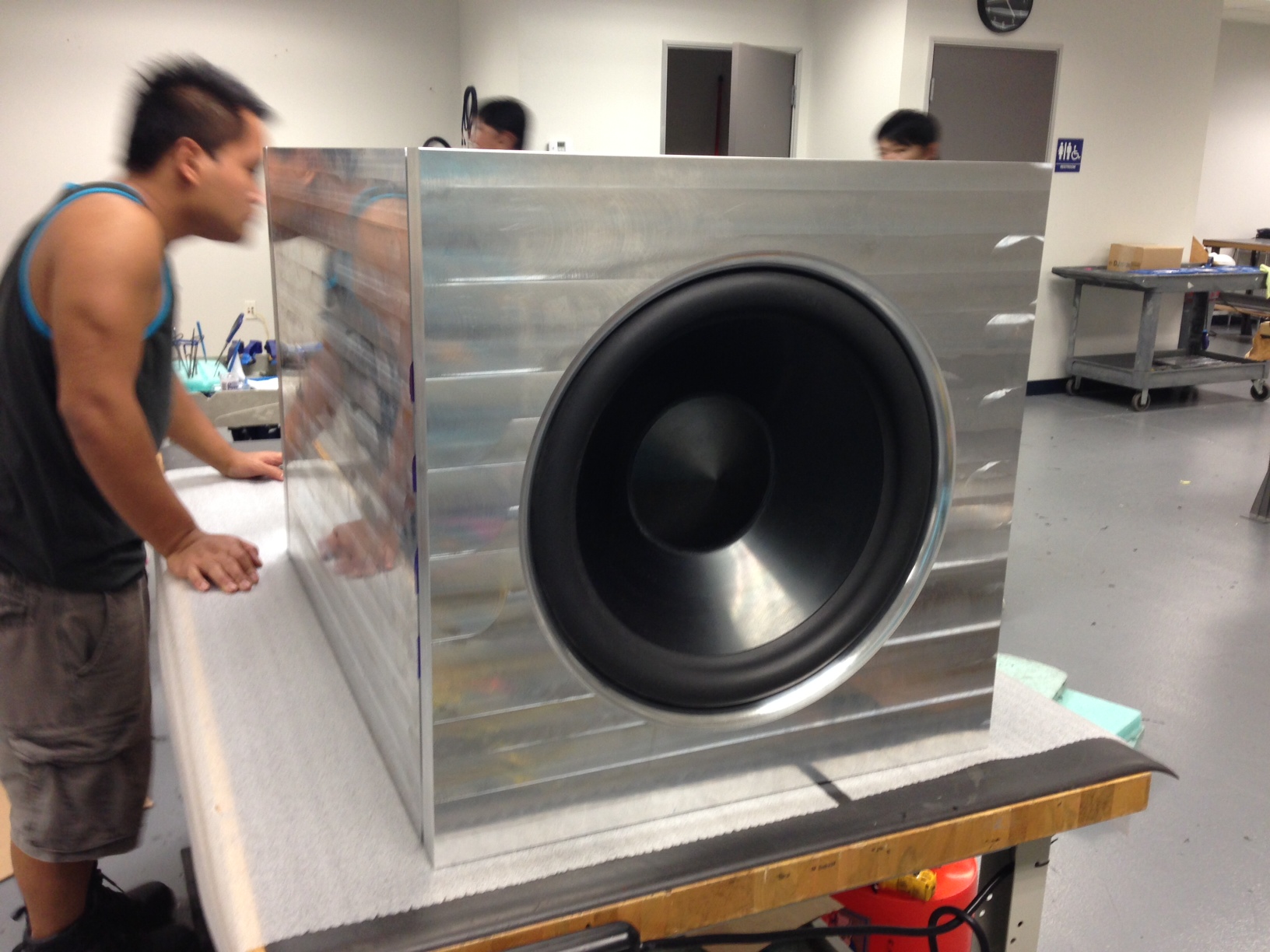

Their subwoofer was an inspiration for my own sub design:
attachment.php
And my proposed "mini" version, only slightly different in appearance 😀:
However I doubt I can mimic their build materials:
attachment.php
I like the "all out" approach they have. Like I said though, I have never heard any of their speakers and it's not likely I will any time soon. In the video I linked I did like the "Form Follows Function" statement, which I believe is the approach I took and have mentioned before.

wesyaso,
Picture in your post of the sub-woofer that they are making (looks like the model with 18 inch drivers)- according to the Magico website that sub weighs 258 kg (570 lbs)! 😱
I wonder of it comes with safety instructions on what sort of floor to place on...
