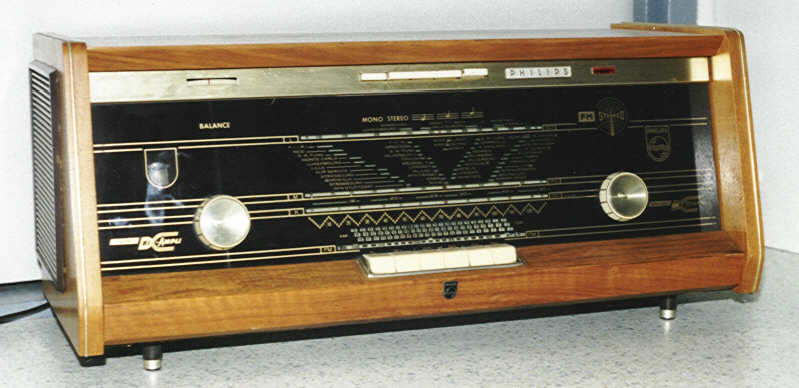

The Floyd track took me back to my youth, when I was in my tiny little bedroom at home, with an old Philips tube radio and open baffle speakers hearing this track on the radio many times late at night. I have loved it ever since. Must have been in my early teens.
The radio was one a lot like this:
attachment.php
I had taken out the side speakers and made an open baffle housing for them. There were (old wharfedale) bass speakers underneath an a couple of car tweeters above. At low night time volume I remember enjoying this sound very much. The speakers were stacked one upon the other, my mom has bumped into them more than once, furious at me for having them that far out in the room 😛. Good memories 🙂.
