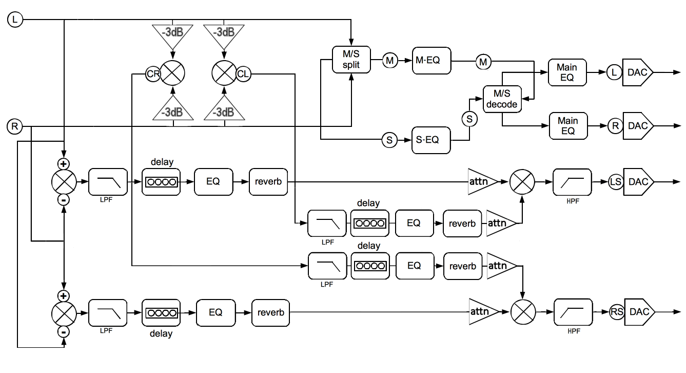

There were some things that bugged me about the schematics posted of my processing. After going over it one more time I have fixed some errors that actually do matter if someone wants to try it. Here is a revised schematic...
What was fixed, you may wonder...
- in the main line there was (Main) EQ placed in front of mid/side action for those channels, not a good idea. If the EQ is different between the left and right channel it will upset the mid/side balance within the original recording.
Any (main or other) EQ should take place after the mid/side EQ.
I made it represent my setup, as I do show 6 channels (for a reason). Wiring it in 6 channels can give you a virtual way to check each branch within the processing. Just feed it with it's recorded IR.
As we can feed it with a (+L and +R) representing the phantom material, with either (+L 0R) or (0L +R) to represent a signal panned to the corresponding left or right side, and last with (+L -R) to check out of phase balance.
* 0L or 0R represent a stereo channel without a signal on that side.
I replaced the fixed attenuation on the center part within the ambient channels as it would or could be a variable to play with.
If I see any more problems I'll report. This does not show my complete EQ scheme as it leaves out any FIR correction. For the mains this step should be either before or after the [main EQ], for the 4 ambient channels it would be placed after the attenuation steps. Where the (CL), and (LS) get the left side ambient FIR correction and (CR) and (RS) would get the right side ambient FIR correction.
Lots can be done to review each step with a virtual measurement saved to disk. Very useful to pick up errors in the process. It's very easy to overlook some steps here.

Would it help anyone if I were to edit the above schematic to reflect my complete setup? Just asking as it would be more work. In the above schematic I still tried to omit the specific needs I had and tried to keep it all "basic" or "universal".
Tell me if there is an interest and I'll see what I can do. I could link the schematics to each JRiver/plugin step for clarity.
Please do, Pano.. that will help. It is time consuming to do it with a bitmap editor
@gassit, I will try to show it all, and relate it to examples of what I use in JRiver and where. Meanwhile I've already changed some parts of it out of curiosity. I'm not able to really put it to the test. Let's just call it experiment # 400 or something like that
