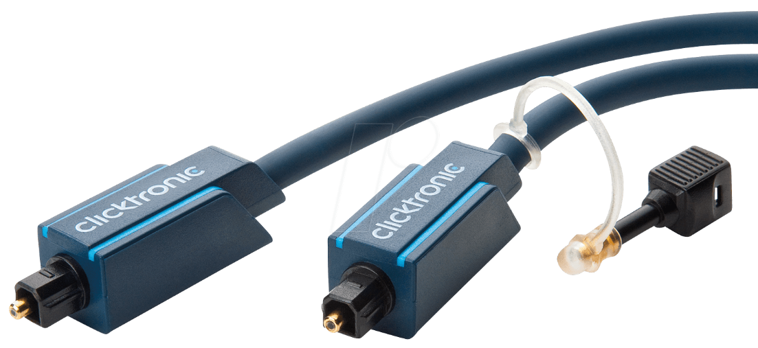

Should I be worried the Clicktronic site mentions the # 70572 as identification for their top rated model and that one seems to be double the price wherever I find it? The crazy world of audio.
Clicktronic Advanced Opto-Kabel: Amazon.de: Elektronik
I currently have a HQ 10 m from their silver professional series. That one screams trouble, mentioning OFC and Gold plating on their optical cables 😀. It's in the same price link as that 70372 cable.
Ha ha agree its worrisome when some marketing folks starts roll out their rubbish about OFC and gold plating for optical cables.
About cost of that brands 10 meter run try look at your link where they tax it at €54,90 because into same link they in middle of article point to the same brands 15 meter run and its costs is only €22.72 :scratch1:, think myself would try it at Reichelt for €26,90 and when ordered write a note if they sure its a 10 meter run because it was supposed to have 70572 number and not 70372 : )
Good research about plastic and metal housing, my own 0,5 meter run below is then the 500 series, i can't see why metal is better than plastic for this use and don't think it will hold kitten back, for that you need panzer or better : )

That test is scheduled for today 🙂. At least, the subjective part of it (just listening). A gold plated oxygen free copper optical cable does not inspire my confidence in this one though. I couldn't see that part before buying it quite a while ago.
It makes the "professional" tag a bit useless.
I have ordered a Clicktronic cable to replace it, no matter the results I get.
Even though their HIFItest.de award isn't confidence inspiring either. They tested all of the cables from Clicktronic there and the most expensive ones get the best ratings. Smells like a deal in advertising. It's hardly a test at all. Actually, it isn't.

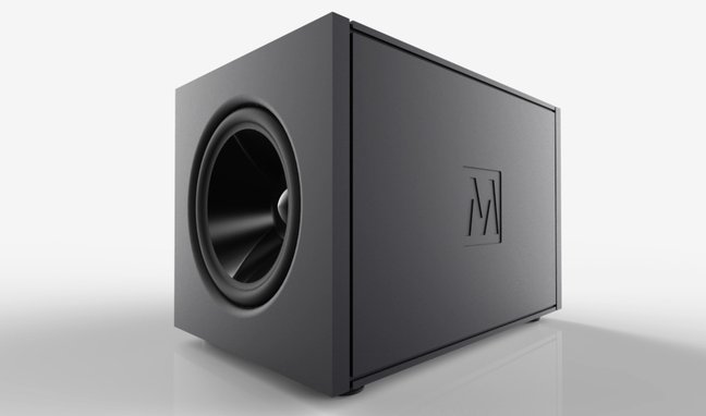

I think it's a bit too large to go there.
That was my first impression too - Or - too black:
But, that is not really it, if You went smaller, I believe You would still have the same problem... From what I can see in the photo, due to the reflective nature of your baffle, Your logo is getting lost in its own reflections, its shadow and reflections from other dark stuff in the room. I can not see all the strategically placed gaps between the letters or none of the points on the serifs:
I think the logo could work at this size, it just looks too big due to the "reflections" I mentioned above. And the black is not helping, at least with how this logo protrudes out from baffle.
Here are some possibilities:
I believe the black could work if it was "painted" on flat. This would eliminate reflections and shadows. I know this would be hard to do, because of the mirror finish, but You could get a decal version made. At least You could remove it if You did not like it. 😉
As BRYTT mentioned, there are other color options. I personally would stay away from anything dark with a protruded logo - as it will act similar to the black. I agree with BRYTT, that any color You pick needs to be matte. I would like to see it in brushed aluminum. You mentioned You have a metal version, how hard would it be to get it back to bare metal?
If You where up to experimenting with different 3D profiling, like the drawing I posted below, You could use any color you like, as the triangular cross-section would eliminate the reflections and shadows. I am not sure if this profiling is possible in this size - but it is an idea. I realize this would require some "tweaks" in your logo, as some of the serifs do not align with the profile points in some areas.
Final option I can suggest would be to make shiny plates, like what You did with the amp, either with just the logo or the logo with your name and "The Two Towers". 🙂
Hope this helps to spark some ideas.
