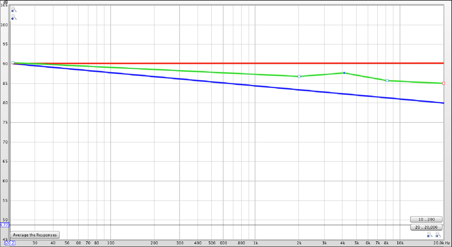

I see one curve were you have a 5dB shelf below 100 Hz, then response drops off by ~5dB from 100 Hz to 16 kHz. An Olive slope with a bass shelf. Is that where you are now?Even though I did try some known room curves, like the B&K curve, another curve from Mitch/Bob Katz, I also tried what Siegfried Linkwitz proposed, I did not find something that simply worked well for all music I liked.
This is the curve I have, aside from the mid/side EQ tweaks:
It's closest to the "Trained listeners curve" as presented by JBL.
Not too far off from earlier examples, but minor tweaks do have perceptual differences, if they span a couple of octaves.
The curve you mention has been used in the past, but on top of that I tuned the mid/side EQ. The above curve lies in the middle of all mid/side tweaks.

This graph shows what happens when mid/side EQ is included:
The dark blue line, following the JBL curve, is what you get for sounds panned hard left or hard right.
The upper green line would only be valid for L-R or R-L signals. The line with the dips at ~3.4 KHz and 600 Hz is the phantom trace.
Small tweaks can still further evolve these results. Overall this changes the perceived balance that makes the side panned sounds and phantom sounds sound more alike. It gives the side panned sound way more body and removes a bit of a boxy sound of the phantom center. It makes the center panned sound more intelligible, easier to follow and makes it stand out more. There's still more experimenting to do, I'm sure. Just reporting what worked for me so far. It works in conjunction with the virtual reflections and tweaking the balance between mid and side has a huge effect too.
Levels of early reflections out in the room play a huge role in perception here. I hardly have any loud early reflections present and introduce late reflections (after ~15 to 17 ms) which further help the perceived balance. Basically it fills in the tonal gap we get due to our two ears at ~1750 kHz in the exact sweet spot. The virtually introduced late reflections are split into mid and side too, with each having a slightly different balance and crossover point. The sides, consisting of L-R or R-L, are pretty flat and have a 12 dB/oct crossover set at 3.5 KHz, the phantom part is running up higher to 7.5 KHz, it also has some minor tweaks that I'm still working on perfecting.
No idea if this info helps anyone. I still mean to measure at ear positions with something resembling a dummy head one day soon to see if I can perfect this part of the setup. This part of my total chain is causing quite the perceptual change. Making things come alive. A good side effect is the reduction/removal of perceived sibilance in phantom sounds. It works wonders to create a very live like 3D type of imaging.
For mono setups I bet the JPL Trained listeners curve would work very well. All tweaks here are trying to get tonal balance of phantom perceived sounds closer to what the sides sound like. If one splits the stereo into mid and side, the mid part still contains side info (L+R). This makes it a bit harder to figure out what really happens with all this processing.
To get the above graphs I made several IR's to feed trough JRiver:
-A pure left sound, blank/silent right channel
-A pure right sound, blank/silent left channel
-Left plus right
-Left minus right

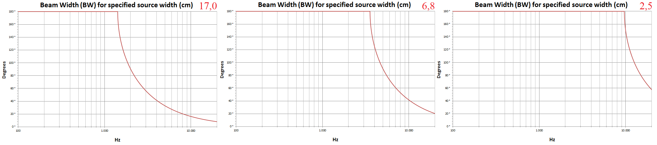

Yes, I'm sure my big 8" full rangers are beaming a lot more than wesayso's little TC9s. Compensation will be different.
I never had much luck with target freq responses (too "dull" to "heavy" etc...) until I changed my EQ curve from the inversion of a 4 cycles prefiltered response, to the inversion of the freq response envelope of a longer (8-12 cycles) prefiltered response. Now I seem to do well with a downward "tilt" on a linear freq scale (attenuation doubles with each octave increase). It's fairly close to the Bob Katz "knee" target. I'm going to be moving to a new house in the near future; it will be interesting to see how this method translates to a different room.
