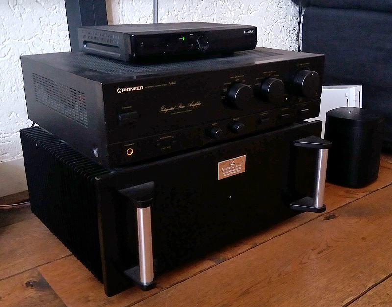

Meanwhile, any suggestions on amps to use for 4 ambient channels, of about 60 watt each? I still remember the Fetzilla with fond memories 🙂.
If it would not go against the grain, how about a Home Theater amp? 5.1 is all you'd need.
Last month a picked up a lovely old Yamaha 7.1 receiver in a thrift shop for $25. That was a super lucky find, but they are out there for not too much money.
It certainly crossed my mind. I might look in that direction. I'm super pleased with the main amp, but would have no problem to use this kind of receiver for ambient duties.
In a way I want to keep the visual impact in our room to a minimum. I'm still thinking where to hide the sub amps too.
The gear stack I have now is simple and I'd like to keep it that way.
attachment.php
(I should have dusted them off before taking the picture 🙂)
