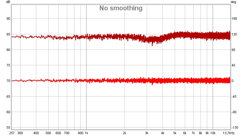

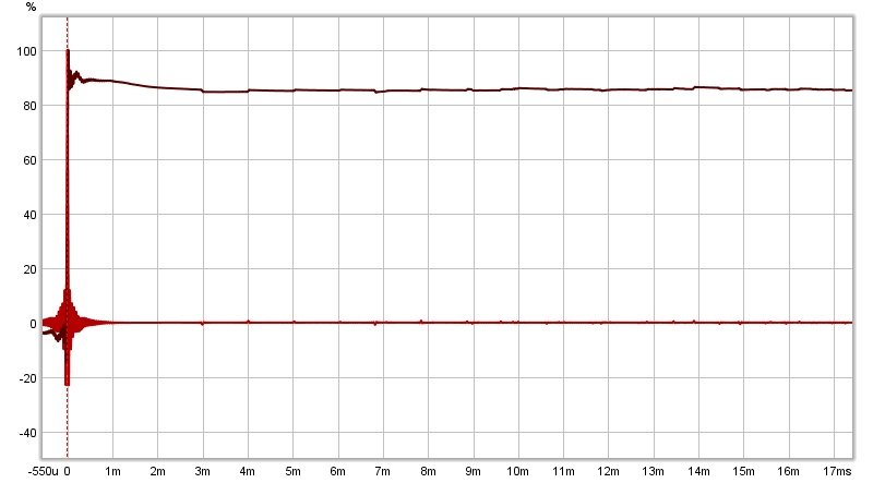

The experiment with the Random Delay Plugin was short lived. However hard I tried, I could not get a pleasing balance in my vocal parts of the phantom center.

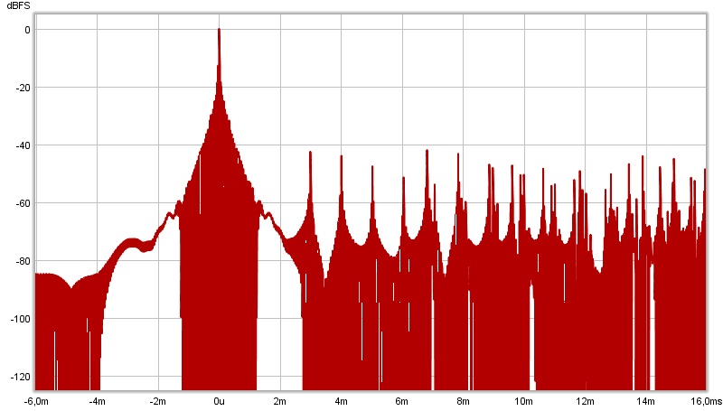

I tried something real off base, using a reverb, set to 3 ms pré-delay and as short as possible. Just a hint of this had a remarkable influence on the perceived balance. Way more than I expected.
An IR (presenting dBFs) with this hint of reverb looks like this:
Notice how the peaks are below -40 dB compared to the main signal!

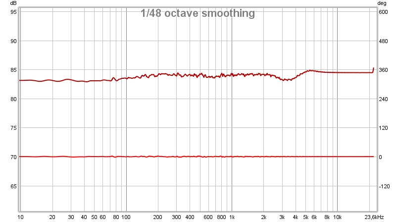

Within the frequency graph it has this result:
See how it creates this random series of peaks and valleys? While the average of it is still exactly the same curve as without the added reverb.

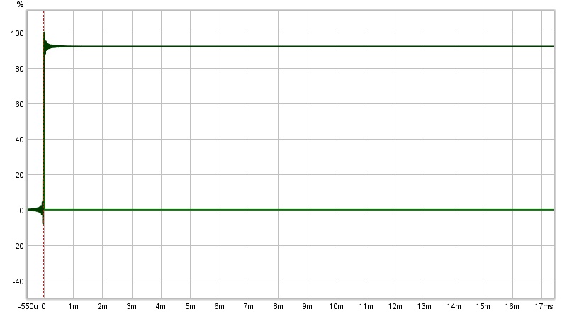

The reverb starts at 3 ms, as can be seen in the IR (Dirac pulse fed trough the JRiver DSP)
See how small those wiggles are from the reverb, starting at 3 ms?
(the build up around the IR is due to the phase linear EQ that's included in this DSP signal. it's very high frequency only,
usually it doesn't show up in my measurements as the drivers fall off above 18-19K)

One more graph to show the subtle effect of the reverb, here's the same graph, now smoothed at 1/48:
The larger deviations from a straight line are mid/side EQ tweaks to make it sound as the sides, tonally.
Much less EQ than I used before, but I still need way more time with it.
So far I'm impressed what the effects can be of such a subtle tweak. No wonder we hear big differences between certain setups
that seem to measure pretty identical.
