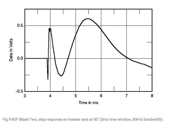

So, if I may get you guys distracted for a couple of posts....
I've seen someone say this is a great step response... It's a 3-way. Inverted tweeter, mid-woofer and bass woofers.
I thought a great response would be time aligned and coherent, which, to my eyes, this is not.
Why would someone say this step response is perfect?

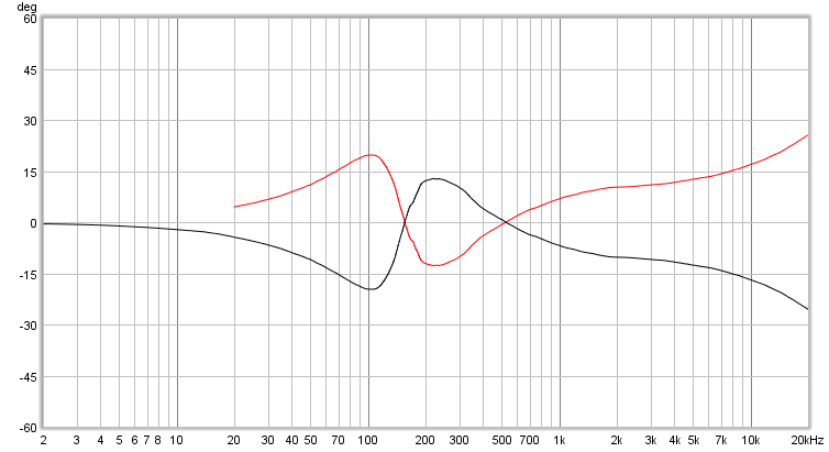

Which one are you meaning to inverse? Red or black? I'll await patiently, take your time :).
Was probably too fast there, red is phase from your left speakers Z curve plot long time ago when we played around with passive motional networks, black is my reverse work so left tower convolution filter is ready and i'm about third way into right towers insane filter :).

I think that's a pretty good STEP response, for a 3 way, passively filtered. The tweet/mid etc. hand off pretty good to the next driver.
See this thread: Group Delay Questions and Analysis for an excellent example of a STEP, as measured at the listening spot of a Troels designed speaker with second order crossover in a more than great room.
If you look at an APL_TDA plot of that speaker you'll see what the wave front does over time.
That graph was taken with a STEP that was showing an excellent hand over with second order slopes. The STEP you showed will have the graph even more stretched out, the lower you go in frequency.
There's a lot of debate if this is actually audible or not. The ideal transducer would look like this:
I recognised that shape :). But I still do have that compensation network in place.... In fact, my FIR filter is created with that network in there. Would that not counteract what you would try to demonstrate?
There are small differences in FR (and phase) if I take the compensation out.
The only thing I did remove was the high frequency zobel network. So my electrical phase curve still looks like this:
(that's what the Goldmund clone sees anyway)

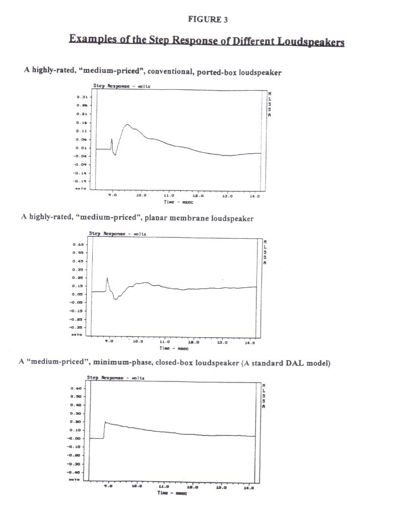

I don't care if a large part of the community thinks otherwise. I do like the view Dunlavy had and agree with this view. A deviation in time is still a form of distortion of the signal.
From his paper Loudspeaker Accuracy:
attachment.php
This bottom example shows a true STEP as measured from a DAL speaker.

Here's another recap on STEP I found online:
Loudspeaker step response measurement and explanation – Audio Judgement
