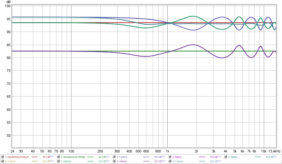

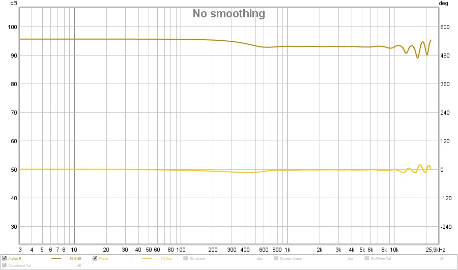

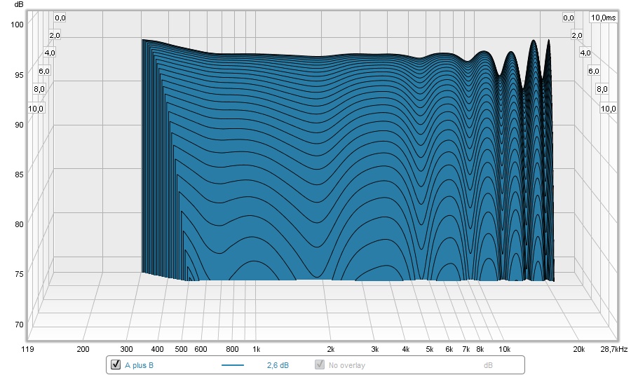

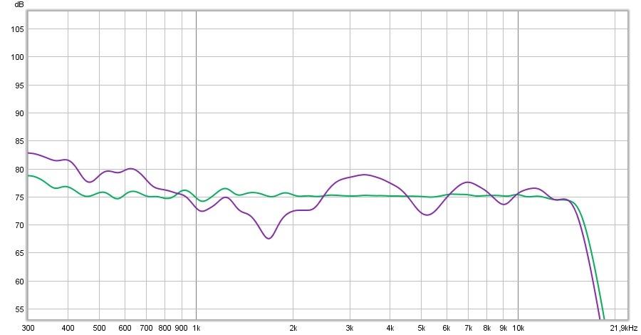

Back on track, a little more info about the mid/side EQ (concentrating on mid for now).
I've done a few simulations, as I don't have the house to myself, that's about all I can do.
The previous message on this topic showed the sum of two EQ-ed streams, one representing the main signal, the other, 11 dB less in level the later arriving cross talk. Minimum phase EQ.

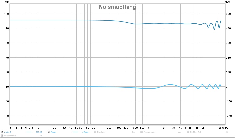

Let's see Frequency/Phase:

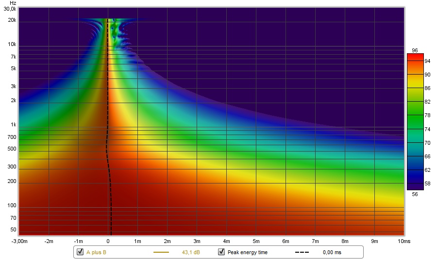

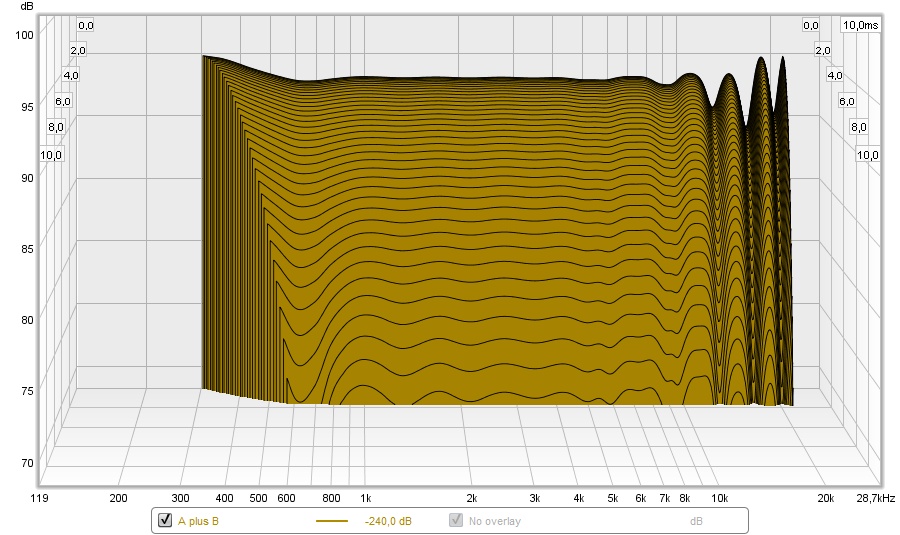

And spectogram/wavelet data:
I altered the EQ mode from minimum phase to linear, to see the differences:
Frequency/Phase:
And spectogram/wavelet:
So, the end result FR curve looks identical, except for it's phase trace. The spectogram/wavelet shows the difference the most clear here.
With minimum phase EQ we can restore the phantom sum of main + cross talk back to it's original shape. That is, if we know what the sum looks like.
Another thing to note is the phase wiggle from where I stopped EQ-ing the lower region. My dummy head showed way less head shading there, but the ears actually sum (no dips) at both ears plus that cross talk gets added.
So it will be interesting (to listen) where to stop EQ-ing.

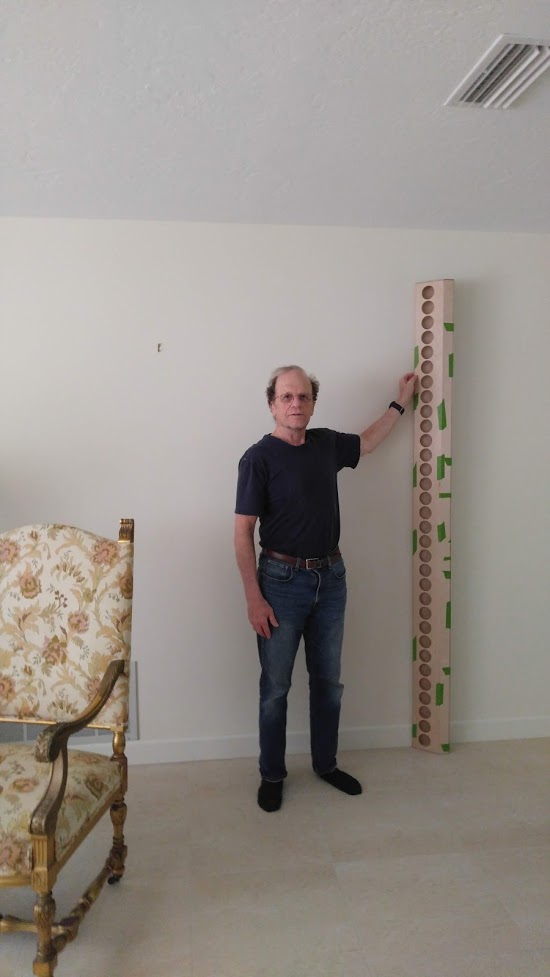

I have very little room inside for wires but I have a removable panel.
Ah nice! That will make things easier
Found some foam heads in a local store. I could get you one...
2nd photo is my status
At least get yourself a few, if they are affordable
Looking good for your project! Take your time to get it as you want it. It will be worth the wait.

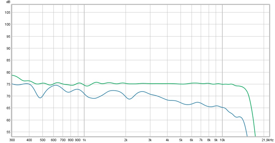

About 3 hours ago, when I was in a bit of a hurry, I typed up a long progress report. Only to loose it due to my own stupidity. I was trying to make the graphs more readable and switched a bit to often between screens (closed the main).
Anyway, what I was trying to say, the cross talk level is actually a bit higher now that I've had a chance to EQ at head/ear positions, here's what I measured at the right ear, featuring the main signal and the separately measured cross talk from the left speaker at that ear:

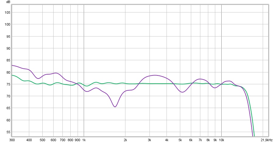

Obviously I've also measured the combined result at that ear:
Both graphs above represent a 6 cycle window, no further smoothing.
It's easy to see the cross talk being quite high right at the point where it has the most influence. Obviously this wasn't my exact head, so it's easy to see some fluctuation in these measurements in the exact amount of shading.
If we look at a longer window, lets say 20 cycle, smoothed 1/6 oct it looks like this:
That's where the room treatment and array behavior show their strengths. It's almost a spitting image for the graph above with the 6 cycle window.
This won't happen in a room with lots of early reflections. It's also the root cause which makes it possible to clearly hear this phenomenon.

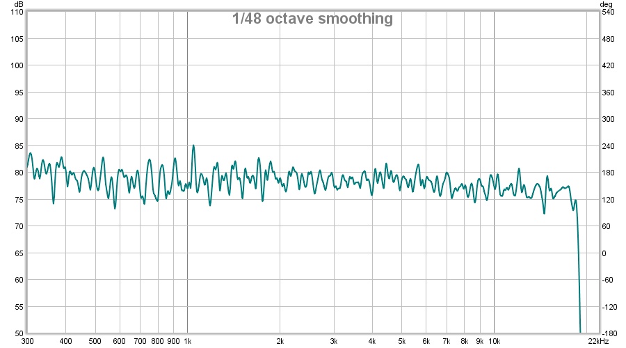

** maybe I should put up a warning too, that these speakers don't bend off that wildly beyond 15 KHz, but these graphs sure make it look like that **
A 500 ms window with 1/48 smoothing might show that it continues beyond the 15 KHz figure:

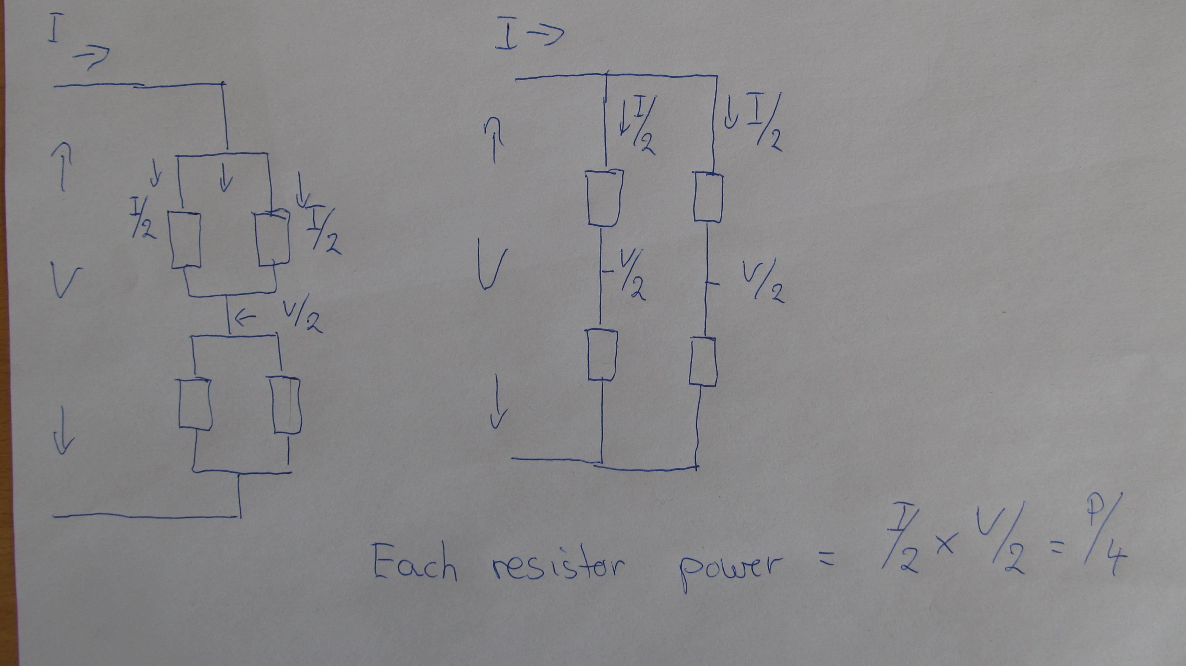

I am not sure what went wrong in your sim of this , and I have not yet gone through the schematics of the two situations, but your conclusion is wrong!!
No matter how you wire them parallel/series or series/parallel each of the speakers will get 1/25 of the total power you present at the total array.
When I look at such problems I always try to take a simple example to show how it works. 4 resistors can be put in parallel/series or in series/parallel and this shows what happens. Dosent matter how many you are dealing with, the situation will be the same. This is Ohms Law and no sim software is going to change that IMHO
