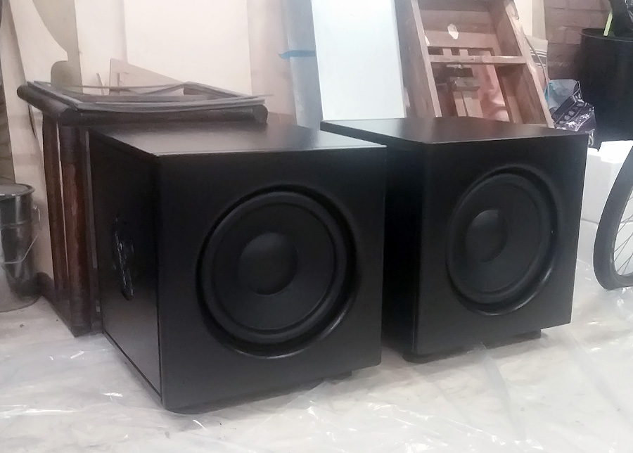

Good to see that the subs in Assen are about ready (I brought the amplifiers for these quite some time ago... 😉).

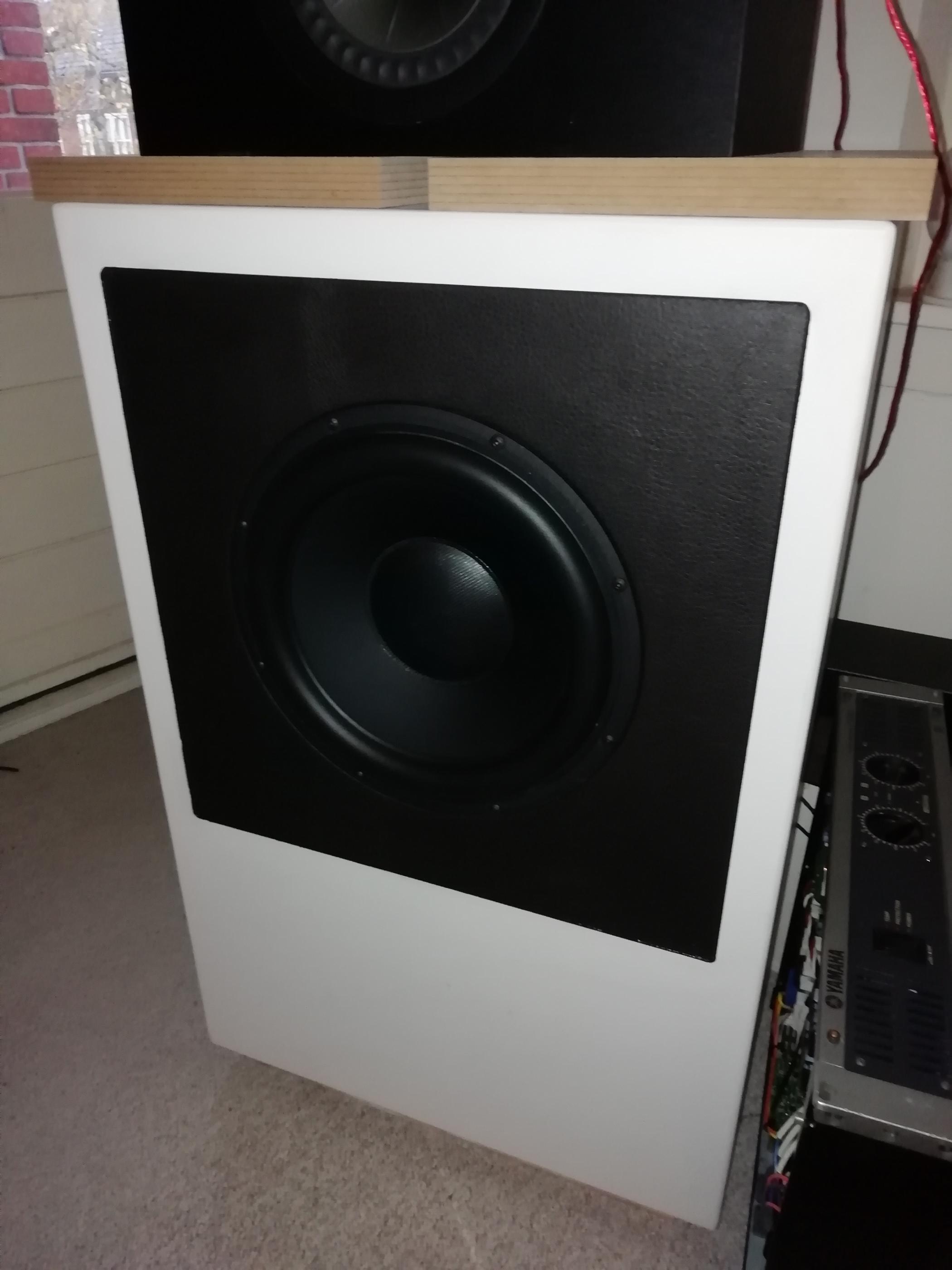

This is my 30W implementation:
80 liter aperiodic; enclosure made of 30 mm beech (not birch) ply.
After numerous OB experiments I now have the bass (impact) I do not want to miss anymore.
