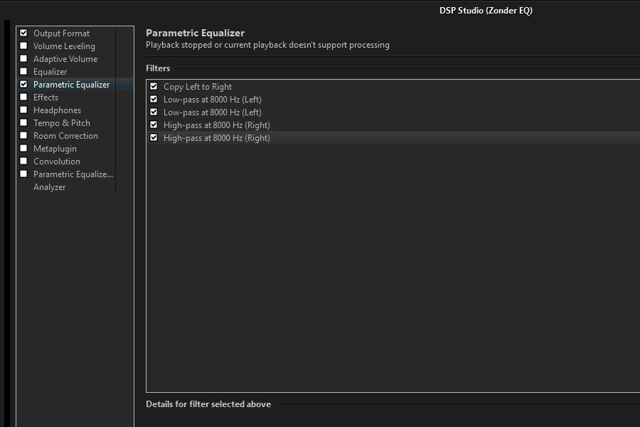

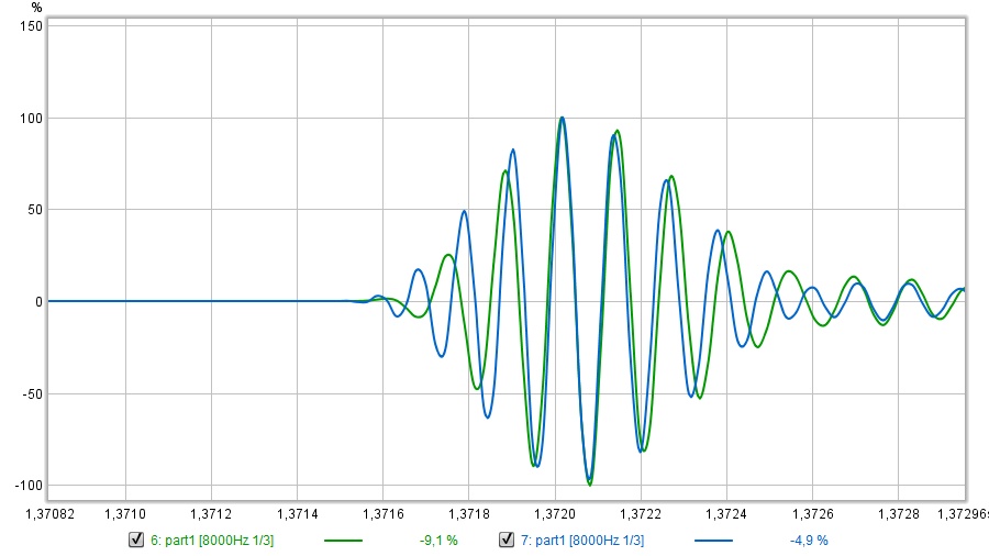

Due to a question raised by Mark100 over on another thread I decided to play a little with the crossover function in JRiver. I haven't had a use for it but was curious enough to see what it does. As Mark seems to be a fan of things like LR8, I figured I'd try and see how something like that does at say: 8 KHz.
So I made a little test inside JRiver (version 22 by the way, I do own version 26 but haven't used it yet):
attachment.php

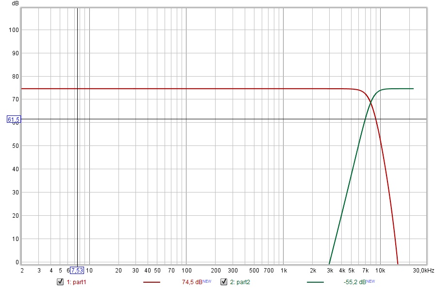

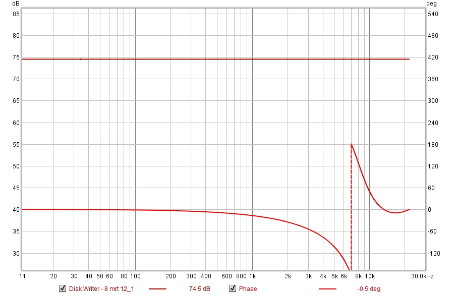

If we look in REW, after recording a Dirac pulse to disk we get this view of the frequency traces:
attachment.php
Filtering it with 1/3 octave at 8000 Hz shows us this:
attachment.php
attachment.php

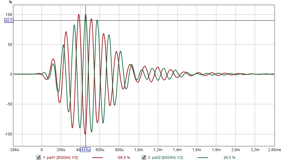

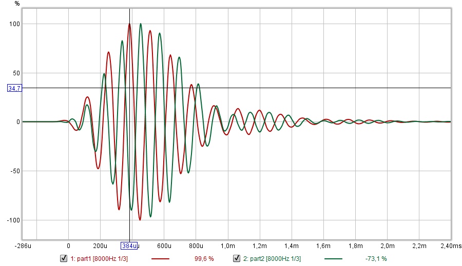

So there's a 0.07 ms difference between the two. I figured I'd have to delay the high frequency by 0.07 ms inside JRiver to get a perfect sum. Let's see what happens:
attachment.php
What do you know, it looks exactly the same... nothing happened. Then I remembered I have REW configured to set the impulse peak at 0. So that must be why I get exactly the same results here.
Importing both original traces again from example 1 with REW set to look for the first sample:
attachment.php
A perfect sum!

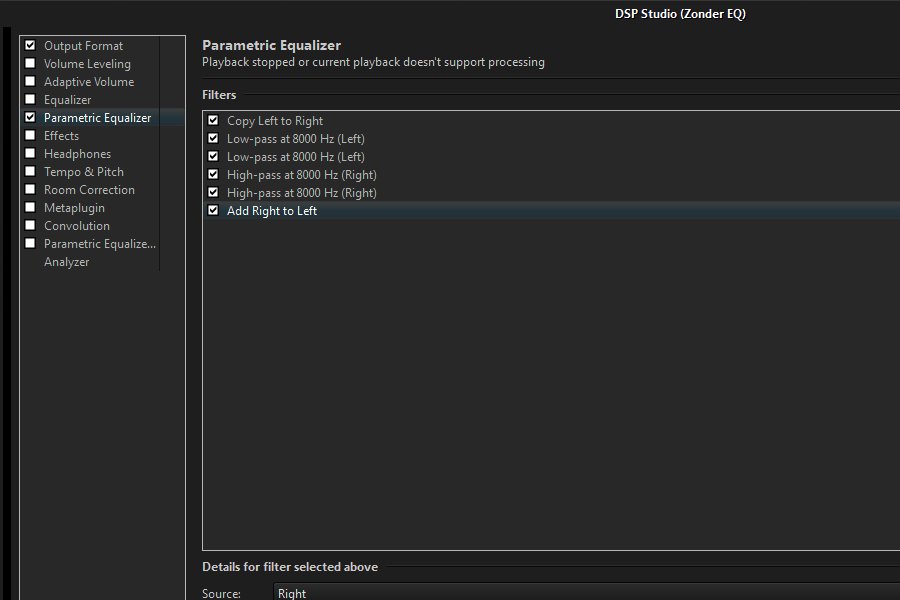

So if I were to add the right channel to the left, after these crossovers, without using any delay like this:
attachment.php
We get this as the end result:
attachment.php

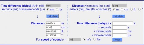

So when you set a crossover inside JRiver, in this case I used 2x Butterworth 24db/octave to get the LR8, it will sum together perfectly. So if the drivers acoustic centers are aligned, you'll get a perfect summed crossover.

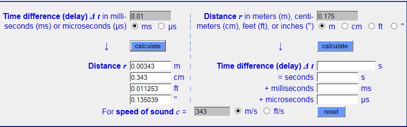

JRiver's smallest delay is 0.01 ms, in real world distances that would be:
attachment.php
So that is just slightly more than 3 mm.
I'd say it will be harder to get your head equal distance to 2 drivers you're trying to sum than it is to get an acceptable sum in JRiver at 8 KHz. 🙂
823324d1583672963-towers-25-driver-range-line-array-8000lr8-jpg
attachment.php
823333d1583676307-towers-25-driver-range-line-array-distance-jpg

Hi wesayso, a few things....
First, I don't know why we would ever question if JRiver can handle LR xovers (at any frequency).
I would think of course it can...whatever types and orders of xovers it lists, I would expect it handles them perfectly.
Where JRiver is lacking imo, is in the types and orders dept.

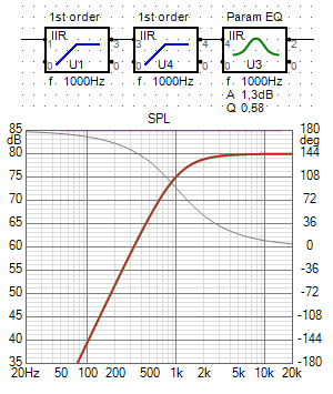

Odd order butterworths (beyond 1st order) are missing.
You can't cascade a BW1 and a BW2 to make a BW3.
(3rd order BW's are quite often helpful with subs, both as a hpf and xover.)
Bessel, perhaps the third most widely employed xover type, is missing..
Also don't understand why timing would be questioned for the LR8 example you presented, given that LR's are fully complementary and don't need any timing adjustment to sum correctly.
Unless maybe the point was to show how looking at 1/3 octave bandwidth filter impulses aligns the two sides???
So to try to figure out what/why you were showing, I replicated the experiment using live processor outputs instead of two filtered dirac pulses.
And your method of aligning the 1/3 bandwidth filtered impulses was the only way to obtain flat mag summation and a correct phase trace.
Neither REW's All SPL Time Align, or Align IR start, would do it.
Not any form of measurement, loopback with or without offset. Apply est shift.
No timing reference: Set peak to t=0, Set IR start to t=0.
Nothing provided spot on summation. ....whew..
Don't mean to be a freakin parrot...but bwack ! simple phase traces work !
The need for fine timing doesn't relate to head position at all really.
It's simply about the phase alignment of two drivers (on one speaker 🙂 sharing the same bandwidth.
Take the 8kHz example. One cycle, 360 degress, is 0.125ms. So 0.010ms equals 28.8 degrees of phase. We know phase wheel summation.
That gives about +/- .02ms lattitude for practical full summation of coincident drivers at 8kHz.
The coax CD's i use cross at 6.3k, and my 48k processor can only time to the nearest .02.....but it works.
If off by more than 1 sample, a definite shift in the sound of pink noise can be heard and measured at any listening position (one speaker).
Whether or not it can be heard in music I really doubt, but I use steep xovers to eliminate the range of mistiming's potential effect.
So really, it's not about stereo at all....just good basic mono reproduction.

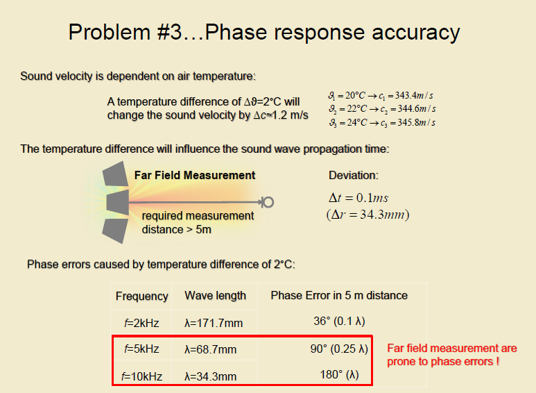

Ha ha Mark, nice discussions there 🙂
Think there could be more trouble with digital time allignment be 100% on cycle in phase wheel especially the higher the frequency is, see below Klippel note 🙂

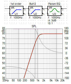

...Where JRiver is lacking imo, is in the types and orders dept.
Bessel, perhaps the third most widely employed xover type, is missing...
Copy below numbers on a piece of note should help set 2nd order Bessel or 3rd order Butterworth textbook slopes in Jriver, they my own hobby homebrew but should be 100% okay 🙂
Bessel 2nd order have frequency number relation of 1,27 relative to filter Bessel target setting, that is below example using 1000Hz number will be a 1,27x1000Hz=1270Hz BES2 target, and should BES2 target be 1000Hz then set below filters to 1000/1,27=787,4Hz:
attachment.php
Butterworth 3rd order:
