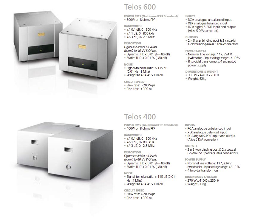

Here's a link to a sales brochure I came across with simplified specs of all models from the Telos 400 up to the monster Telos 5000: Sales Brochure - Dr Hi-Fi House Calls
A snippet:
attachment.php
From what I've seen, the 400 up to the 2500 are all very similar in construction. Moving up the power in each higher number.
Something that became way more fuzzy with newer models (except perhaps the top models in the series).

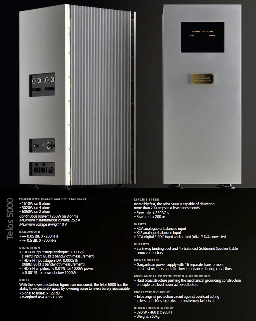

The Telos 5000 is insane though:
attachment.php
Way more detail in this separate brochure: Goldmund - Symmetry
Output Circuit
The Output Circuit uses an incredible 72 Power Mosfets,
which have been specially calibrated for the Telos 5000.
A NEW type of cascade/bridged circuit increases the
amplifier’s speed above anything ever achieved, even in
the other Goldmund Telos amplifiers.
I know, boring... :D.... but hey, I can't help being enthusiastic about these amps. There's probably many more out there that are worth listening to, but these (or more specific: one of these) really rock my world! :lickface:

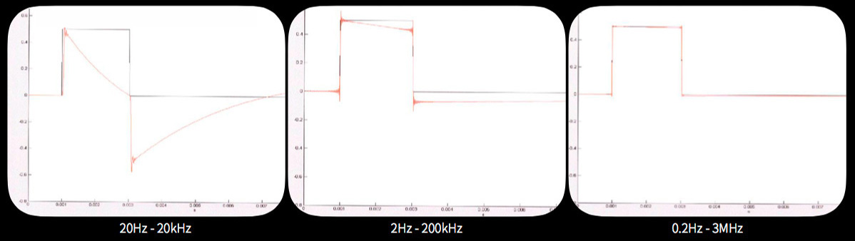

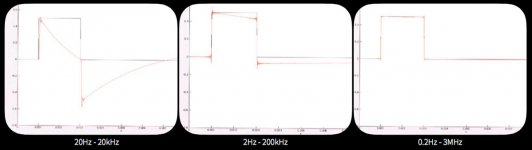

attachment.php
It's something that had my attention as well during my quest, which is why I wanted a seamless speaker without crossovers. I do know (and realise) not all think it's worth it, but to me it still is well worth all my troubles to get there. Pretty sure this isn't something that is easily 'repaired' or matched on a different amp using DSP.
If anything I still think that harmonics that line up create the beauty I love about this 'magic' mix. When you get it right, it just fills the space with atmosphere and a true feeling of being there. Realism. I've had it (the bloom of music) with the Pioneers and have it again (but even more promising as it is more detailed, real) with this new combo (and am sure re-processing my DSP parts will even make it better than it is right now, but for that I wait to get a 6 channel pré).
Maybe I've gone cuckoo :). But if that's the case I'm actually happy about it. :wave2:
