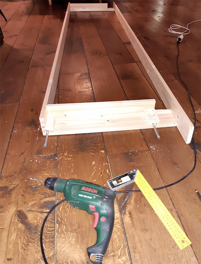

I used foam self adhesive window sealer that comes in rolls of tape in different widths and thicknesses because I mounted them the other way. No reason why it wouldn't work on the front. You can just mould it round the corners in one go and it squashes down to nothing quite easily.
(not my best effort at doing it but the only one I took a picture of)

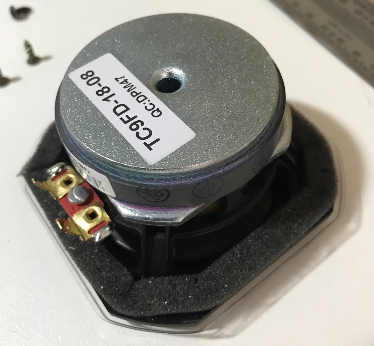

Thanks fluid and TNT. The front has a lot less space for sealing, but the 1.5 mm thickness neoprene will work. There's not a lot of room because of the drivers being close, so I keep it to a minimum. It's just a seal after all.
I might get some sorbothane to go around the bolt holes, I have to see what I can get semi locally, like in NL, DE or UK.
I actually have that type of foam on a big roll . I got several types the last time I had the arrays in pieces.
I put my trust in neoprene because it has stood the test of time. It will be some work, but it's worth it for peace of mind . Some of the door sealing foams I have used disintegrated within a couple of years of use. I know neoprene will last a long time.
I do know it's worth the wait and that's a good motivation to just take my time needed... I've been listening to these speakers practically non stop from it's creation end of 2014 till June this year... In various different setups (3 PC's have been used as the source, 2 different amps, lots of DSP trails along the way)

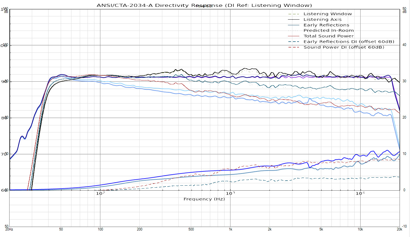

Over on Mabat's Horn Design thread, a couple of well rated monitor speakers were mentioned. As soon as I saw that Neumann KH80 DSP, I figured, I just had to compare it to my proposed array tweaks, simmed in Vituixcad.

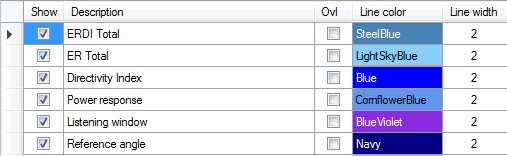

Here's the array (all lines in shades of blue) compared to the Neumann:
Color index of the simmed array:
How's that for a comparison? Not too bad, is it? This is just a sim though, and I sure don't have the means to test how accurate it will be. It did surprise me a tiny bit. The other two monitors mentioned had a bit more flat DI, but did show similar trends as what the simmed array shows. A gradual rising DI. Both more so than the Neumann, but the array, if it performs close to what the sims predict, wouldn't fall far out of place. Curious to know what you guys think...

I thought it was a fun comparison to the arrays as these are results from a large spinorama like Toole and Olive suggest, to pick out the winning formula of speaker designs. That's what a good speaker looks or rather measures like, according to their theory.
The Arrays do pretty good, I'd say. Knowing how they deal with floor and ceiling, and some other unique character traits, shows they do make a pretty compelling case for use in a home. They would have a shot in the JBL spinorama tests .
I didn't even look at the Neumann to see which model it is, it is about a $999,00 active model that surfaced near the top in these spinorama tests. I'll do a comparison to one of the Genelec's too, I believe that was a $6000,00 + model.
I'd say I've experienced a good test once, where the headphones we used at that time were quite a good match to the arrays. It was with the headphones BYRTT brought when he came over for a visit, for which he had a set of matching set of EQ settings. That sound came very close, tonally, to the arrays. But personally I just love the whole experience with imaging, great tonality and feel of the arrays, I definitely prefer them over the headphones, even though I immediately bought the same headphones BYRTT brought with him and have a good 'temp' substitute in them.
With the arrays, especially with the complete experience with ambient channels etc. it is so much more involving. It comes quite close to the feel of being there at times. I love that! (and miss it very much a.t.m.)

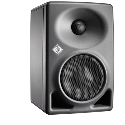

The Neumann KH 80 DSP:
More info: KH 80 DSP

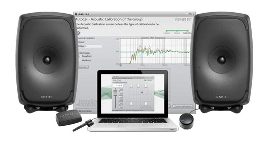

But the best one of the bunch according to the spinorama data should be the Genelec 8341A:
A set of monitors at just under $6000,00. More info: 8341A - Genelec.com
It's only slightly behind on the price/performance ratio index but wins big based on spinorama performance alone.
But look at it on the performance ratings chart: Preference Ratings & Graphs
(Preference Ratings calculated using Patent US20050195982A1, developed by Sean Olive, done by Amir Majidimehr of AudioScienceReview (ASR))
See: Genelec 8341A SAM™ Studio Monitor Review | Audio Science Review (ASR) Forum

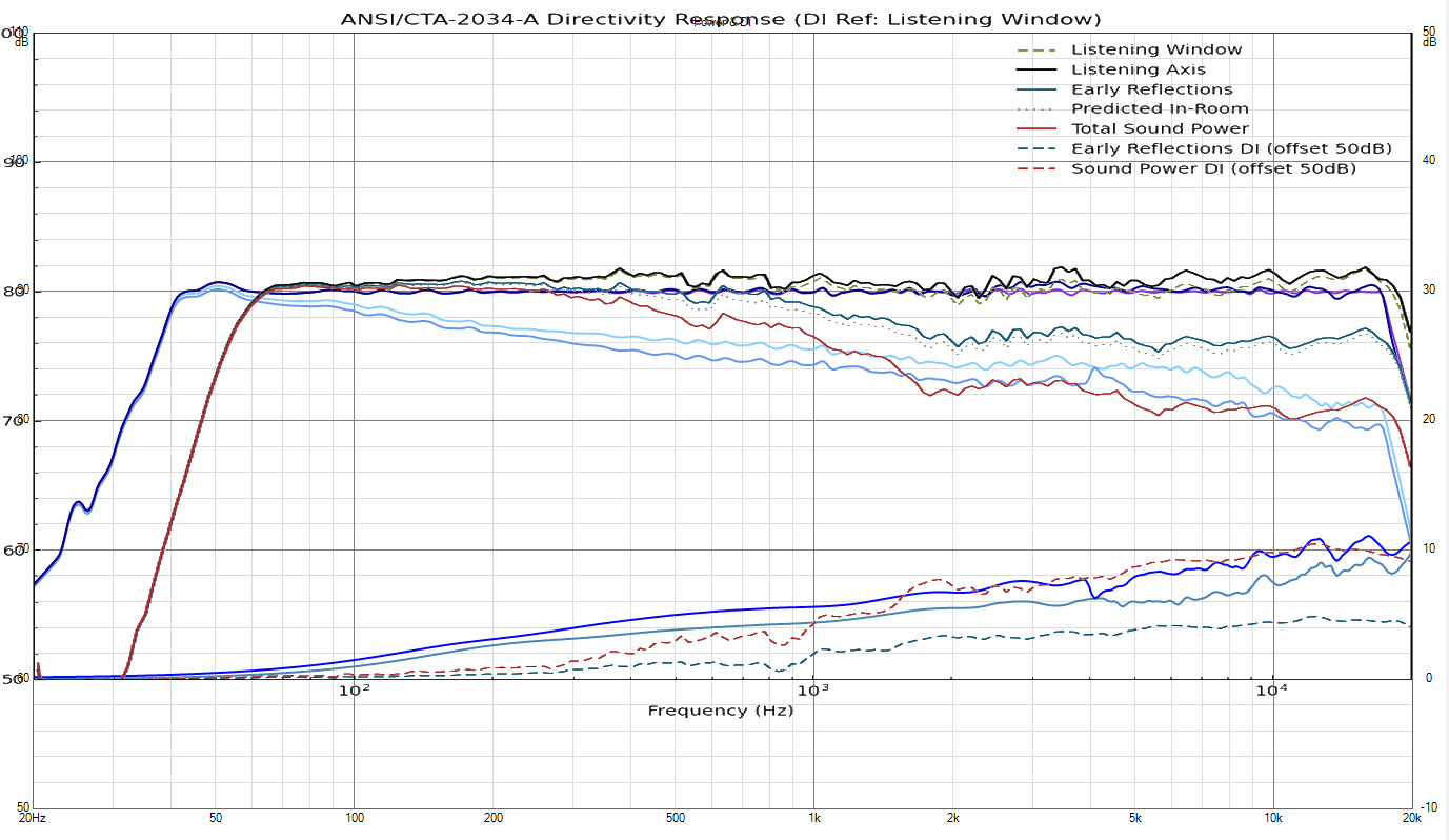

The comparison to that one:
Same color code used for the sim;
I think it's still not a bad comparison... The trends are quite similar, the DI of the array is rising a hair more compared to the genelec. But it's pretty constant and that's what gives those speakers the high spinorama ratings.

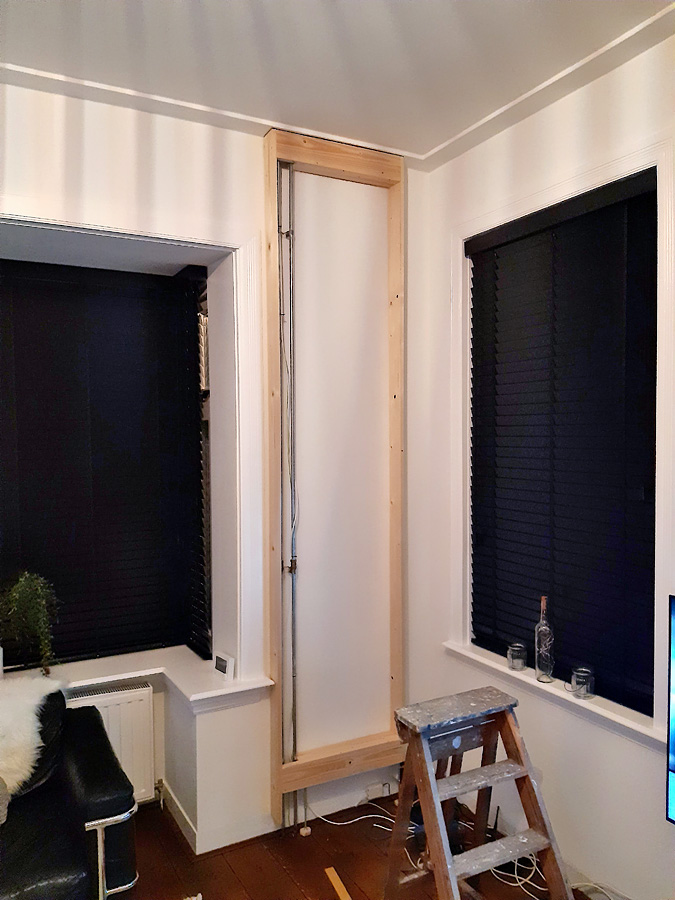

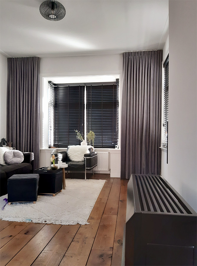

As my arrays have taken over my garage space, I had to build it up elsewhere...
Trial fit in place, the old panel will be re-used...
(Yes, I would have loved to get the panel all the way into the corner. Yet, that space is reserved for all the electronics that have to go somewhere, as in a modem, router and WiFi etc. The support for those devises will be part of the construction to keep the alterations of the fresh walls to a minimum)
With curtains in place:
That should do it... I'd say fit for coverage in a home styling magazine (lol).
I couldn't hang the curtains from the ceiling, a mismatch of beam placement and needs for the support. The wall was out to, as it is a fake wall before the outer stone wall with a (tiny) bit of damping between them.
So I made a self supporting construction to both hang the curtains and my absorption panels. Fixed between floor and ceiling. I'll fix it to the wall in two places for extra security. That's the only two holes per panel/curtain needed into the freshly refinished walls.
Oh... the things I do for a good sounding room . (the hardest part is to keep everyone happy, myself included)
