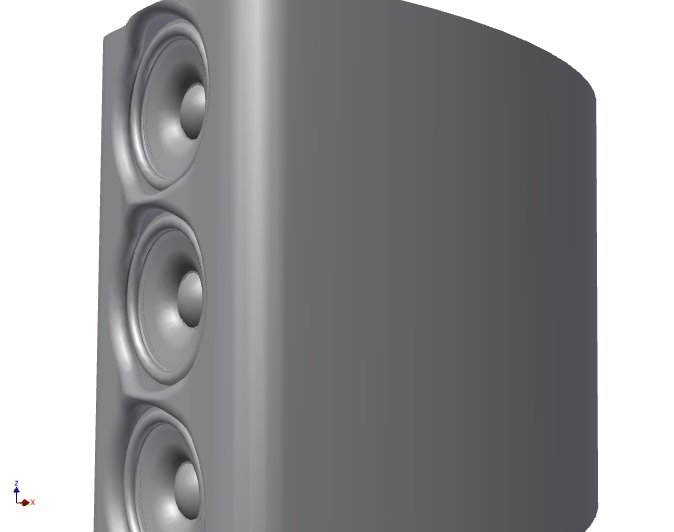

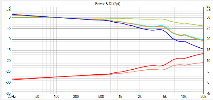

Maybe 😉 Here is my own enclosure modelled with the same vertical size as wesayso's. Disappointing enough to seriously consider V2 based on optimized directivity.
I've always had trouble getting 3 to 4K right and listening directly on axis has been better. I think these plots explain why 🙄

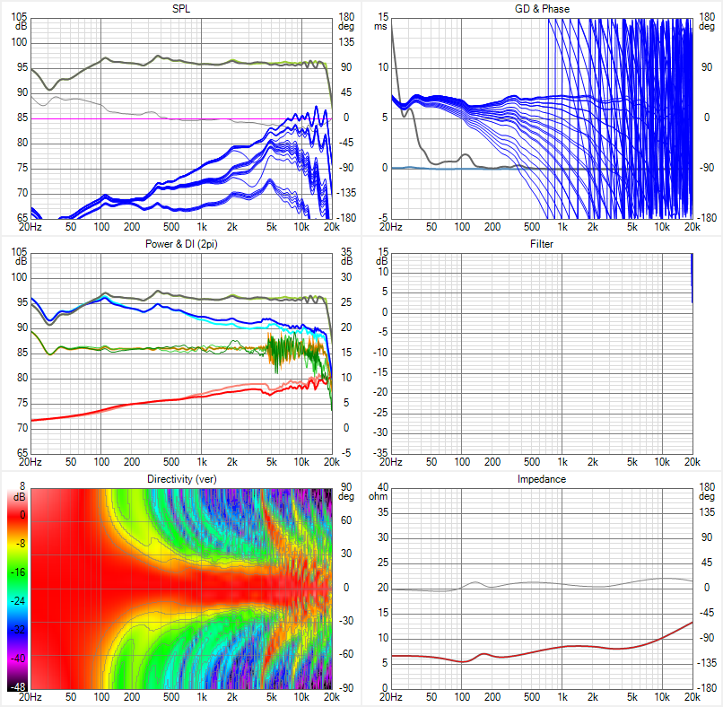

wesayso asked if I could change the range to go out to 20K. Unfortunately you can see from this that above 12K or so the mesh is not fine enough (among other issues) to generate reliable data and you get garbage. The driver is already at 4mm mesh, it could be finer for the single driver simulations but that would preclude going to a full line because the elements would get out of control. What might be worth looking at is a phase shield to try and do something in the 5k to 10K range where it is not as well controlled as below.
Not completely unexpected... it would be fun to be able to test the generated curves in Vituixcad though.
I'll send you the Vituix data to 10K, Vituix is pretty good at making up what doesn't exist 🙂 It will be interesting to see if this affects much in your overall Vituix model. As it is normalized it is already pre EQ'd. Do you want it normalized to 10 deg off axis?
This is what Vituix gives, see how it makes the data up beyond 10k. I might try the full line to see what I need to do to model it but then I will take a break, to concentrate on something I actually intend to build sooner rather than maybe never 🙂

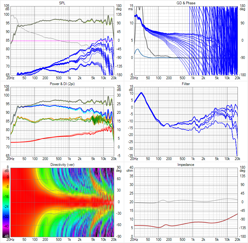

Just a quick try with the ABEC generated directivity:
attachment.php
Compared to the original simulation:
attachment.php
Not much differences, only minor. In fact, the FR curves are a little better, but as the drivers have a wider pattern, the floor/ceiling splash is a bit more intense too. Not much, but it's there. The pattern is more even with the ABEC directivity files. Off axis it is more controlled than our first data set assumed.
The idea behind the ABEC simulations was to find a way to limit the vertical pattern for each driver in some way, which would make the lobes less intense. We still have to come up with that part. But fluid does have other things he needs to attend to first 😉. I'm in no hurry and could probably learn how to do the ABEC simulations so he won't have to 🙂.

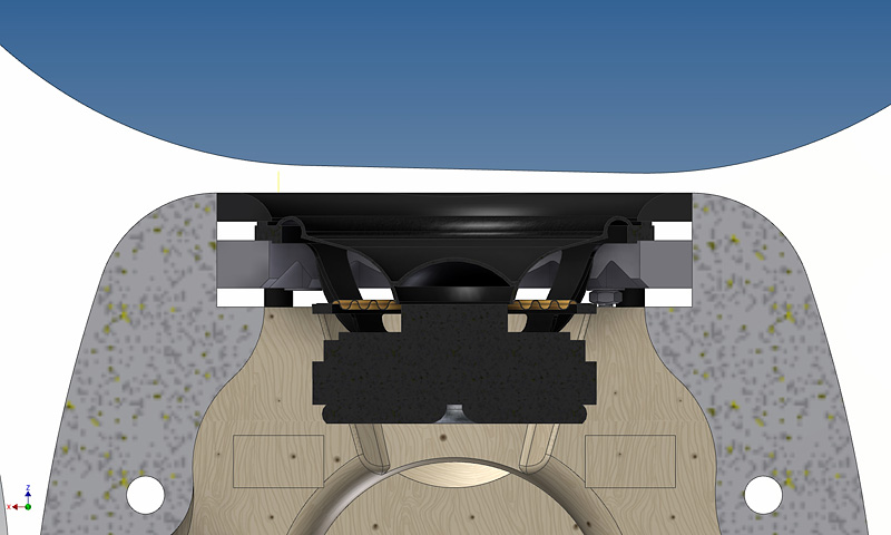

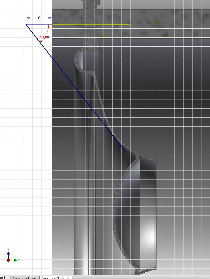

I figured why not try something like a E-JMLC, but folded back. As I've shown the shape of my current waveguide in a cross section (folded back), pretend this shape to be part of it:
attachment.php
But there won't be room (between drivers) for a rolled lip, so it becomes sort of a vane in-between the drivers, if one folds it all the way back.

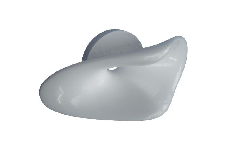

The horizontal vs vertical plots on this model do show the behavior I want to exaggerate. See: E-JMLC-1000 – Horns by Auto-Tech
See how the vertical drop is way faster than the horizontal is? Ideally I'd want that drop happen at ~3 KHz (or a bit sooner) to limit the energy going off axis in the vertical direction. Any drop vs what we have now is pure profit.
As we have seen, even a little horn (the 6mm back mount) has an influence. The cone in this situation is part of the waveguide, that chamfer is sort of an extension of that shape. Now all I need to create is a similar extension between the drivers that mimics the E-JMLC pattern control.
Does it make sense? :boggled:😱

Well, don't think of that horn I posted too much, I really hove it wouldn't have to look like that 😀.
I am trying to come up with something, looking at the cone of the TC9, and "pretending" to know where the frequencies of interest are coming from.
If something small can work, it could be OK. But I'm not willing to put large vanes on the baffle, even if it might work. I don't want to build reflectors, but guides.
Basically, the cross shape of the enclosure and especially back mount radius acts as a guide, what goes in the vertical direction is as wide as what goes to the sides. That should be limited somewhat vertically, drop off a little sooner, which the E-JMLC seems to do. So if the guide is larger (as in protruding from the baffle, making it more narrow) in vertical direction, it may have similar effects?

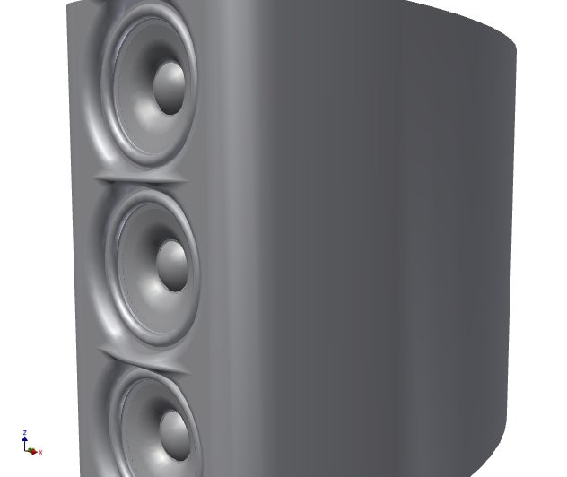

Let me put up a sample:
attachment.php
Another 6mm added, steeper curve than the roundover on the sides, still have to cut it and roundover re-applied, half round shape if seen from the top.
