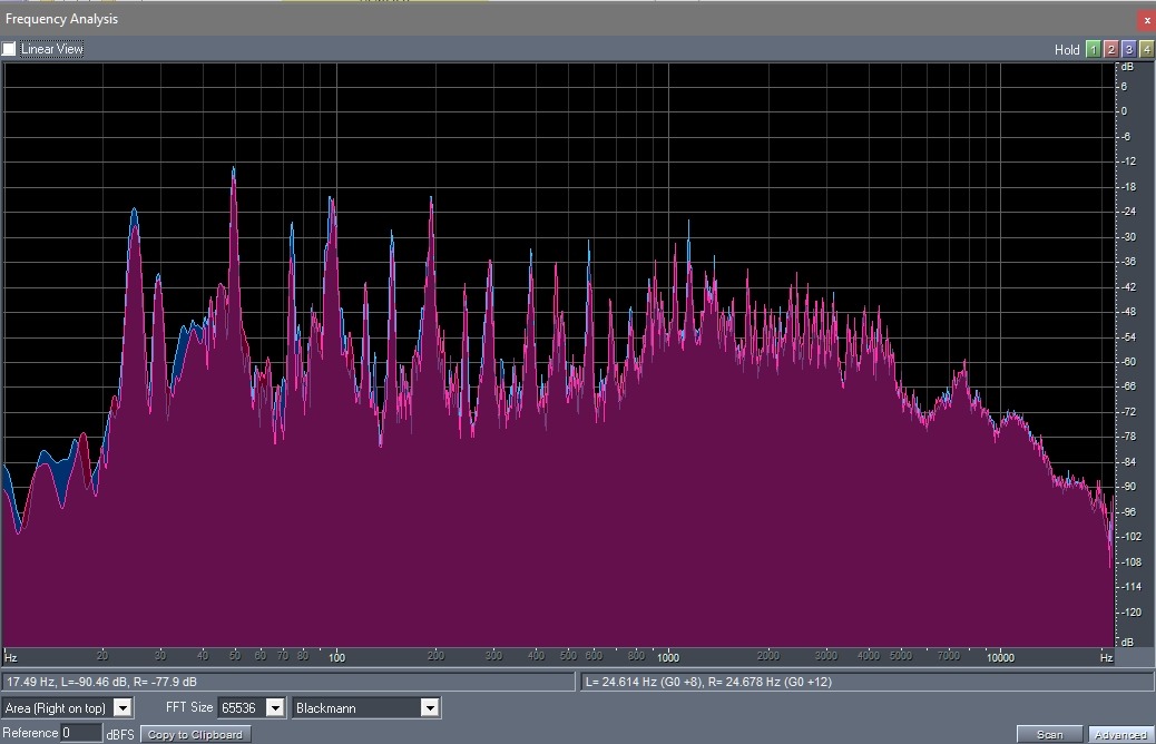

Takla Makan has things going on that I don't particularly hear but definitely can feel (in my floor boards and couch)
A quick frequency analysis about halfway the song shows there's plenty going on

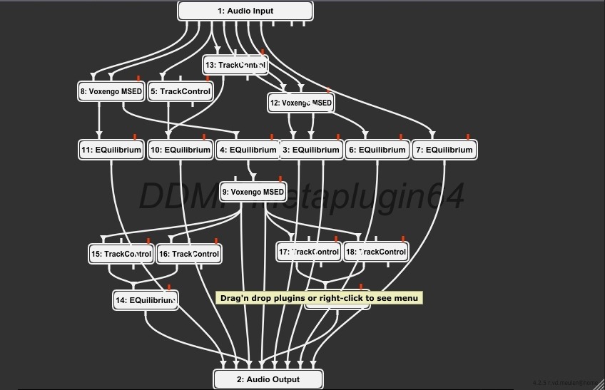

I've been experimenting a bit with my anti-crosstalk scheme. I wanted to apply it to the mid part, and not to the sides.
So therefore I split the Stereo signal into it's separate streams, L+R and L-R using a plugin to do the work.
As I though about it some more, I figured the mid or phantom center stream always has some left and right info in it, as it is a simple sum.
So I started experimenting with applying anegative positive impulse to both side streams, figuring it would leave me with a more pure left and pure right track, where the anti-crosstalk pulse is removed.
Below the last MSED one can see the added complexity of removing any anti-crosstalk from the sides. At least, that was the intention.
Upon listening tests it sure was fun on selected tracks. But other songs were sounding worse, not as convincing as before.
After removing the added side channel edits, it became obvious that the biggest difference was in depth perception.
Especially in the center/phantom part. Lesson learned.
So I started experimenting with applying anegativepositive impulse to both side streams, figuring it would leave me with a more pure left and pure right track, where the anti-crosstalk pulse is removed.
Additional info:
MSED is to split Stereo into mid/side or vice versa
TrackControl is a simple delay, I'm using two to fine tune exact delay as noted in a prior post
Equilibrium is a whole lot of EQ (lol) not as much as you'd think though![]()
This experiment did stir up my thought process again though. What if I added the crosstalk to the sides, namely the opposite side.
I think I can really hurt my brain on this. But something that was said in the ASR thread I linked above stirred all this up again.
I think I have a few more things to try
