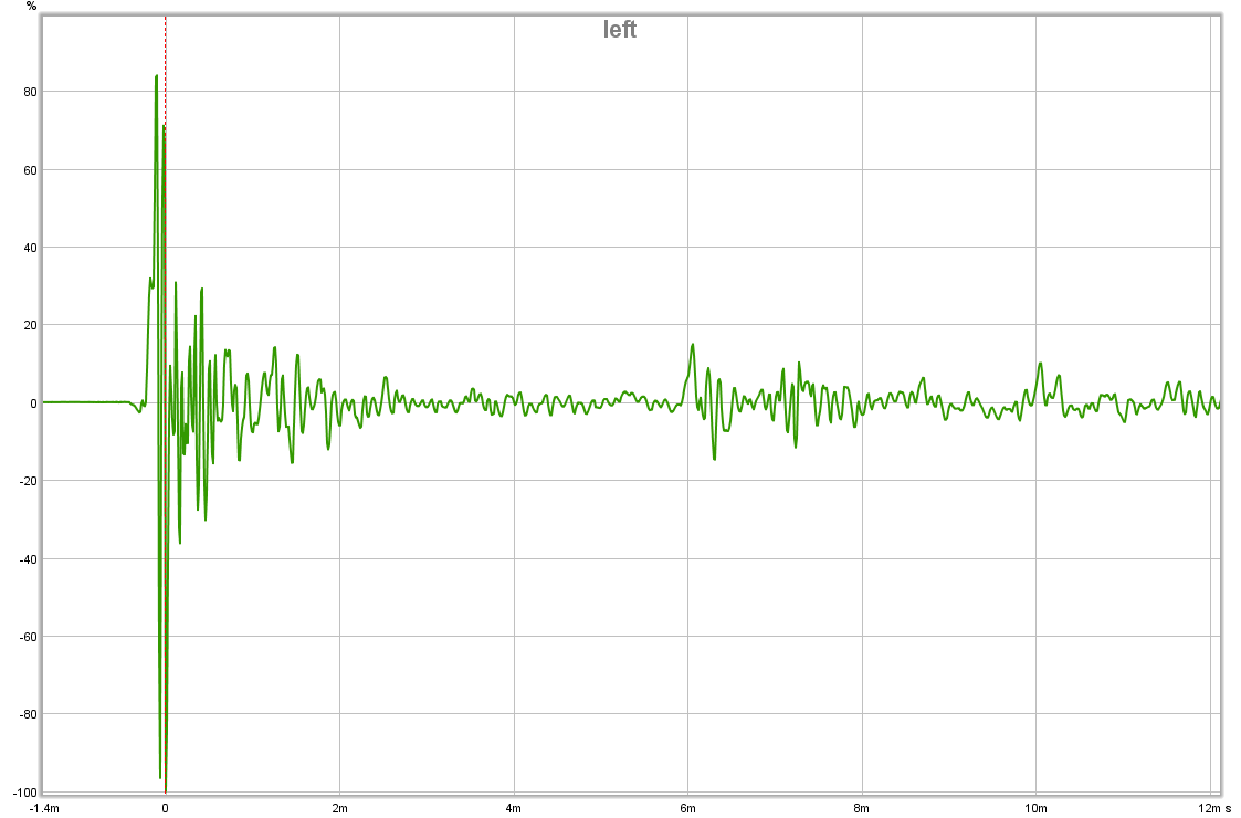

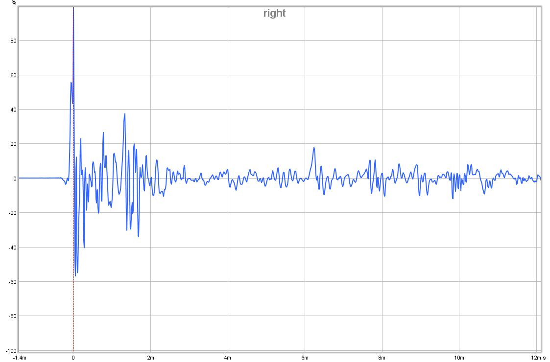

Just had a look at them and a few things look odd. Did you see how the impulse from the right speaker has a nice 100% positive pulse while the left one has more spikes and the biggest (100%) is downward?
Your stereo impulse has a second pulse at 7.38 ms that is not present in both the left and right channel as a reflection. Judging the Filtered IR it is down by about 5.7 dB from the main pulse. Don't know what to make of that yet.
If I hat to gamble the left speaker arrives first in the stereo file. It fits with the big reflection at 26.78 ms. Not sure when the right speaker comes in. Did you try to line up the pulses?

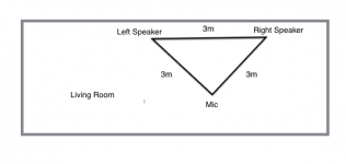

I'd trust the right impulse to work with DRC but the left one seems odd. Considering these drivers are both the same I cant figure out why their impulse are so different. You have both aimed at the listening position? Or at least toe in/out the same?
Yes, I am at exactly 3 meters within an equilateral triangle. Speakers are both toed in a bit, the only differences are that the left speaker is almost in the center of the room, standing next to a horn sub, the right speaker is towards the end of the room, next to a library. Here's a sketch of the room:
In that case it would be interesting to see what happens if you switch out left and right speaker. Just to see if it is the placement or the speaker that is changing the impulse.
I bet if you take 3 measurements of that left speaker REW would have difficulty to line up the peak. It's strange that the (biggest) left peak is downwards and the right one is up.

That left speaker response is tricky. The impulse center is 44098 (vs. 44100 for the right which is good) but even more importantly DRC will think it's 44103 because it assumes that the loudest sample is the center unless BCImpulseCenterMode is set to M (manual) and the center sample is input.

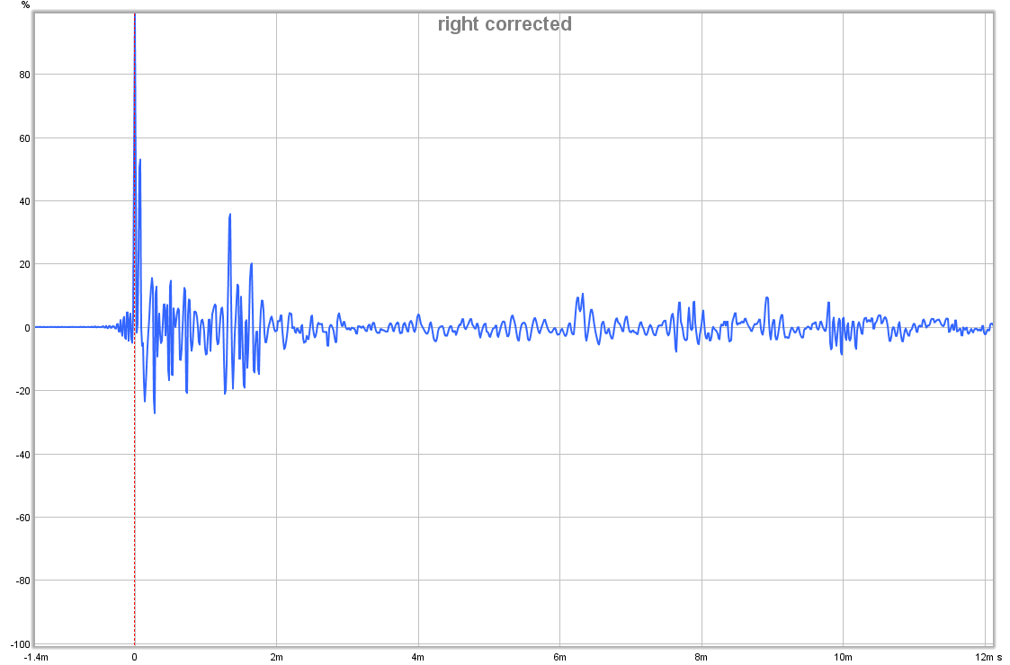

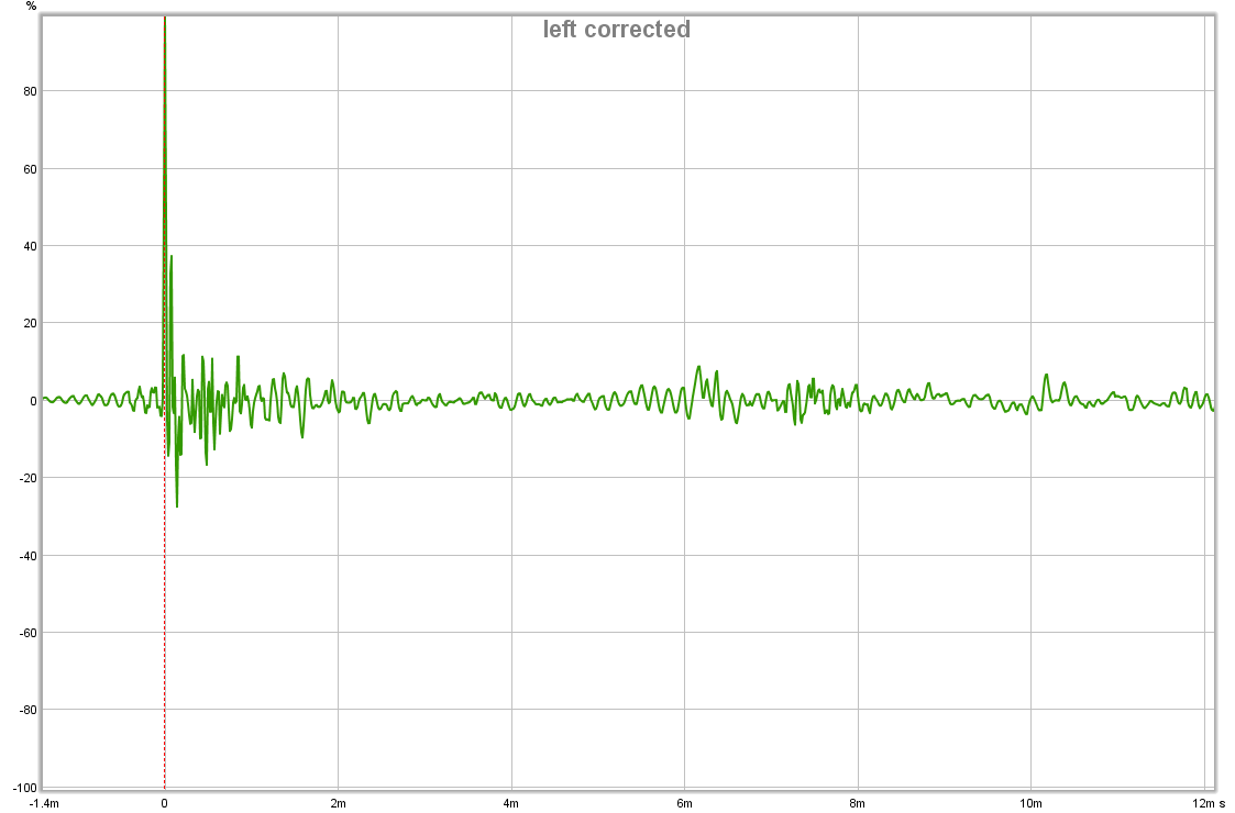

I went ahead and generated a correction filter. Perhaps perceval should try it out and if there is an improvement then I can outline the steps I took...
However, for best long-term results, I'm in agreement with wesayso about making sure the system is optimized before using DRC.
I used Audacity to perform the time shift on the left IR. Anyway, I'll show each IR before and after correcting with a very short (4 cycles) custom preset. The target response was flat with a first order highpass at 64hz. We'll see what perceval thinks soon enough...
