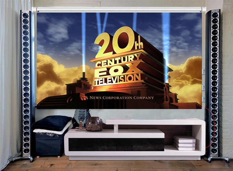

.... still the same impressive subwoofer underneath the TV...![]()
Really, it's the camera lens that schrinks my Sub and TV

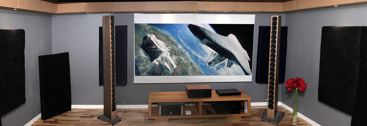

Here's the picture of his room (hope it's alright to post it
Do you guys notice the difference? I immediately PM-ed Halair to confirm...
