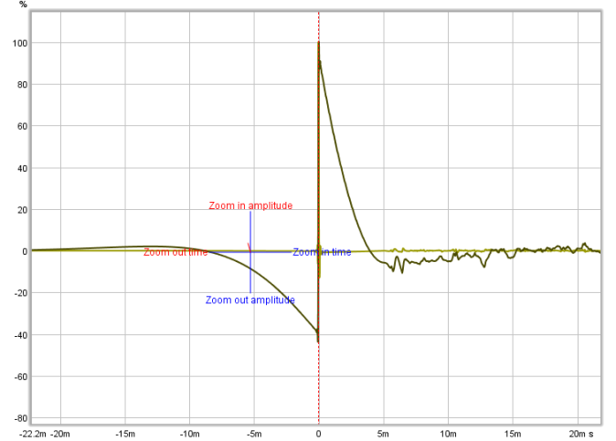

Let's not be shy here; you've got a linear phase system going. I can predict what your step response looks like left of t=0; please show -20ms to 20ms view. A pre-ringing exists of low amplitude in the impulse response; totally inaudible 99% of listening material and I believe it is good to show this in building general case for DRC, rePhase, and Kirkeby generated correction filters that work wonderfully when details are paid attention to.
Yes, great goings on here. Keep it coming.
Yes indeed, I finally managed to come close enough to my goal: the linear phase system!
With quite a bit of SPL capacity to boot! Here's the plot of -20ms to 20 ms:
None of the pre-ringing control in DRC was used here. I haven't noticed any so far.
I'll continue to work on this to try and clean up the signal. The peak at 6 ms, is the wall behind the listening position (much to close, but I have to live with it). However I might get it down more by a little more toe-in of the speakers (only a degree or two). I did test damping material besides my big poster and it helped to get that peak down. But I can't do much about it, not going to hang an even bigger poster 😀.
My planned ceiling swap (removing the metal ceiling) should have an effect too, but it has to wait a while longer. Life does have a habit of getting in the way of the things we want.
Looking nice; the negative step before t=0 does its thing. No pre-ringing control is needed with well crafted frequency dependent windowing. Seeing the waveform of it here requires zooming in amplitude to a fairly microscopic level.

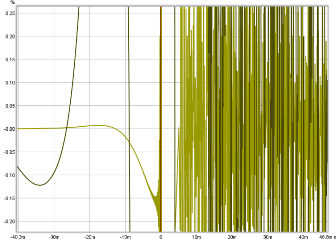

Here is -20ms to 20ms IR and SR predicted for correction filter allowing my TC9FD FAST top to make reasonable square waves starting at about 150Hz and looking good >3.5kHz:
Zoom in of amplitude reveals negligible pre-ringing; zero audibility when tested with music track. Intended use is in IMD crossover study, for which a posting will happen soon:
Indeed, microscopic zoom in is required to see the pre-ringing.

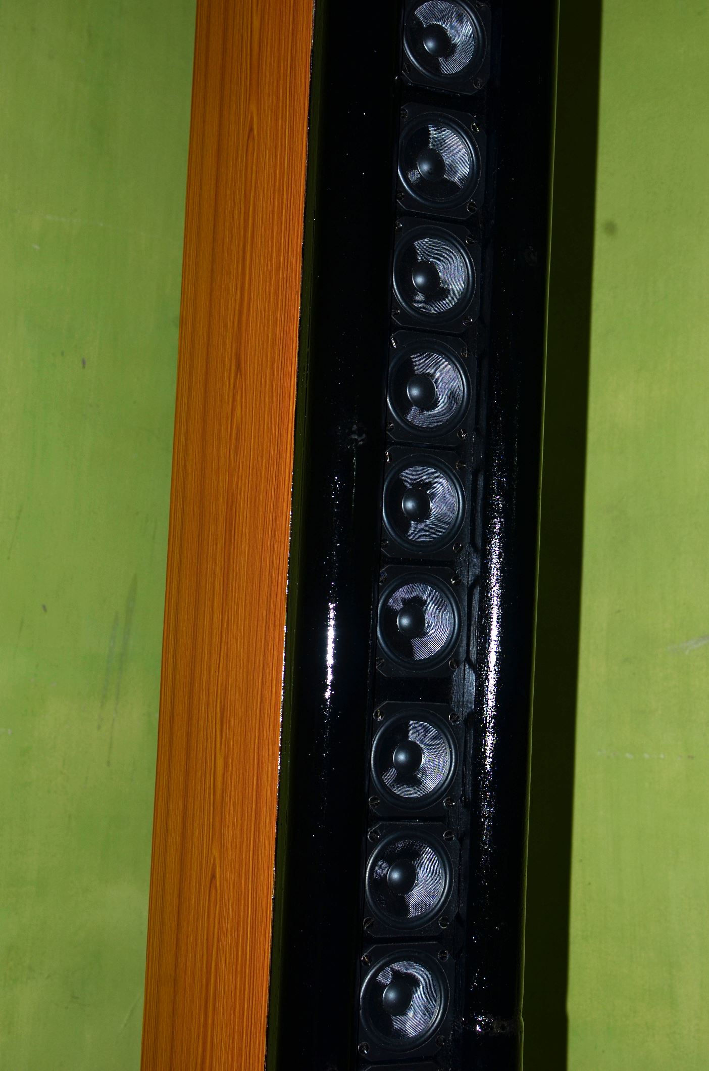

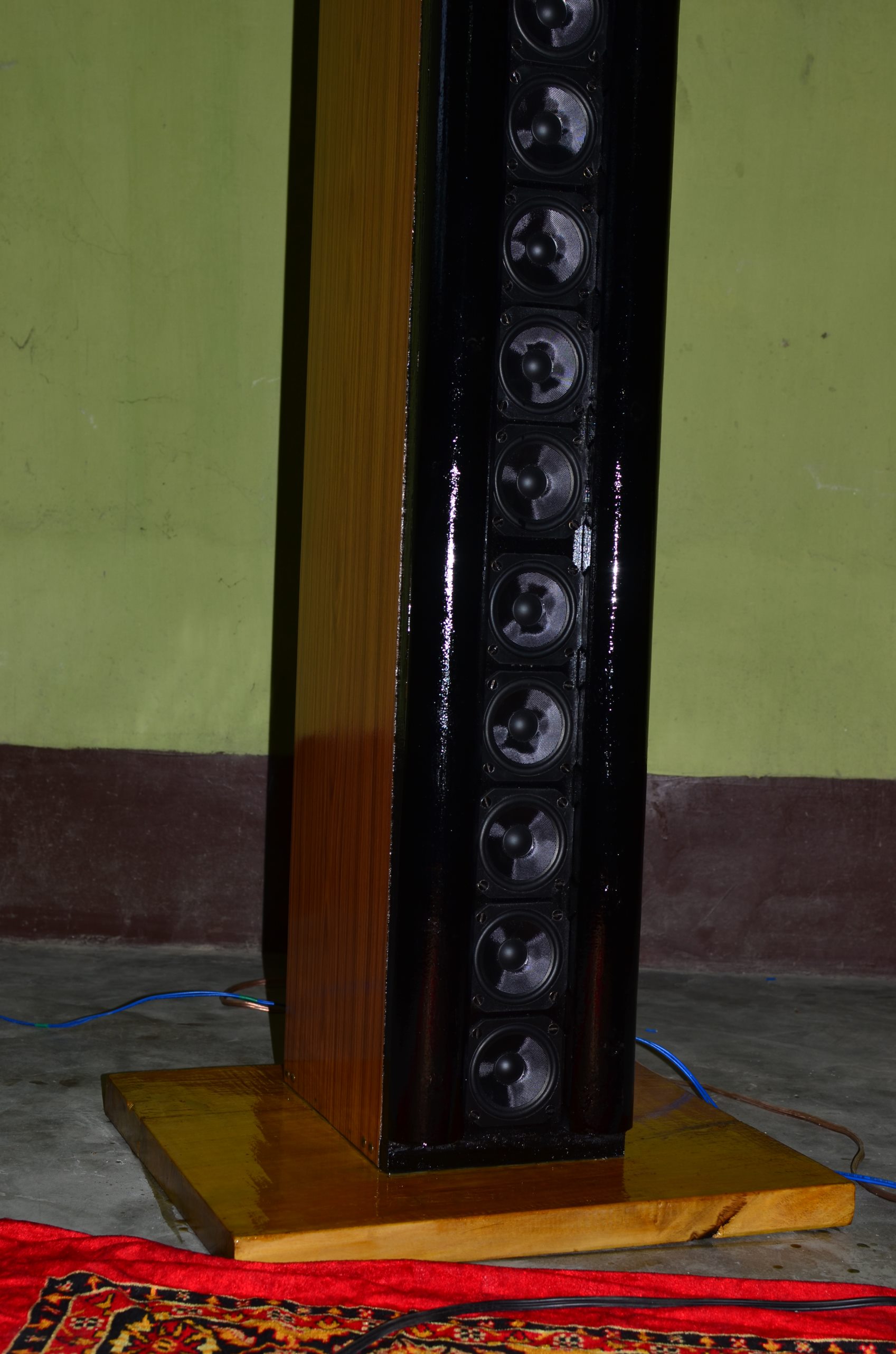

Finally my own version 🙂
Inspired by line array concept, I've just completed my own version.
25x per channel of 3.5 inch black kevlar coned Tymphany TPY03.

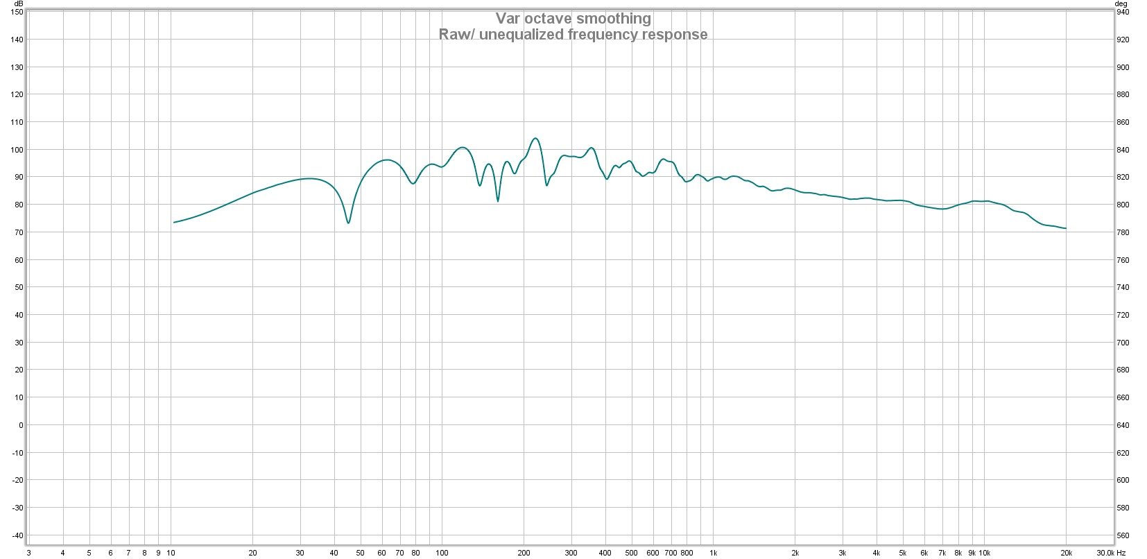

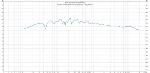

This is my initial test setup & measurements. I am using a car amplifier 😱
All the measurements are taken at 3 metres distance form the speakers, 15 deg off-axis.
Included in the attachments are an unequalized frequency response of the system, a full range frequency response/ distortion graph of the system equalized with miniDSP, a 90Hz & above frequency response/ distortion graph ( showing 90Hz at 107dB @ 3m with 0.31% 3rd order HD & 1.48% THD 🙂 ) & a RTA plot of a Metallica track playback showing a peak of 134.2 dB at 110Hz @ 3m

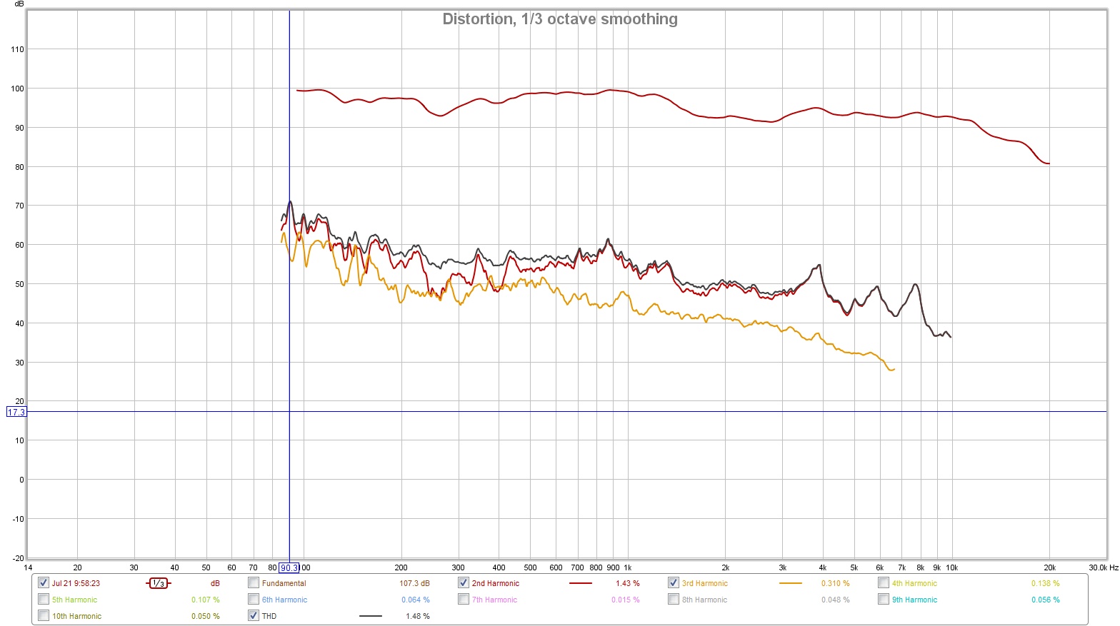

Definitely not.
Sound quality is really awesome.
I love how they don't hold back at all whenever they get a chance to punch!
Soundstage & imaging is awesome as expected. Its breathtaking how the speakers pull off the vanishing trick.

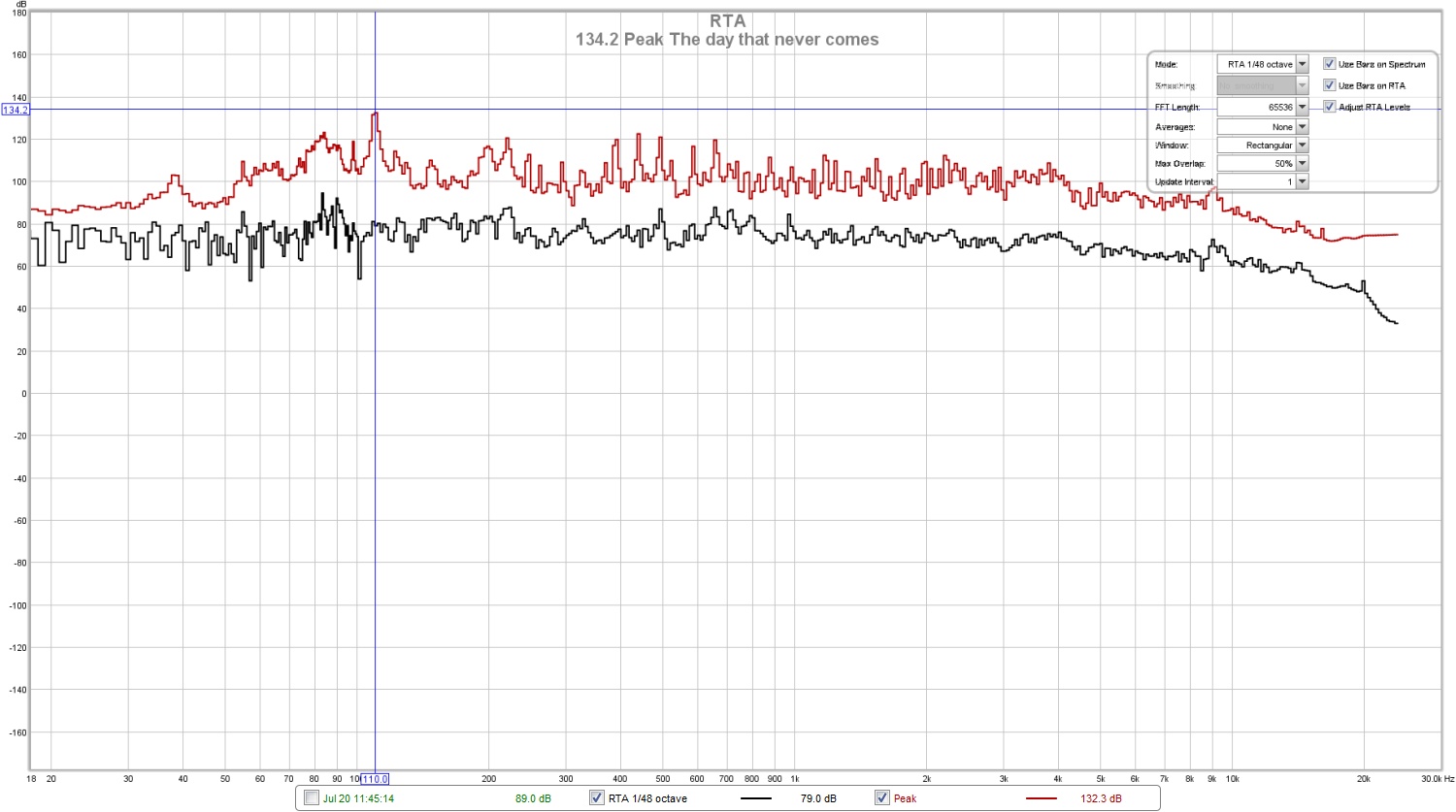

These are bass reflex speakers tuned at 20Hz.
Bass is awesome. My only problem is I don't have an appropriate amplifier to see how loud these can go. My sony car amp goes in DC current protection shutdown if I play too loud. still I've managed 90+ dB at 20Hz & 110dB at 100Hz @ 3m & the cones have still a lot to move.
Most interesting is the 134dB peak at 110Hz @ 3m I have measured.
Thats equivalent to 139dB peak at 1m for conventional point source speakers, right?
It can go definitely a lot louder with a proper amp 🙄

High frequency output is not lacking. Its in the range of the desired curve.
I can't care for 14KHz plus anyway, which seems to be my hearing limit.
