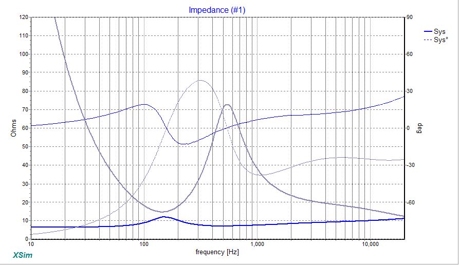

Here are things that indicate changes with an impedance correction network.
In REW I made impulse measurements. Based on that the components were chosen for the schematic I posted.
But if I look at the Group Delay of the impulse measurement I see this:
Group Delay plot of the original impedance measurement...
Group Delay plot of the corrected impulse...
Like I said, tiny differences. Don't look too closely at all the little bumps here, as they will vary from measurement to measurement,
mostly depending on sound (noise) level during the test. The peak at ~19 kHz is also always present with my impedance measurement laptop,
a very old Vista laptop from my son. But things like these differences indicate something is changing, as the sims that BYRTT showed indicated
as well, many pages back in this thread. Things like series and parallel resistors also make a change in these graphs. So to me it seems reasonable
to assume that sonic differences may occur. The quality of the components used may be a whole other chapter though. But I did use reasonable
quality components. Except for maybe the cored inductor. But it is operating well within it's comfort zone as far as I can figure this out.
Yes I can see improvement in group delay due to conjugate removing impedance bump at resonance, and the phase shift at the same point.
Whether it is audible or not largely depends on the level of group delay at resonance....WinISD or similar would give an indication.
Then there is the threshold of group delay at that given frequency. Given you have used sealed box array (assuming from the few pages I skimmed trying to read this monster thread) group delay will already be very low, and likley inaudible anyway.
Many discussions on this, but I'm not sure a concrete time was ever established.
Perfectionism is good, just seems a lot of effort for almost certainly no gain (in my mind at least)

A speaker is always a generator of back EMF with any movement of the cone.
At resonance, isn't the back EMF higher??? I.e. At peak value?
Assuming I'm not talking nonsense, then this EMF is absorbed within the conjugate network, which is acting as an impedance matching network (in a fashion) and as such I'm not sure that the damping of resonance is improved. Power transfer is improved.
It would be easy to measure if it is...a change of 'in box' Qes.
Of course if one is using a amplifier with a high impedance output in the range 4-8 ohms to 'match' the speaker, with conjugate network, then it absolutely would make a worthwhile difference (almost perfect power transfer characteristic and load matching)

No matter low z amp my cones are very visible more calm, on a CD 2426H it was impossible to see 😀 but audio able.
Wesayso's line arrays have quite flat resonance peak compared other system and then maybe resonance network will be less audio able compared what could be for other system. Attach plot what two networks amp looks into and driver looks back at.

It would appear that the resonance peak in the impedance is effectively and almost totally flattened. I typically measure the Q of a speaker with an impedance sweep and in this case, there is a very broad peak and Q will be very low. Isn't a low Q speaker inherently able to respond quicker (more control authority - almost like it has a very large motor and a very light but stiff cone) to input as it doesn't have to overcome the intrinsic system resonance (there is none)? Kind of like why an AMT pleated tweeter sounds better than a voice coil tweeter - it has no Q resonance peak to overcome. It is "faster" and more dynamic with higher slew rates.
