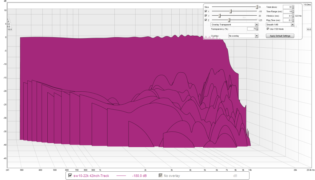

Your waterfall plot:
uses 3.1ms window and shows FR ripple. Ripple in FR equates to ripple in phase response.
Even single 3.5" full range driver shows itself not to be single source at higher frequency. When I correct a response of such driver to flat within 0.2dB at measurement position, and then move microphone a few millimeters, ripple becomes evident.
Even single tall and narrow ribbon as line array will show ripple.
All speakers are compromise, some are easy to live with, like yours.

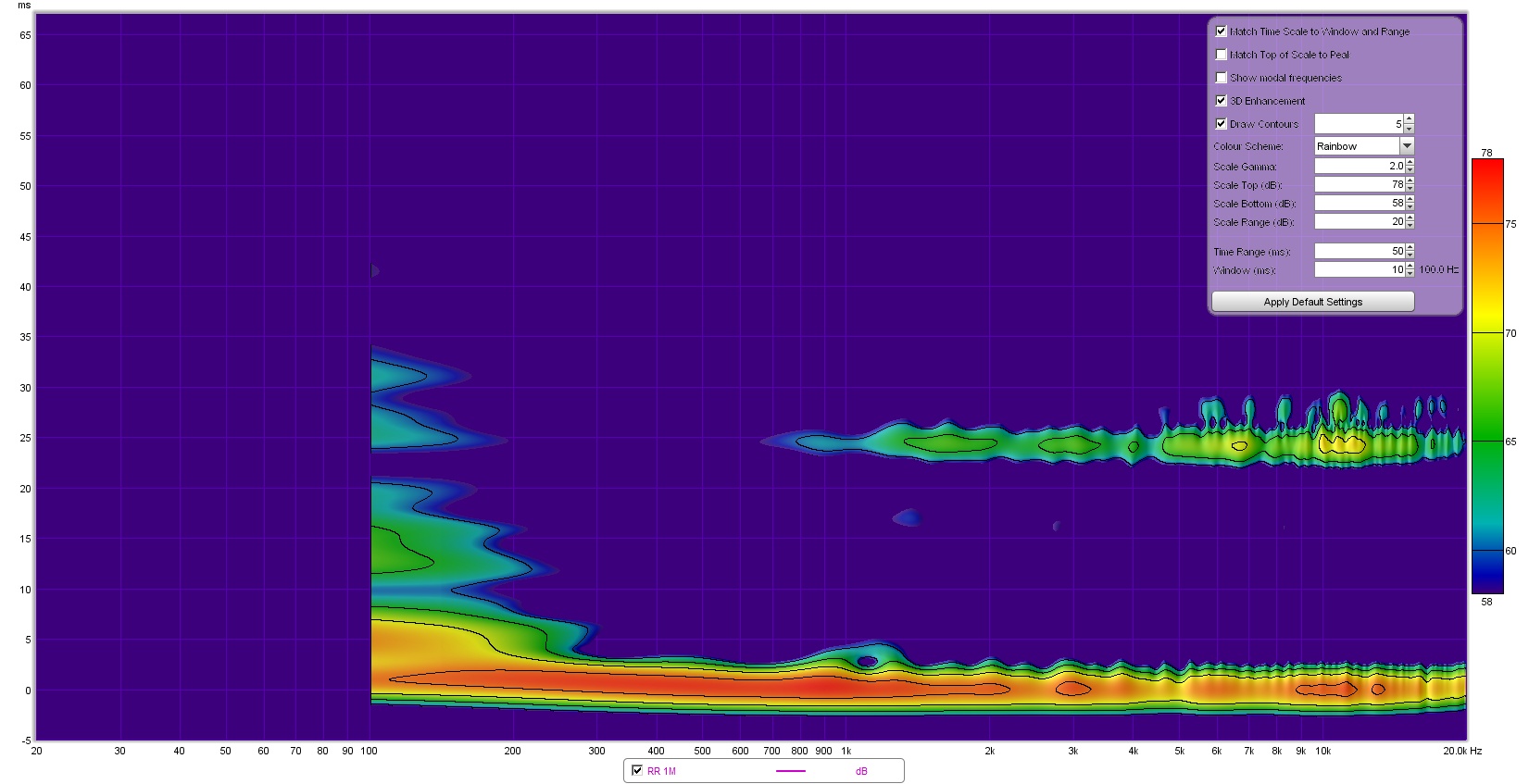

I've been playing with the DRC processing after I got an idea because of the comb filter I discussed a few posts ago.
To get a phase coherent solution I went out of the box in DRC to use bigger numbers than recommended to see if I could straighten out the phase. I discussed this earlier in the thread and showed a couple of beautiful step responses to show that case.
Last night I wondered about the straightening of the phase in the higher frequencies. As noted above the arrays have a time smear inherent in their design. If I try and correct that forcing it to be linear phase I could actually get worse upper frequency response. At least that's what I thought.
The EP window used up till now, 4 cycles at 20 Hz, about 2/3 cycles in mid frequencies gradually going to 9 cycles up top in a simulated waterfall looks like this:
But id I limit the EP window to 1600 Hz, making it full ~4 cycle to 20 Hz I get this simulated plot:
It's even a better improvement above 5000 Hz but as said before, I need to be proud of that first to actually show it.
In all the graphs I checked I see an improvement, in pré-ringing level, waterfall and FR response and the illusive phase wraps. I've listened to it today and it seems to make a worthwhile improvement. But I can only confirm it with new measurements. Usually the sims are quite good as a prediction to I have high hopes. It seems to have the biggest effect in the CSD plot at high frequencies, that was my goal.
