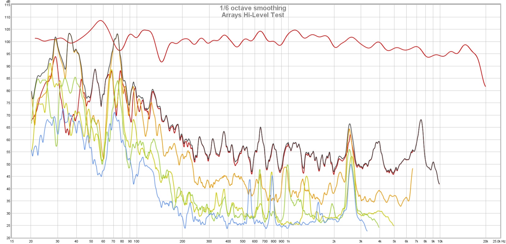

I once mentioned that I would test my arrays for excursion limits playback. Well, my 120 Watts amplifier does not have the balls to take it to excursion limits. So, I have attached a graph with as much high level sweep as my amplifier would allow. i.e. around 102 to 105 dB at 3m listening distance. (Please note that test is done at a single mic position. I would have got extra 6 dBs if I took the reading at 3.7m distance from the arrays but with a dip at 45Hz). The graph shows heavy distortion at 30-40Hz and 70-80Hz range; thats where I have two 4dB boost filters active. Again, most of this distortion may be due to my low- fi amplifier working up at the extreme of its limits.
Notice the low distortion at 20-30Hz. Thats 5 ports per array tuned at 20Hz
Distortion above 200Hz is still very low
You once advised me to be gentle with my arrays. I certainly won't abuse them but indeed I tortured a TPY03
The TPY03 takes abuse pretty well. At around 4.5 - 5 mm one way excursion levels, while playing music it gives a distinct flapping sound, most probably coming from the cone surrounds. This is where you would definitely turn off your arrays given the flapping sound warning. Well, I played the TPY03 at say around 7/8 mm excursion continuously for 3 bass boosted songs in a sequence. The drivers were making crazy loud flapping sounds now. This was supposed to be a destructive test where the cone flies out of the basket. But after 15 minutes of torture I gave up, partly due to pity and partly due to respect for the little black kevlar beauty. Its a tough driver, so should be the TC9. The only way to burn your arrays, I guess would be due to very intense clipping from an underpowered amplifier.
All I am saying is that your array does not only sound tough, it is tough
You have mentioned FIR taking out some dynamic from your arrays versus IIR. I haven't used FIR yet, but I myself noticed some difference before and after adding damping with just IIR. Underdamped room certainly gave a lots of extra
Anyways, thanks a lot. Your thread has been a lot of help in my journey of an awesome array as well. Have fun!!
