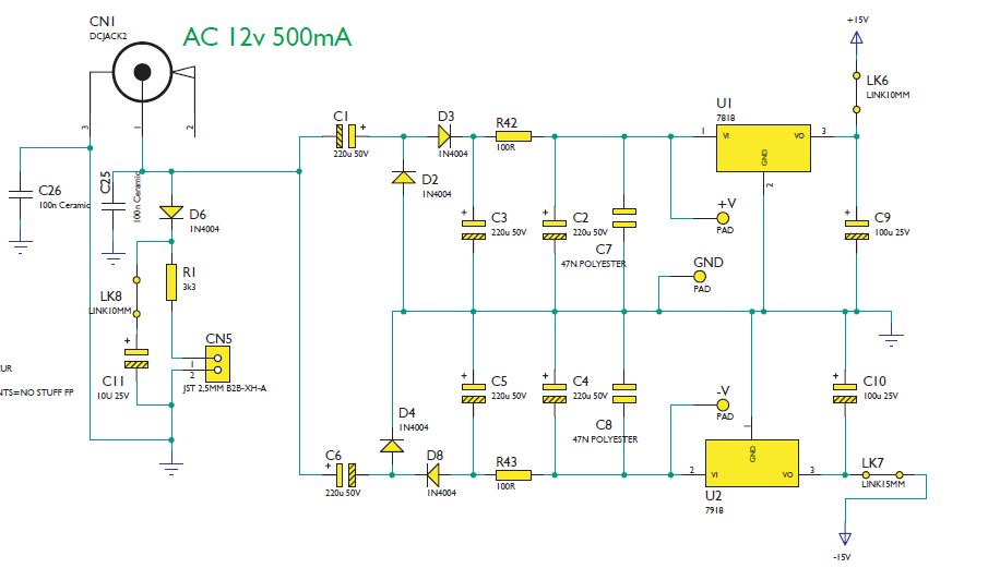

Usually I would use cheap wall-wart style AC transformer with half wave rectifier and LM7815/LM7915 regulators for +/- 15V rails. In my experience this proven to be simple, cheap and low noise.
However, requirement of phantom +48V makes things much more complex.
Basically I want to get internal +15V, -15V and +48V from single, standard and convenient wall wart style supply like 12V DC, 15V AC or 48V DC.
Boost converter from 15V to 48V? This potentially could introduce some imbalance to rails which isn't best thing with half wave rectifier.
With external +48V PSU it is straightforward to get phantom. But what about powering op amps? Maybe some kind of virtual earth rail-splitter? +/- 24V would be too high so voltages still need to be regulated. Single IC split-rail switching converters are expensive, complex and usually works only with low voltages like 5V.
It needs to be rather compact as I want to fit everything inside Hammond 1590BB. I don't want to make it overcomplicated, while keeping limited PCB space and low cost in mind.
I'd be grateful if anyone can suggest me some clever solution.

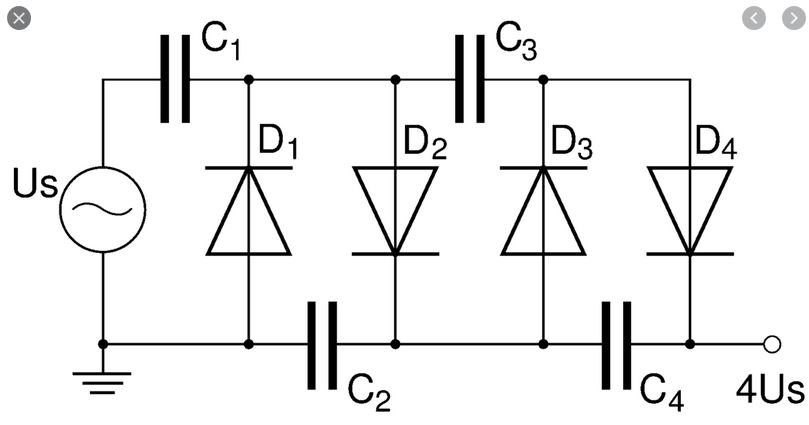

I f you looked at a Comercial PSU circuit for a mixer you will often find that the Phantom power is the output of a voltage doubler Such as this example.
soundcraft spirit folio SX Psu improvememnt
There are voltage doubler circuits for single AC supplies.
There are also dual rail supplies that run off a single AC supply. Maybe a combination of these could be a solution.
