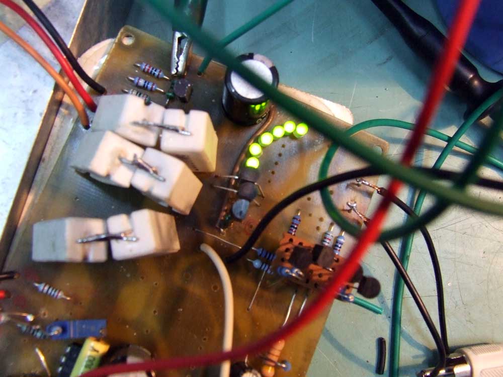

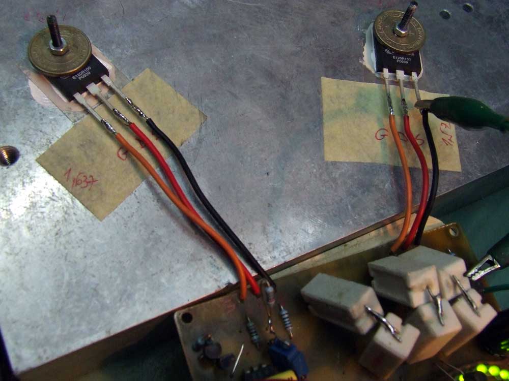

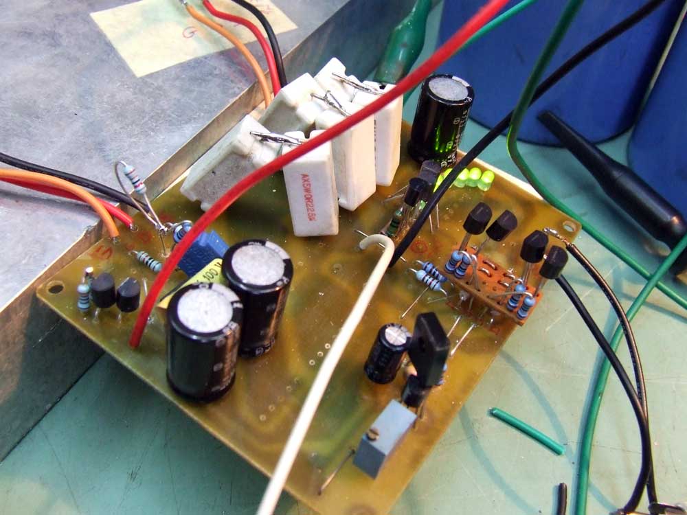

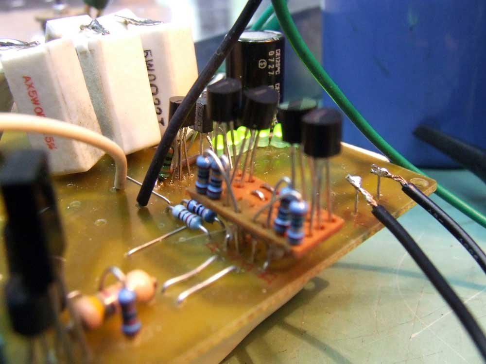

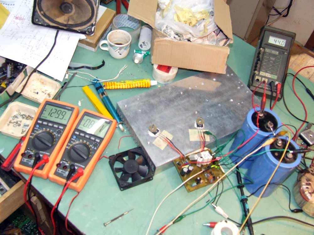

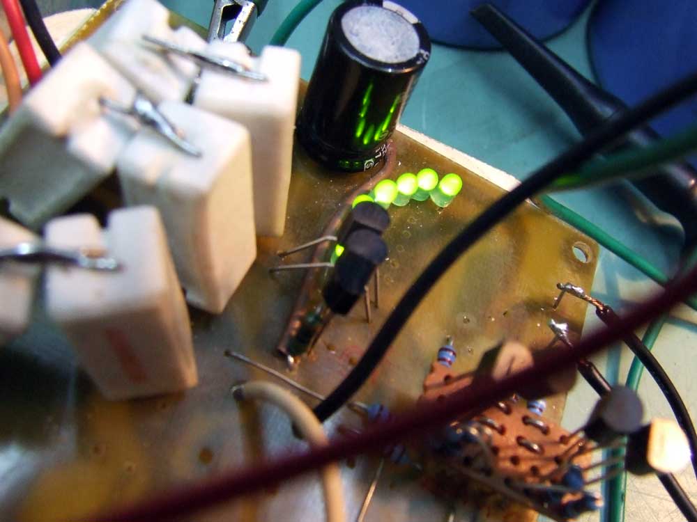

Hi Zhou ;
here are the pictures .... but no secret (
) schematic , at least until someone else breaks the ice
+/-22V PSU , Iq 1A85 , 13V4rms , 38Vpp , 8R dummy load .... means ~22W/8R
didn't take pics of scope screen .... I rushed to hear da tune
I fed it with mono signal , listening first on small bench "victim" speaker , then on my proper big one .......
it sounds simply gorgeous ...... I remember first tones from my Babelfish J ...... but this one is even sweeter
