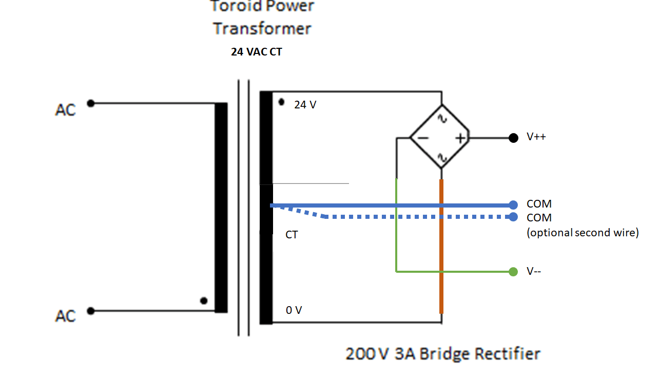

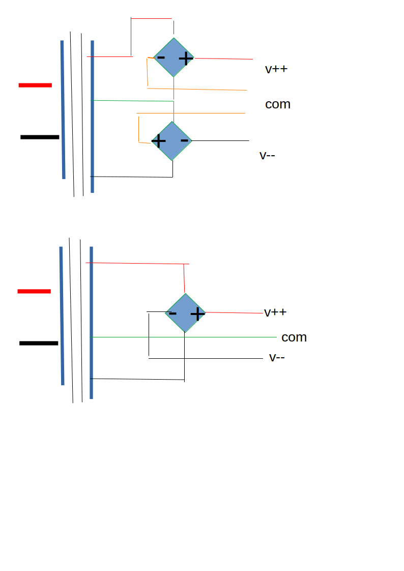

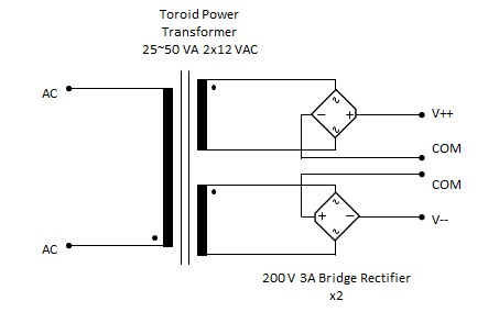

A little confused here. First of all my CT transformer only has a common center tap, not two. I am assuming that it is just the two tied together.
In the guide, the schematic for power supply shows the positive and negative poles of the rectifiers connected. In the spreadsheet, the schematic shows the two separate (positive and negative) poles of the rectifier go to the common on the phono board.
Since I only have a single center tap, I am confused as to how to connect this up. I have wired the rectifiers up to my transformer in the way I think is correct. The trouble is that the two poles of the rectifier that you show connected in the guide have a DC potential across them. It appears that they have the same potential as the two outputs, +18vdc, and -18vdc.
I think when I tried this initialls, there was some issue, and the transformer made a loud hum, and got very warm, hot even, so I shut it down and checked and rewired. Now there is no smoke, but I have not connected the two 'commons'.
Please help, I will try to post a drawing or schematic of what I have done.

Hi Roger,
If you have a center-tapped 24 VAC secondary, as opposed to dual 12 VAC, you must use a single bridge rectifier.
This is the standard, textbook connection (see attached image). The COM now connects back to the center tap. A second COM wire can be optionally used if it's more convenient (to have two twisted pairs rather than a 3 wire braid for example). My boards have two COM pads to make this redundant connection intuitive.
The double-bridge configuration is a more foolproof connection for beginners to deal with as the phase of the secondary windings isn't important. Just hook up each secondary to a bridge. Of course, you can connect the windings in series and use just one diode, but that involves correctly identifying which end of each winding is which phase ... and that's something that people are inevitably going to screw up. That's why I've generally avoided recommending this route.
I also found, in testing a long time ago, that the dual bridge configuration sounded better but I wouldn't swear to it and I'd probably use a single bridge if I was building one today.

Thanks Richard. I worked out the single bridge circuit last night but I have decided that the transformer I was going to use is too high voltage (+-18vac). I think the voltage regulators would not have an issue, but I have 12vdc relays, and another board that takes 12vdc that I want to power from this power supply, so I am ordering a single primary/dual secondary (12vac, 12vac) transformer. I will use the dual bridge diagram as this transformer has two separate output windings and four output leads.
