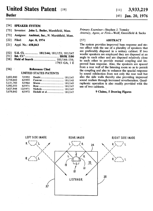

This is an experiment so I'm going to build it this way first. I can put it in different rooms to hear how it sounds.
If I have a specific need to keep it in my theater room than i can decide to make 3 seperate boxes.

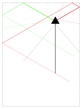

An equilateral triangle like that would be 30° from parallel with the side wall (or lack thereof), and 60° from parallel with front wall. or are these speakers supposed to be angled 45° toward each other? If the latter, I imagine it would be pretty much equivalent to something horizontally-omni. If straight ahead like shown below... beats me.
No, it's only one speaker in the middle.
Not a stereo pair.

I don't think you will get very good stereo from the speaker as it is planned now. See, the arrival time difference between the direct sound (L+R) and the rear signals (L and/or R) at the listening position is likely going to be too long. :nownow: There is a limit after which the precedence effect cannot be broken down anymore. It looks like you are stepping beyond that limit with this design.
It is likely that what will be heard is the sound at the center all the time, plus some additional 'reverberance', but there will not be stereo effect like that of panning in the stereo recordings.
At the end you may consider angling the side drivers at 45 degrees from the front, like Nagaoka did. Since horns are quite directive, it may be better to angle 45, instead of 90. I was using small drivers at the 90 degrees side, but they had wide directivity.
If you still want to try it as planned, I am looking forward for your listening impressions, of course 🙂
