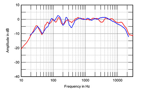

The effect is real. For example Stereoplay sometimes measures speakers in room.
Here are 2 two way speakers on stands. They are typical british monitors.
You can see the loss of energy and bumpyness between ca. 150Hz and 400Hz.
It amounts to ca. 5dB but it can be worce when you do not average.
