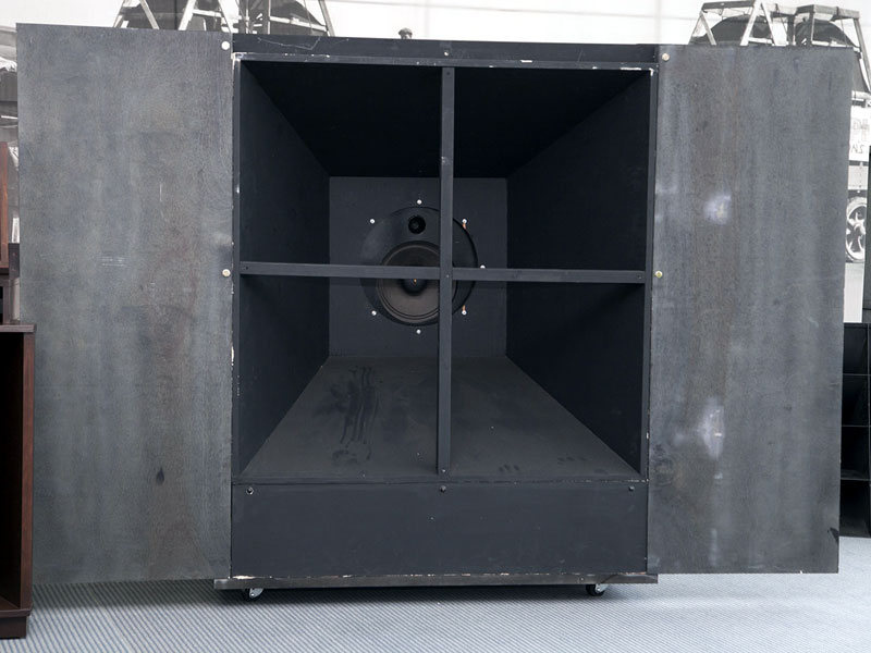

Personally, I think that the aim of the Horn - included to the AER Plexiglas Open Baffle you pictured us - is to enhance the efficiency (dB) of the Full-Range loudspeaker itself, and - possibly - adjust directivity and balance in the midrange-treble region.
But this horn has no - or little - contribution to the bass extension vs. a plane baffle, which is mainly determined by its size (in accordance to FC=C/2L), and partially compensated or enhanced by the placement of the system in the room, the choice of the listening position, and the geometry of the room itself.

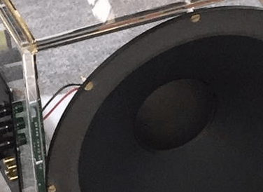

This is the first Sub way to use suspension construction in the market..
@vkung : what do you mean by suspension construction ? From here, I just see no more details than a transparent box, a 12" (or 15") speaker and an integrated sub module...

Ah OK - I see : Flat suspension... Like the 1st electrodynamic speaker from MM. Rice and Kellog (circa 1925), the material of the suspension was Chamoisine. Did you made the suspension by yourself - I mean : is it your DIY work ?

OK. Let's return to the initial formula :
F=C/2L ---> 2L=C/F
With C=340m/s and F=30Hz, we have :
2L=340/30=11.33m.
This means that to obtain a frequency cutoff for 30Hz, the smallest dimension L of the OB should be 5.66m, equivalent to a mere 11.33m minimum width for the OB...
I don't see how the little Horn curvation and speaker offset built in that AER OB - little in comparison : equivalent to 2mx2m according to Mr. Keller - could offer a natural FC at 30Hz instead of 170Hz calculated in my previous post.

It is AER's creation (Suspension SUB driver)
It took 40+ years for AER to do Research and Development for his drivers..

The driver model is not relevant - the physic law say that low-frequency cut-off of the OB is dictated by the OB width. Your 128 cm AER Excenter OB waveguide (not horn!) has low-cut frequency of 100 Hz - the same frequency for AER Excenter is quoted by the AER themselves: "Frequency response: 100 Hz – 70 kHz"!
Your smaller version of 65 cm OB waveguide (not horn!) has even higher low-cut frequency than 100 Hz.
Both AER Excenter speakers (65 and 128 cm OB) can not reproduce NATURAL tones of the double-bass or bass-guitar from E1 (41.2 HZ) to E2 (82.4 Hz) - that is one full octave missing from AER Excenter speakers! That is why AER demands using their subwoofer with the model Excenter all the time - you should obey to AER, shouldn't you?
