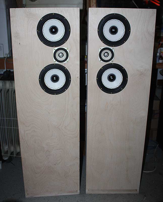

This concept is not new. A dome with a very large surround. A mechanical XO, so could be called a coax if one stretches the usual definition. Many have preceeded it. Nice to see this one, let's see some more. The Fried Egg tweter and the ubiqitous 24mm Audax dome and its clonesfor instance.
We started playing with 3” FR as midTweeters nearly a decade ago. It works really well. And some do not give up much of anything to really pricey tweeters.

![El166-MTM-front.jpg El166-MTM-front.jpg](https://www.diyaudio.com/community/data/attachments/1063/1063741-a46ec1836334bdd54924587359812664.jpg)
