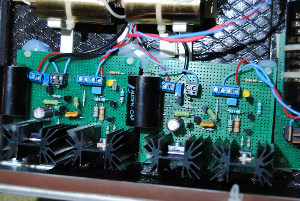

After majoring in the V1 version, I decided to experiment with the V1.2.
It took me a while because I was afraid it would be difficult to stabilize so I postponed the build.
Now I am sorry I waited for so long. I built two shunts p2p and had no instability issues. Every component is on the component side !
This shunt really benefits from screened sense wiring so this is mandatory.
It also seems prone to detect magnetic fields so a good tx orientation and screening helps.
The MKP in vref has a big influence in the overall resolution.
About the sonics..... this shunt belongs to another league.... Noise floor is lower, Trebble is much sweeter with much more detail so the stereo picture widens a lot, Bass is more articulated and reaches deeper so I can hear the differences between the bass notes with increased attack and decay.
I must wait a while until it settles so I can report correctly but it is a keeper as is

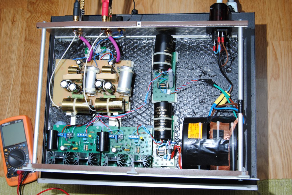

My build sonically jumped a german 7500€ riaa with ease. This german machine uses a uge batteries case connected to the riaa box with a 3cm diameter cable
The shunt is much faster and lower noise than the bateries implementation.
Now I am strugling to minimise hum from the two big toroids. Maybe I should build a ferric grounded wall around the TX.
The hum can be minimized if I pull the tx out of the case 15cm to to right or 20cm up but that is not practical.
If can't put in a separate box, only two solutions in the same box:
-R-Core Tx: Selectronic - France
-Sheet of permalloy Mu-Metal connected to ground covering all phono RIAA pcb's, you can buy here: Ultraperm MUMetal Shielding Sheet 0.15mm, 31.5cm x 19.5cm 80% nickel | Diy HiFi Supply

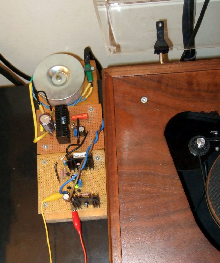

See post 2402 on previous page. Use only one led in Vref, use the MJE350 as shunt element (watch pin out), and remember to change the R6 220R gate stopper to a 10R base stopper. Also take out the 0.1uF cap from paralleling the output cap, it actually worsens the phase margin. Maybe you will need a larger value trimmer, or 100R-220R in series with it.
P.S. The schematic you posted is going to mislead you for Mosfets pin out in the positive branches. Use post 2402 as a guide. Where gate=base, drain=collector, source=emitter, for the shunt element substitution. MJE350 is opposite for a ready made board unfortunately, as is BD140. Look for D45H8 that will fit for pins a ready made board for GDS Mosfets.
