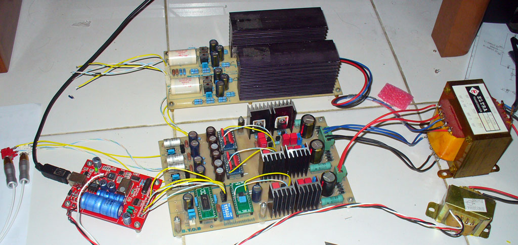

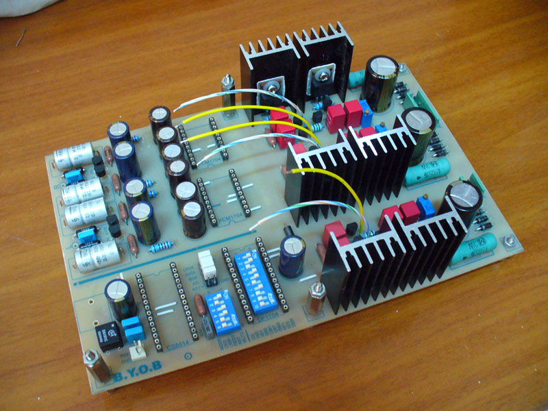

Ah, there is a successful V1.1 test also I forgot to tell you about. CRT tested it on his new DAC with Pass I/V from latest article.

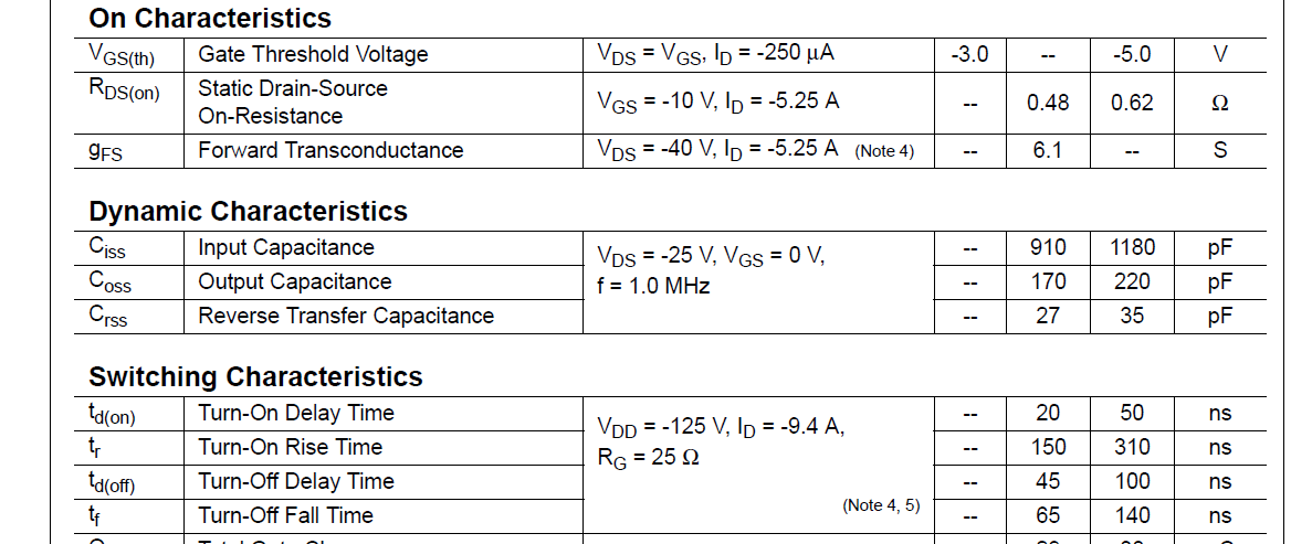

FQA12P20 (and FQA19N20C)?
I tried to use them for my DCB1, but the CCS didn't turn on on the +ve rail.

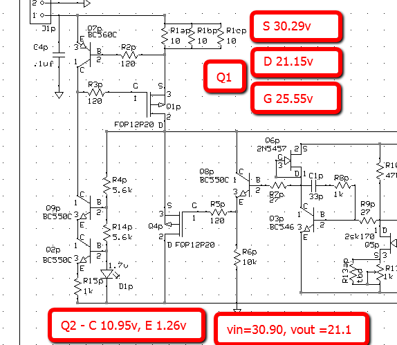

Ken, would you kindly make some measurement the CCS Vref, V across the FET etc?

Can you mark the schematic where you would like the measurements?

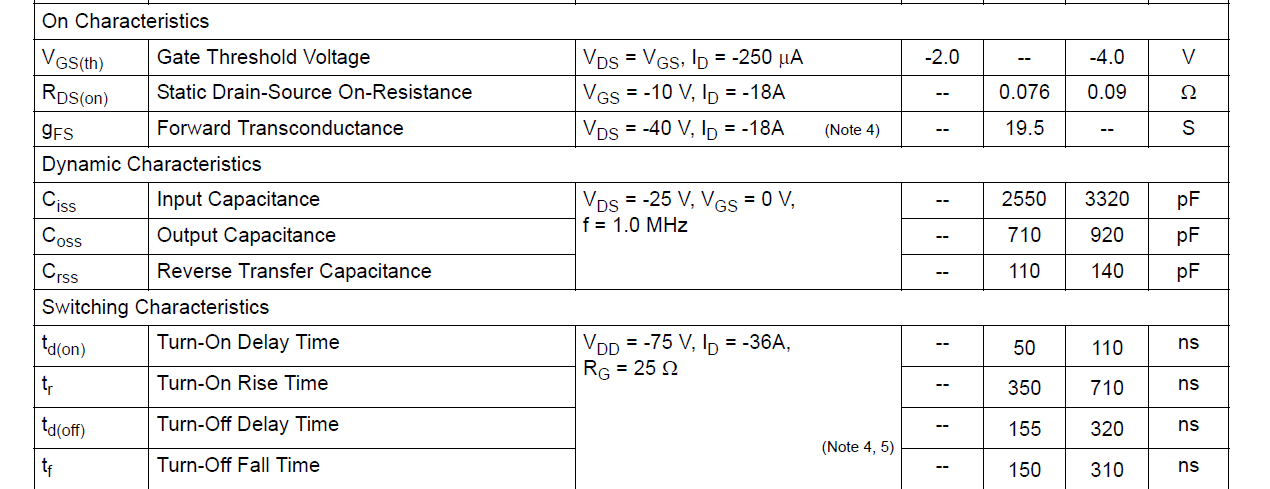

P.S. FQA28N15 gfs=20S typical at 16.5A! Does not have a gfs-id curve on its datasheet to see what gives in your working region, but if its analogous along the curve, its 3 times stronger than 9240. That, and Crss only 50pF its possible it drops the simulated output impedance of the reg 3 times also and is wider bandwidth as well.
Salas,
for the p channel, Fairchild has a mosfet with similar gfs but higher Crss 110pf, with similar speed - FQA36P15, or one with lower gfs, lower Crss and faster - FQA9P25. Which would you pick?

To have symmetric Zo as a reg the shunt Mosfets should have the same gfs. There is capacitive difference between sexes always. Would cut on gatestopper value to create the same frequency, if there were oscillations. But I haven't used such Mosfets. You say is steady. Is it DC line on AC scope setting? Can I see a scope screen?
Fred,
I measured a few voltages, things are pretty tight and I didn't want to short anything, so, not a lot of measurements. If there are some specific spots, tell me which one and I will give it a second try.
Ken
I know the schematic says FQP12P20, but, I used a FQA9p25... data sheet for the device shows Vgs of 5.75 at 200ma. If I'm reading the data sheet for the FQA9P25 correctly, the Id at 9 volts of Vds is only 100ma compared to 3A for the 9240.

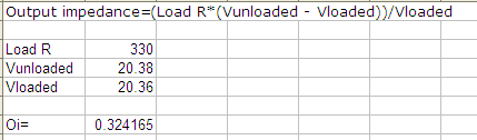

Given the variables of different Mosfets, is there a way to measure the impedance of the shunt?
I measured the loaded and unloaded voltage and here is what I got. The measurement tolarance that effects the outcome the most is the voltage. If I reduce the unloaded voltage by .01v, it halves the result.
