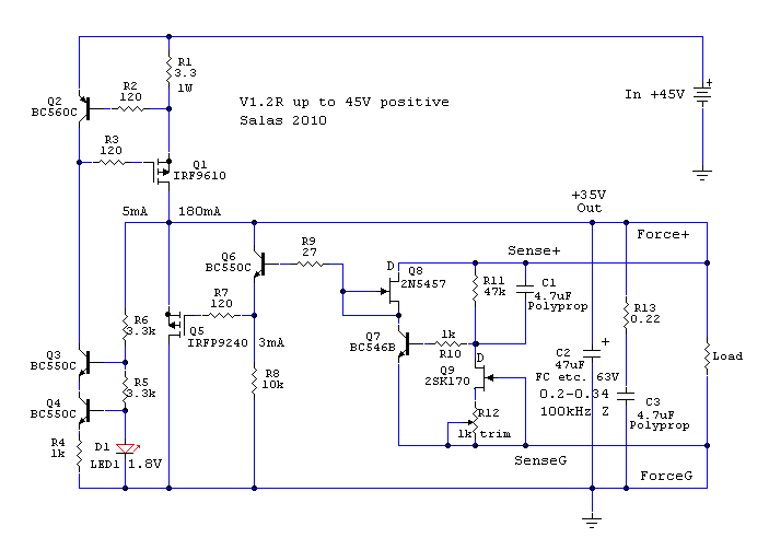

I went back into the simulation and looked at some of the heat dissipation issues and realized that I have been underestimating just how hot this thing will get. So, several of my concerns were unfounded. For example at this voltage with 100ma load and 200ma current, the shunt mosfet makes over 14w of heat. And my 1k load resistor makes 3.6w of heat. I'm going to take it back to 130ma of current by changing the 3.3 ohm to 5 ohm and see if that doesn't solve some of voltage rise issues.
Ken
Did you oscope it also? At such Vout, yes be conservative. Run 30-50mA on top of max consumption only.

If it will be a straight DC line on the oscope's AC input setting at your power levels and with your FQPs, you must concentrate on heat I would guess. But try run it as an R also if there are oscillations, maybe the layout will react better on the more resiliently terminated R.
Oscope, no oscillation! With the R1 at 5ohm, a bit less temp, but still have rising output voltage.Did you oscope it also? At such Vout, yes be conservative. Run 30-50mA on top of max consumption only.
Q3 the BC546 the Vbe voltage rises and Q4 the Vgs falls, both at what appears to be a similar rate mV/sec as the Vout. The K170 is a BL and I didn't measure the IDSS.Does Vbe of BC546 error amp and Vgs of shunt Mosfet change a little during rising? Does rise stop at a point? Is your K170 GR, BL? do you remember its IDSS? I ask because I have an idea to test.
The K170's current is governed by Vbe which is its only voltage VDS, and the trimmer. If Vbe rises incrementally, the current in the fet will rise too and it will be translated in more ref voltage. I propose a test. You short the trimmer, sub a 10k 1W ref resistor for the one connected to K170's drain. So we get its max current possible under Vbe potential and smaller percentage change of it. Also BL pinch off and transfer curves show it will run in more agreeable tempco area if near max since its hot there. You don't know its max current now under Vbe, but with the 10K it will show and you will fix it to 60Vout by tweaking Rd Kohm from there. Lets see if it will be less jumpy.

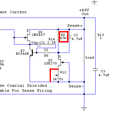

Salas,
To make sure I have it right, the Rd you refer to is R8 in the schematic shown, and I've shown a jumper to represent shorting the trimmer - basically taking the source of the K170 to ground. Do I have this right?
Ken
So I can use this schematics with Vin +7V Vout: Vin 52V?
Wil be enough a trimmer 5K instead 1K?
Salas,
Ken
Yes.
Use a 500R trimmer since it will use the lower range around 200R to run about 1mA on the 47k. You could use the 5k if it has enough turns low to find the rough value after drift settles, and then substitute a resistor, its steadier and more reliable.
