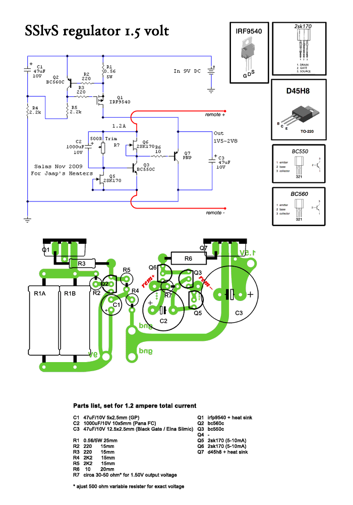

A v1.0 (or v1.1 when ready) with a BJT as shunt device (MJE 340 + base stopper = 10 ohms) should work, shouldn't it Salas?
The problem is to replace the tiny smt Trident pcb with a much bigger one.
Vbe+Vpx2 upwards. 1.5-2Vo heavily with low Vp Jfet as error amp bjt load. Has been done for no26 heaters at 1.5V.

I think I spotted a mistake in the PDF. The BOM states Q104,204 and 304 not only as 550 - 560, but as 117 also.

Also I have spare 9520 and 9540. Could I use them instead of 9530?
The BJT for Q106 are only recommended for the low voltage one?

Soon, I am finishing something with Crt. Any other mistake spotted? So to change and upload again. Don't change Mosfets if you can. Will work but a bit ''slower'' than tuned. The BJT can span from low to high. Gives narrower OLG and much higher Zo, but its interestingly open supersonic Zo due to lower capacitance. Its a VAS grade one, popular in modern power amps.
No, only in low. Gives 12x the Mosfet's Zo value in this design. But its flat Zo in band also, and open above, so its interesting. Beyond those extra 2 Qnumbers I have to wipe, did you find the guide would make you understand correctly? It was very difficult to write the least possible for something so configurable and wide application. *15031 in positive regs.

Not a mistake, but I dare say you could also list MJE15028 as equivalent to NPN MJE15030 and MJE15029 as equivalent to PNP MJE15031. Only Vceo is different (120V vs. 150V) That's plenty for this application.Any other mistake spotted?
