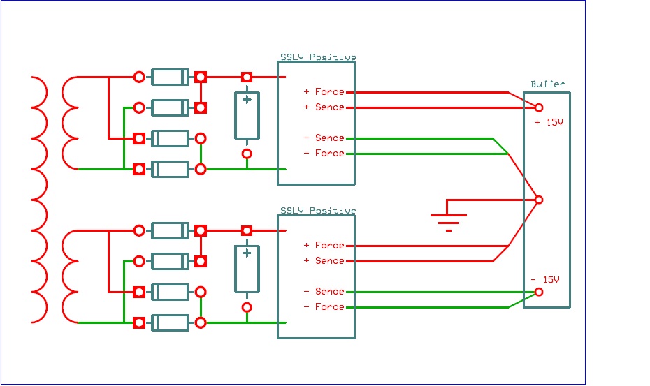

Do you also recommend the use of two positive Salas regs if we use separated secondary windings in the TX ?
If you used the schematic like I posted you would not need separated transformer windings. The CCS is only seen as another load by the regulator, it shouldn't matter much, if that is the only change - however I would like corroboration with Salas on this.

Hi keantoken
Would you please point me to your schematic ?

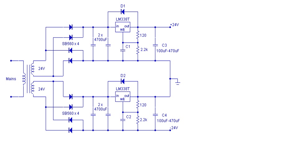

I am planning to build a line stage preamp (pot + buffer) powered by two positive SSLV V1 that I have already built.
I also have a two winding TX so I would like to do something like this but using SSLV instead of the 338 regs:

Hi keantoken
Salas
Can I do it ?
Here is my schematic:

you have swapped -ve & +ve relative to my comments and my previous posts.... I read your post " even those that design and build discrete regulators sometimes use two positive regulators rather than design a + & - pair.
The only down side to this twin positive regulator is the requirement for dual secondaries and dual bridge rectifiers.
Most will accept the extra cost because of the technical benefit accruing from +ve regulators."
None of the 50 or so transfomers I have bought in the last few decades were centre tapped. All were dual secondary.
The only extra cost to using dual -ve Salas Shunt regulators is one bridge rectifier. All else are either the same or cheaper.

Thank you keantoken
Now I understand ... You are suggesting a positive + negative shunt to use with a single secondary TX.
Maybe I need to try that also, but I have two V1 positive already built and a twin secondary TX.
In the bench, the two +15v shunts already produce -15v ~ +15v acording to plan.... let us see if it works when I replace the dummy load by the actual buffers
