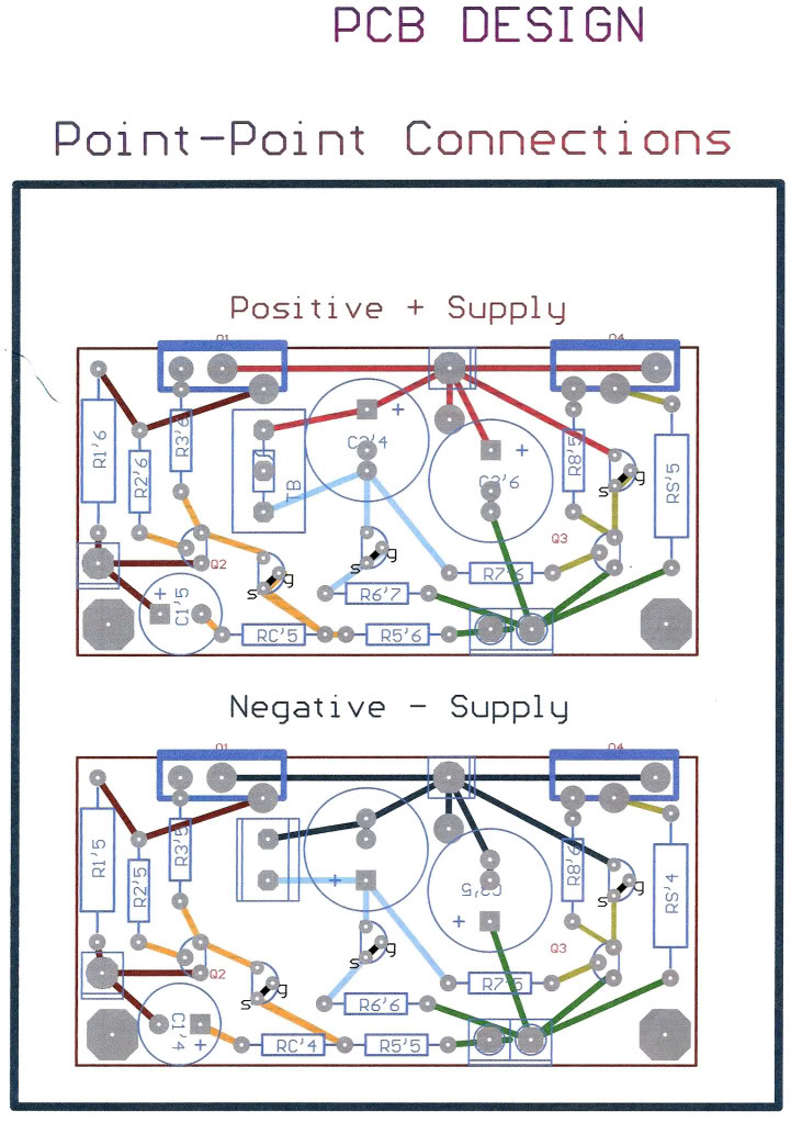

Liliya:
Here's what you asked from the original James print for your application:
R1=1R 3W
R2=120R
R3=120R
RC=27R
RS=0.1R 2W
R5=1K
R6=wire jumper
R7=27R
R8=120R
C1=47uF polar 25V
C2=470uF polar 25V high quality
C3=220uF polar 25V high quality
Q1=IRFP9240
Q2=BC560C
Q3=BC550C
Q4=IRFP9240
J1,J2,J3=K170BL (J1=weakest IDSS in your stash)
Vref connector (above j1)= Don't use a Zener, bad region for noise in your voltage. Try resistors 1-2k until you hit 9VDC out.

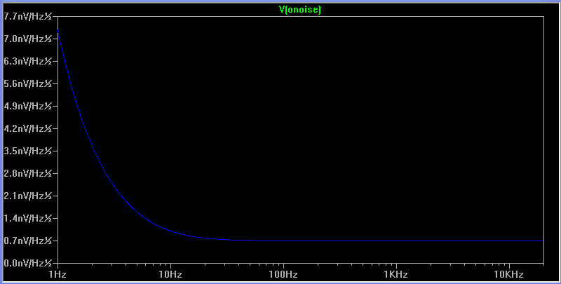

Regarding regulator noise...
Can somebody who has simulated the Reflektor post an output noise spectral density graph for a 5V version (nV/sqrt(Hz) and frequency between 10Hz-100KHz).
Hope its not that complicated.
You can do this with FFT-free ware and a low noise preamp. Some have built Pete Millett's design: Soundcard Interface
I use the one which Walt Jung designed, substituting SSM2019 for the now obsolete SSM2017. Services This preamp's noise floor is about 0.9 nV/Rt Hz.
That one is with 2200uF Vref cap. Better for clock.
