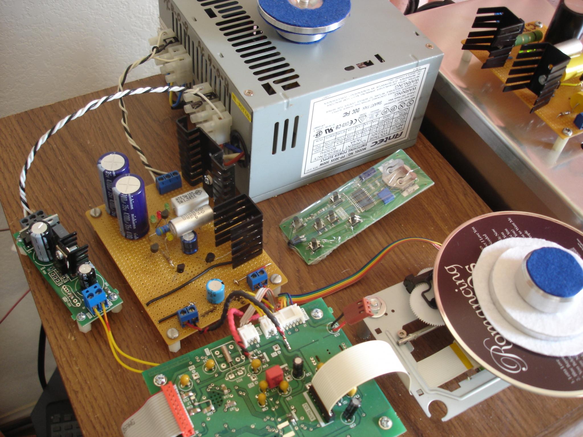

Just got my second wire-2-wire Bib up and running, this one is to power the digital 5V section of the new Shigaclone. It works great. Picture attached.
Is there a version of the reflector for 5V somewhere in this long thread? I searched but failed to find one. Do you mind to point me to the right direction?
I am curious to compare the Bib and the Reflector.

Looking good Fred, congratulations! For Reflektor very low voltage make a search for member's Kazuo Ozawa posts. He had shown practical builds and values for 5V and below. He had tested Logic Level Mosfets results that allow it working such low as I had suggested. Interesting comments about semis types and Zobel termination values there too.
