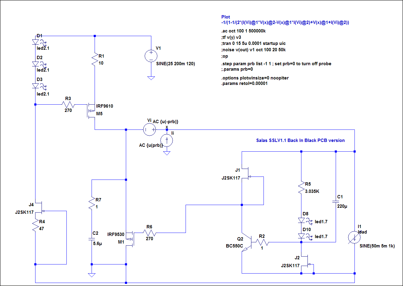

I would like an LTSpice spice circuit for the SSLV 1.1 BIB positive mosfet regulator? I searched but did not find one, but this is a very large thread.
Jim
You got to construct it from this picture because as a file has no script models, refers to my hard disk libraries. *The K117s are GR for IDSS. **The open loop analysis setup for which the virtual sources correct positions and plot function I include in the pic is based on Michael Tian's and colleagues paper. You may Google it.

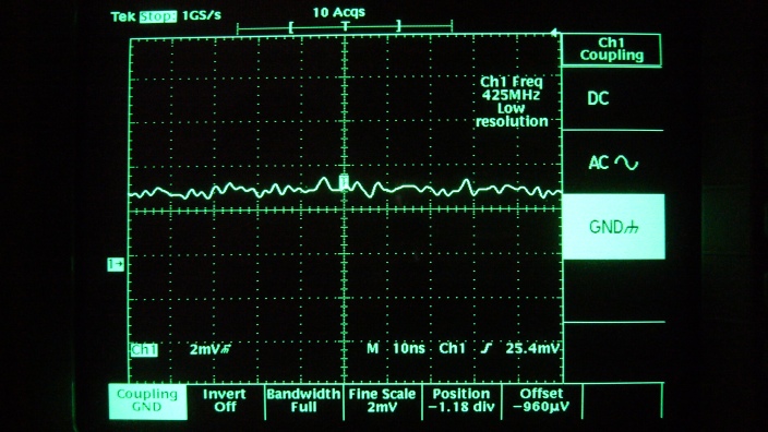

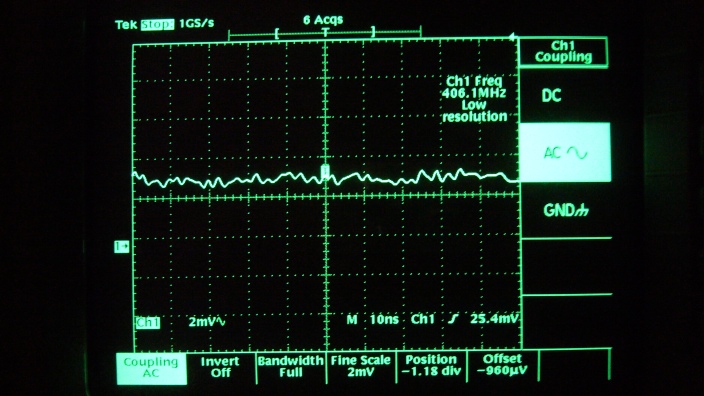

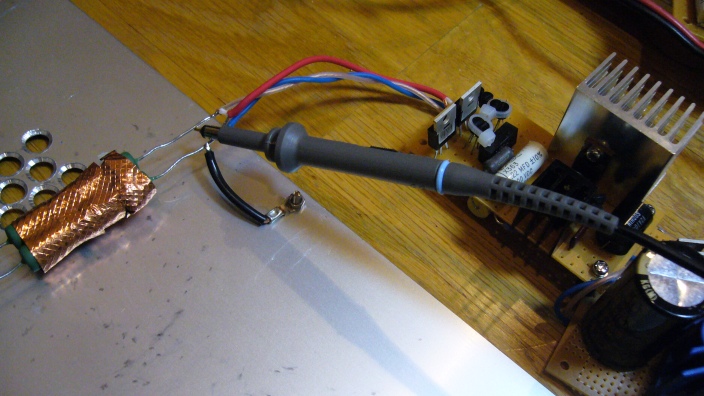

Can you take a scope picture of its output on dummy load resistor for nominal WaveIO current at 10nS/2mV div and shortest probe ground fixture possible? I want to observe something, thanks.
Here is results.
Sorry, I do not understand how to measure in low noise environment.
Load is 13.6ohm with copper foil, and aluminium boad on floor.
Probe is putting on close to terminals as possible. Probe is set on X10. So the vertical axis is read in 10 times.
First photo shows output of Reflektor running. Second is GND noise.

Hi Kazuo
Better set the probe at 1X and turn the Tek TDS scope's 20MHZ bandwidth limit "ON".
