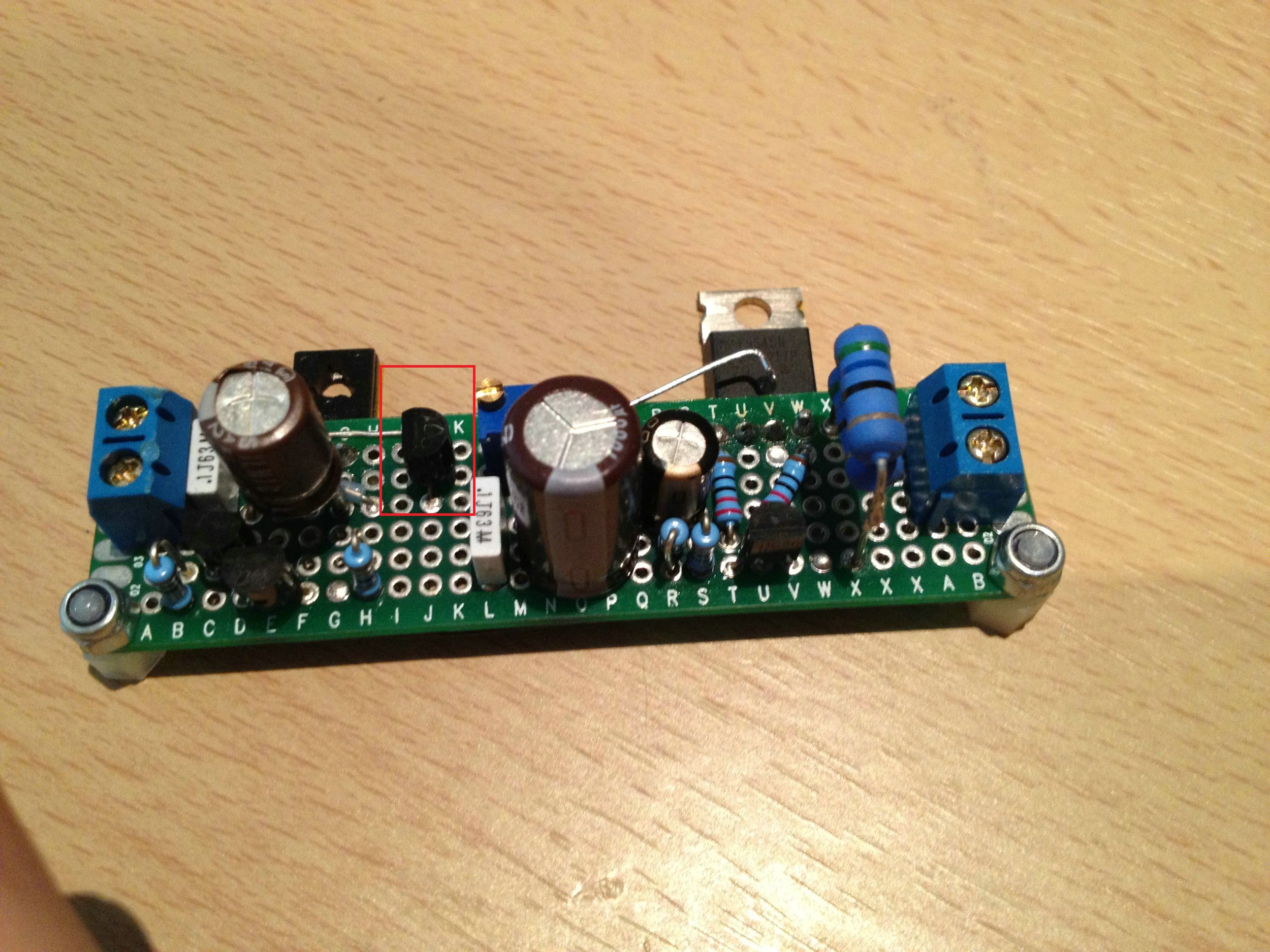

it's actually Q5 (with red).
BD140 is connected in accordance to the circuit above and pinout here.
I've already finished 4 working regs. This one is definitely has something wrong in the left part. Most likely some stupid mistake of mine. The layout was taken from Red Baron thread.

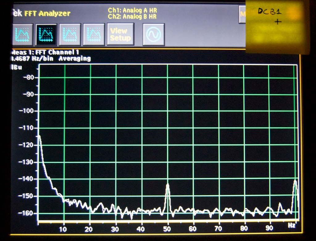

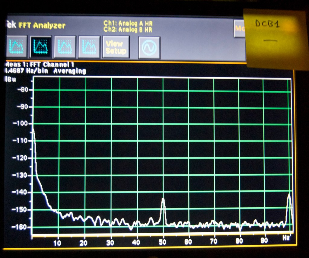

Only a DCB1 power section on an analyzer for 1/f up to 100Hz by a Spanish member. No personal lab analyzer gear available. Those are from a Mezmerize with 100uF Vref cap. Noise density I had shown only by sim unfortunately. #4221 & 4123
