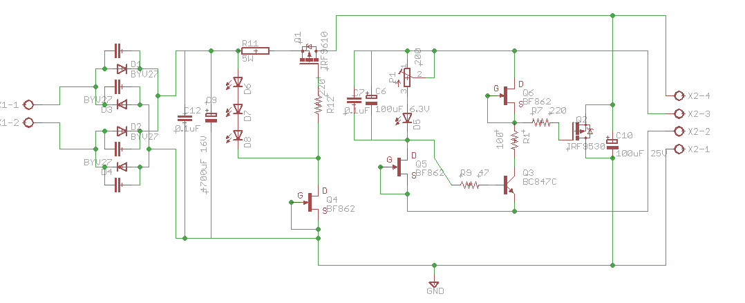

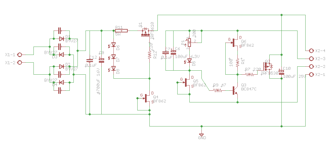

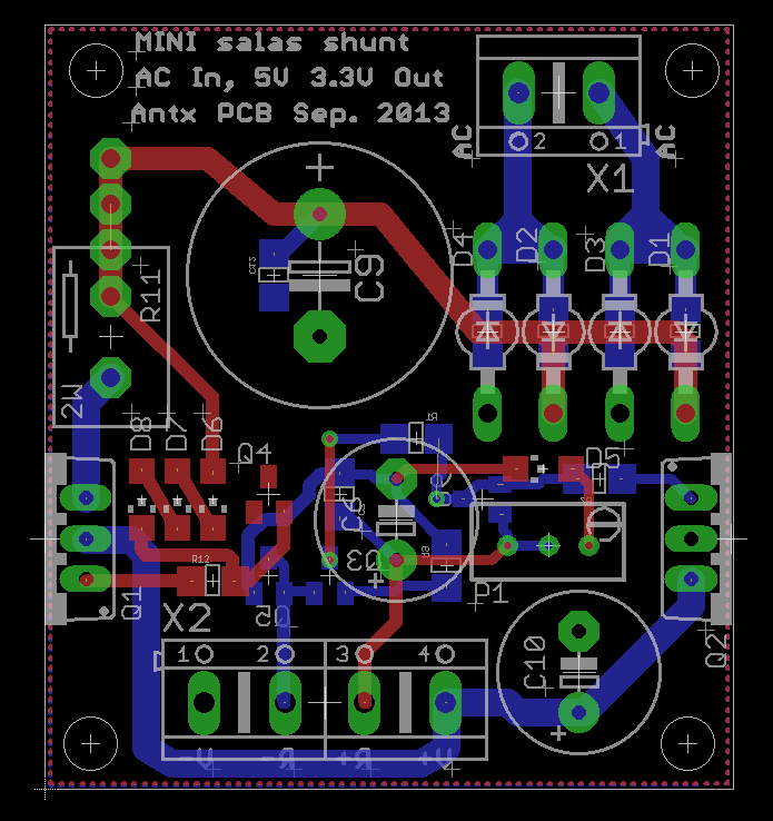

Now I have added 100ohm resistor in the Rs place. Please also check my PCB if anyone sees any improvement of it.
BR,
Ales

-It does not "need" to be cleaned with a pre-filter. But it can be beneficial. It can be an active solution like a capacitance multiplier or passive as a CLC or CRC.
-As big as your main filter cap for not using high resistance in the L or R element would be better. Dropping 2-5V over such resistance should be pre-calculated in the Tx secondary rating regarding the CCS setting to be used so to keep a 10V drop across the reg. 7V at least.

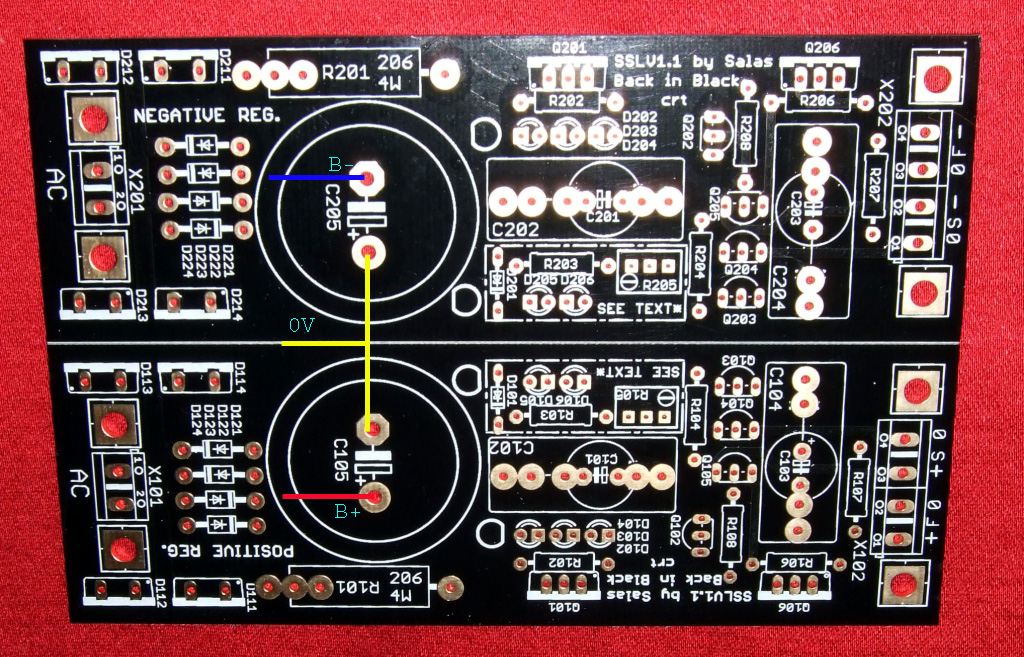

I have a phono stage here with a PS that splits between -24V and +24V for each channel. I would like to use your regs (-/+) fed with a 36V battery in the place of this mains PS. However, the plus and minus lines going into the phono stage share the same return, namely, the umbilical cord between the PS and the phono stage consists of one wire for the +, one wire for the -, and one wire for the return or ground. Would that be OK with your regulators or must the channels be completely independent?
diyAudio Chief Moderator
Joined 2002
That will be OK since there are no rectifier bridge diodes anymore. You should link the positive side's 0 to negative side's 0 between the now unused main capacitors pad's - & + between positive and negative boards respectively. Midway that link will be your incoming 0 connection point. You could still use main capacitors as bypasses to the battery feed on the other hand, but the no diodes & link things remain.
