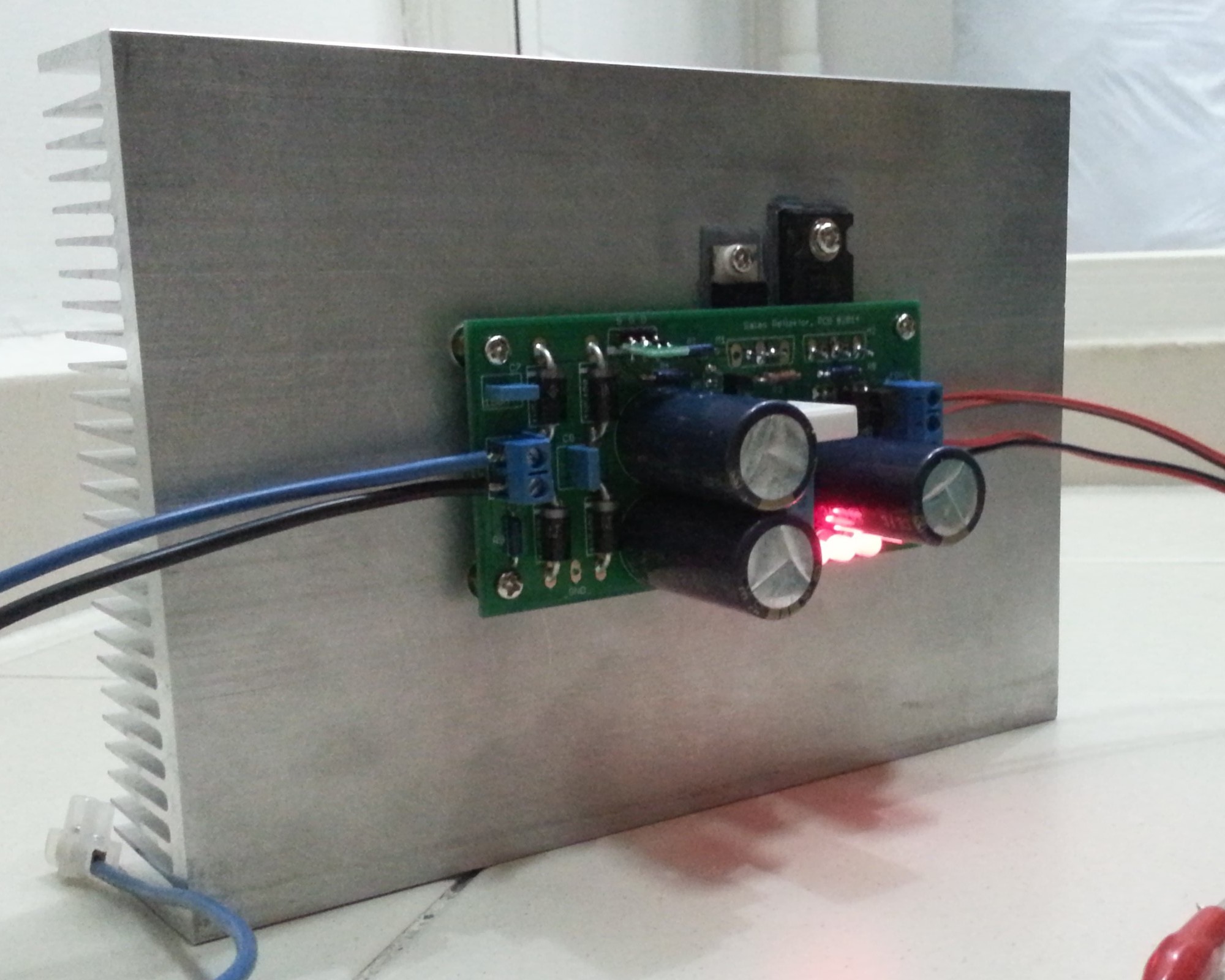

Playing around a Reflektor-D proto these days. Its a configuration idea focused on being handy for powering digital circuits.
To can run 300mA, 400mA, 500mA, 600mA CCS with standard predetermined Rset values using board-level sinks. In combination with proper off-loading by the client circuit's draw of course.
For 3.3V, (3.6V), 5.0V, (7.0V) by combining LEDS mainly. With same parts beyond the CCS and Vref setting ones.
Good stuff I see for now: Steady Vo after very little negative drift from cold to hot only 0.05V, zero overshoot on/off behavior (essential not to kill DAC chips etc.).
Easy to build. No rectification ripple, EMI, or self oscillation appearing on the output over a 200MHZ bandwidth. 20MHZ wide-band noise same as the scope's self limit.
Accepts AC when hosting bridge diodes and a main capacitor filter, or accepts raw DC to a connector and decoupling where the main capacitor would otherwise be.
Proto build and spare board

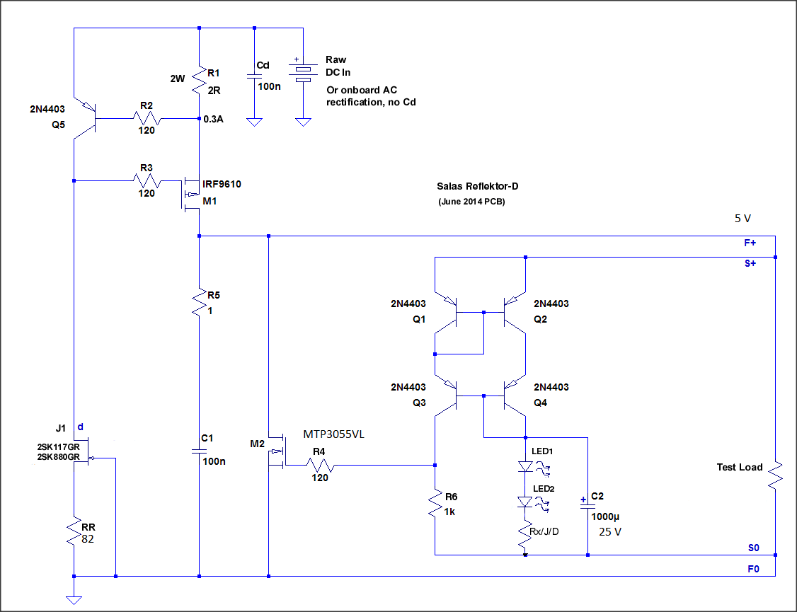

Very interesting. What are the changes in the schematic?
Its the regular Reflektor-D we recently discussed. Working on proper configuration testing.

Very nice boards!!!
Is there any difference between using leds or rf diodes on the Vref?
What would be the price for one board?
Different impedance, usually more. About noise they are good. Maybe there will be a diode also in one of the settings (3.6V).
Somewhere in the neighborhood of SSHV2 I guess. Its bigger like 128x54x2mm in matte black. Verification of settings and temperatures with parts likely from Mouser & Digikey are to be finalized now so to write a small build guide on predictable stuff. Trying to can include it in the (belated) general GB iteration people have been asking for a couple of months now.

Did not find the schematic.... can you help please ?
I have got my hand on some k117 with idss between 3.6-6ma.
What idss should i use for the jfet on the ccs side? Same issue for the jfets paralleling the current mirror.
4-5.5mA for 82 Ohm RR
What do you mean JFETs around the current mirror? There are only BJTs there. Low noise PNPs. Use medium to high HFE 10% tolerance.
That is the one that will be in the guide. (The board details and instructions finishing very soon).
