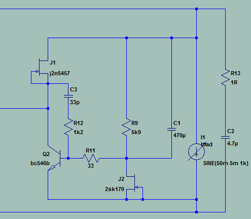

I am revisiting the V12R shunt because I do know it's potential and would like to push it a little further.
The initial schematic is below and I would like to drop C2 (47uF EL).
I know the BiB and the folded shunt can both work perfectly without that output EL.
The différences I see are related with the resistor value in the output zobel that in the BiB is 1.2ohm and in the V12R is 0.22 ohm.
Can I take the V12R schematic, drop the output EL and raise the zobel resistor to 1.2ohm and expect it to work without oscilations ?
Do you realise that Vp of Q9 should be less than 50% of Vbe of Q7.
That would require R12 to be VERY low and for Idss of Q9 to be selected from the low end of gr grade sk170.
Reducing Id of a bl grade sk170 by using a high value for VR12 is not a good way of getting good performance from that transistor.
If trimming to a preferred voltage is required, then the VR could be moved to be in series with R11.
Its an old schematic based on certain characteristics of stashed samples that worked in a prototype. Due substitutions of types can be made but it takes practical work to confirm good working order and stability. Using a VR "upstairs" its a correct idea, I had confirmed it was OK combined with low side K117GR too in another proto. But keep R11 high value enough for C1 ro remain effective in LF. Vp must not be more than 100% of Q7 Vbe actually since its a minus Vp. So to confirm to the no less VDS than double the Vp criterion.

Ok, I will move VR12 up and also put a led in series with it as you use on the folded.
As for Q9 Vp < 50% Q7 Vbe maybe I could raise this Vbe up by using a diode as emitter for Q7 ?

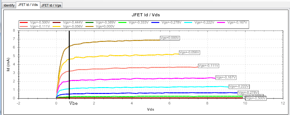

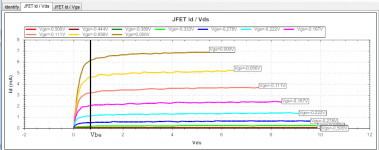

This is a -0.47V pinch off K170BL example I just traced out. Although even straighter later, it looks usable above Vbe=Vds. Its Ohmic region already gives way to the saturation region when under Vbe voltage only in other words.

I tried the experiment for that same -0.47V Vp K170BL. A jumper between G & S. A variable PSU for VDS. The thick red lead in the picture goes to a Fluke 87V in series mA DC mode for better readings than the PSU's at this difficult for its resolution region.
VDS / Id
10V 7.20mA
4.0V 6.93mA
1.0V 6.39mA (at about 2*Vp)
0.7V 6.17mA (at about Vbe)
0.5V 5.83mA (at about 1*Vp)
0.3V 4.84mA
So 9.6% current fall between 2*Vp and 1*Vp at Vgs=0
